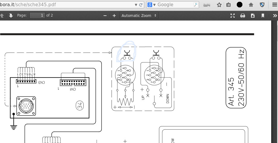

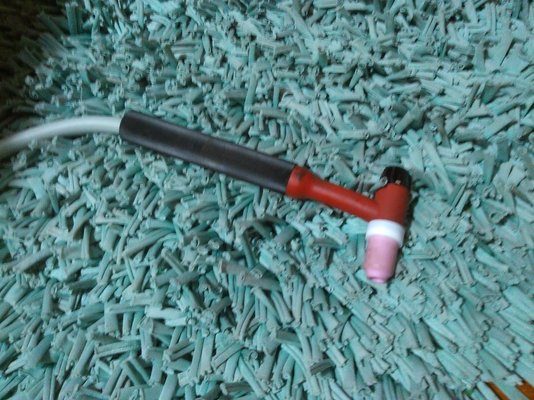

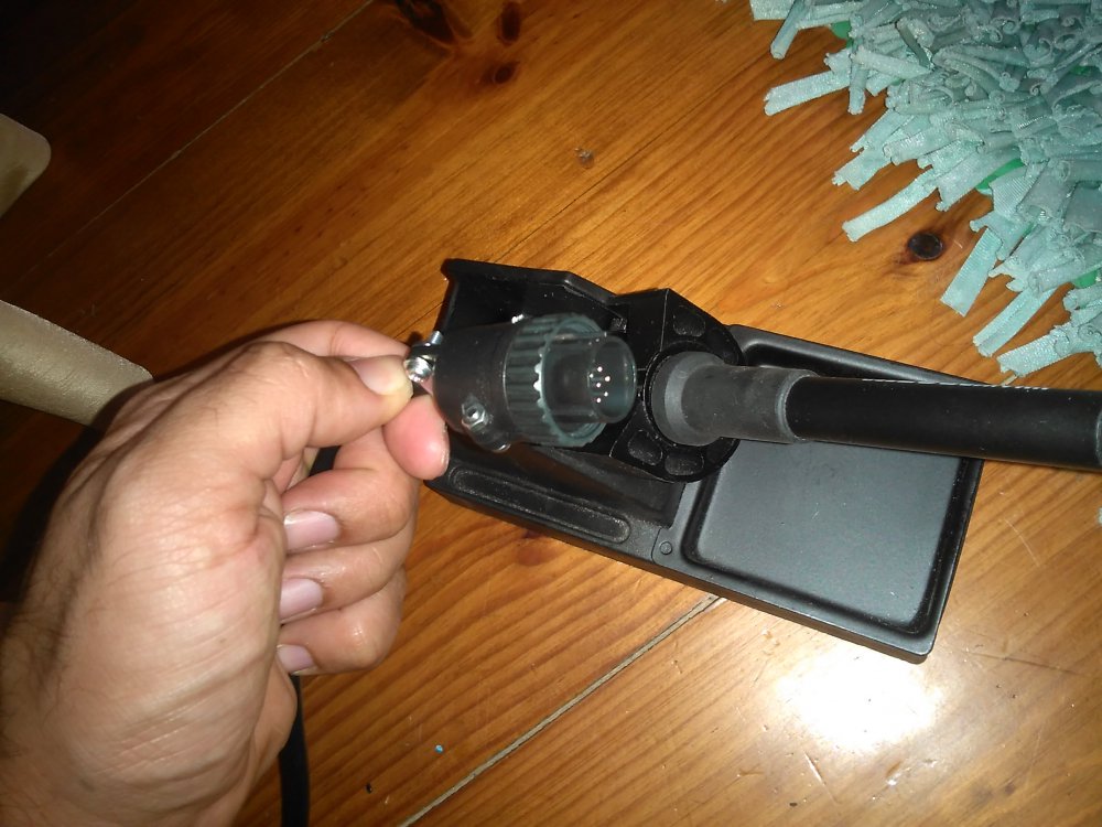

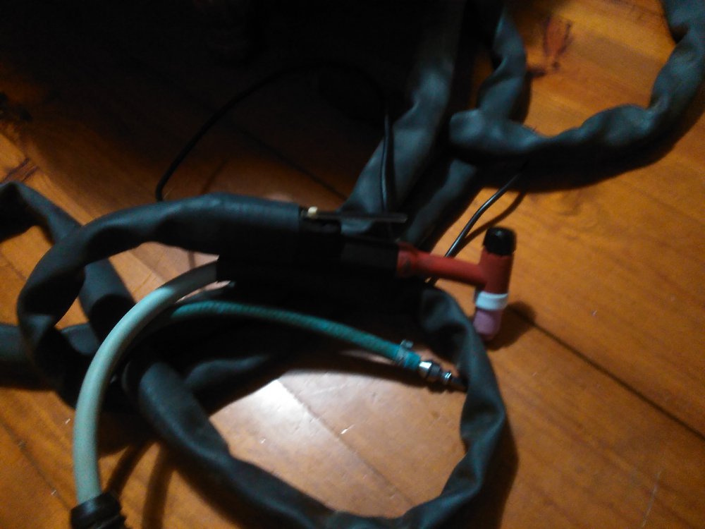

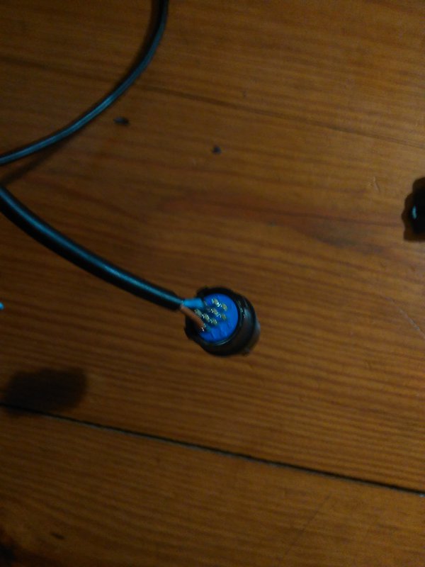

Hi everyone. An old friend who does all my machinist jobs (and I do his welding ones) has a cebora tig (tig sound 1530 ac dc) that he bought new quite a few years ago as a stick welder (mislead by the seller) and he only used it as one of course. Since it was sold like that it didn't come with a tig torch. Lately I've been welding quite a few things for hi in stainless (filling shafts to be machined amongst other things). Well I'm tired of dragging my tig to there so I thought putting his little cebora to work (he thought it was a great idea and will pay me the same as long as I provide the gas and so on as before) I've a spare torch that I fitted a switch tonight to use with his welder. Also ordered a plug from the oficial cebora dealer here but they weren't helpful telling which pins to connect... Anyway the plug should be here tomorrow and I've a little doubt about the two pins that I've to wire to the switch mainly because in the wiring diagram that I saw on cebora website they use a symbol that I've never seen used to represent a switch.
I think that I need to connect the pins 1 and 9 but someone more electrically inclined probably can help to be sure, I've atacched a picture of the wiring diagram. Thanks :-).
