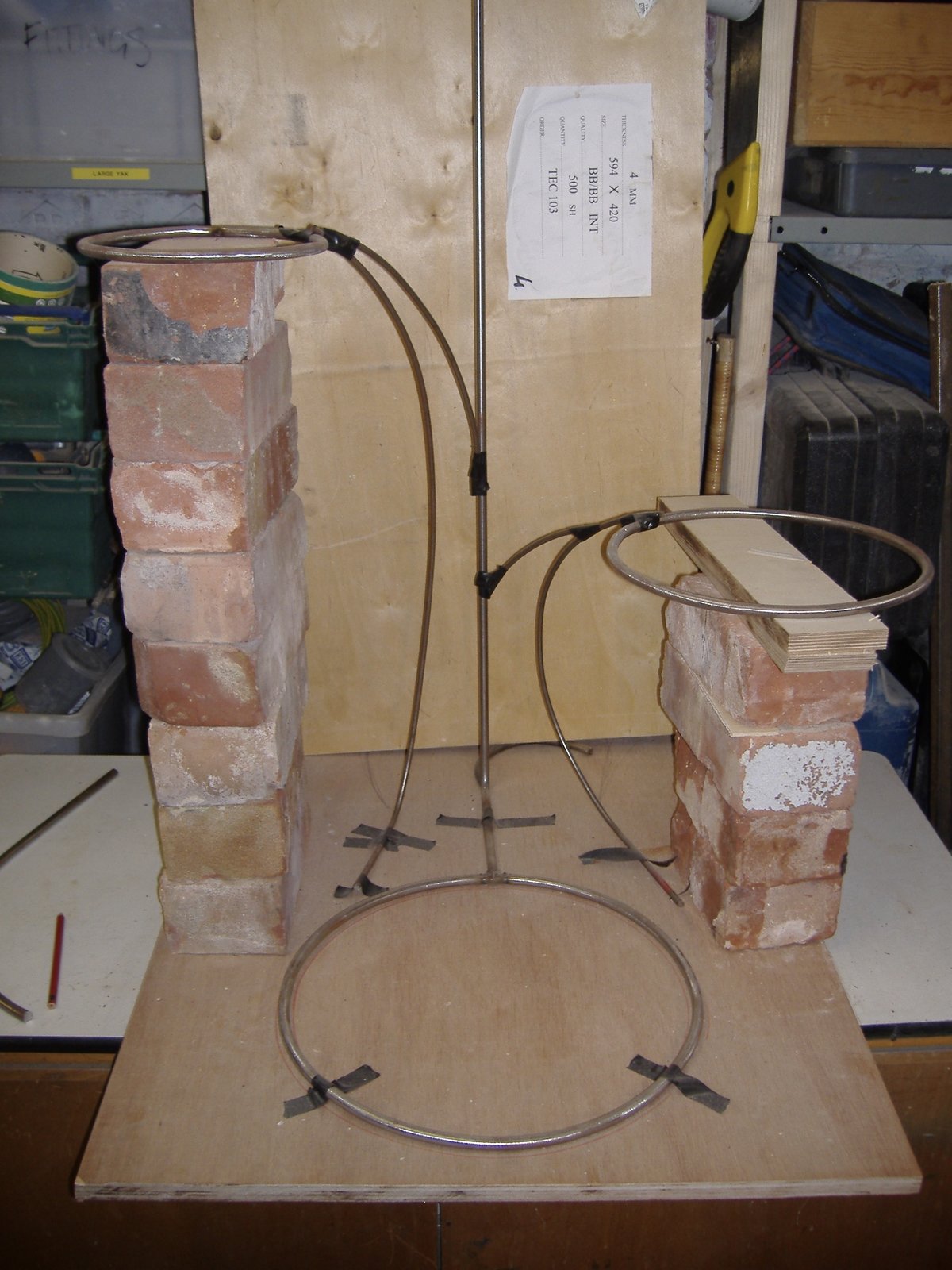

I wanted to make my own wedding cake stand! To be different, and experiment a bit. I was also inspired slightly by my work last year getting a copper distillation column repaired by a steam locomotive boiler shop, very interesting stuff So Copper it was. I also wanted a circular twist of some sort to it, and the side stays I did quite a bit of experimenting with. In the end I kept it simple.
I started by experimenting with the TIG, with bits of copper brake tube, sheet offcuts, with electrical wire as filler, also tried silicon bronze but I wasn't confident of making a nice job with it.
I liked this - autogenous pulsed TIG. I went with this for the bases.
Marked out
In process
Bases done
Set the centres using a plum bob, and some "custom" spacing... oh well, at least it's level
Fitting up the side struts
Sides tacked
That's as far as I've got with it. I'll weld them out tonight. It's been a bit of a slow project, because copper is expensive, and I really want it to look good and "as welded" so quite nerve racking to get the fits just right.
I MIGHT have to add a third strut to one side, depending on how stiff the two struts are on their own once I take the spacing out. ATM those two are equal and opposite so when done it will leave one side open for the cakes.
Obviously once I've finished the making, it will get a deep polish and let that lovely copper shine.
The tubing and the sheet are quite different. The sheet is pure deoxidised copper, and after welding it's annealed so soft that it's almost like lead. It work hardens very fast, though, and it doesn't have to do very much work anyways. The tubing I THINK will be arsenical copper, for pressure rated strength, it's thinner, welds just fine, and doesn't barely anneal at all. Which is good - needs to have some strength about it. It's almost impossible to seal the tubing up, as it takes a bunch of amps to melt it and heats the whole thing up so fast, the escaping gas blows a huge hole. So I've left it unwelded on the insides.
