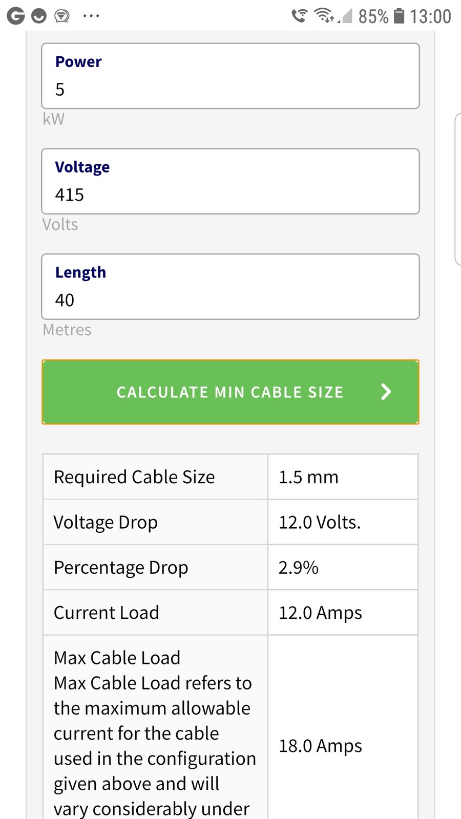

Want to make an extension cable to power a Keetona folder...what”s the min size of cable I’d need? Only temporary until a permanent cable is put in underground to the workshop so want to get cheapest cable possible.
It’s 3 phase with 2 motors. 4 pin plug on it just now with a separate earth cable.
The smaller motor to lift the beam states 2.2 amps/1hp on the plate. The bigger motor for the pump has 8.8amps/4kw on the plate.
Will need to be about 40 metres long cable run.
