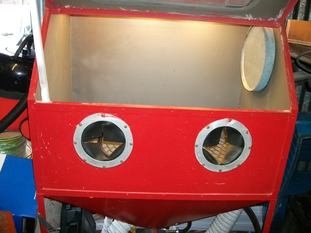

C c-k Member Messages 65 Dec 22, 2012 #1 I have a blast cabinet with workspace of around 60x80x60cm and looking for ideas/advice on better lighting due to standard set up been very poor, what you guys done to solve this problem Thank you

shenion Tool Pack Rat Messages 7,586 Location Stone Mountain, GA USA Dec 22, 2012 #2 I used a kitchen fluorescent under cabinet light.
brightspark Member Messages 39,361 Location yarm stockton on tees Dec 22, 2012 #3 mine has a hood on top with a glass bottom with 3 28w 2d flouro bulbs in it 019.JPG 194.4 KB · Views: 208
rtbcomp Moderator Messages 18,575 Location Sheffield UK Dec 22, 2012 #4 Keep mains out of the box. I use those small 12v halogens, they should be mounted at the front facing the rear.
