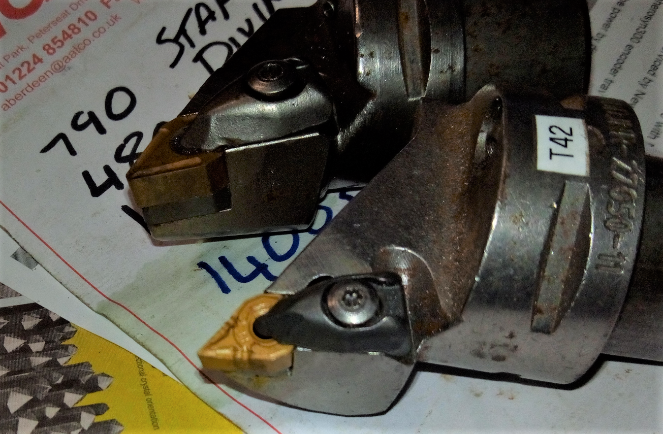

Hood I am obsessed. Messages 16,949 Location Carnoustie, Scotland May 14, 2021 #21 Most likely a DNMG or DNMA as has been mentioned, probably an 11 edge length going by your pic with the smaller insert in.

Hood I am obsessed. Messages 16,949 Location Carnoustie, Scotland May 14, 2021 #22 Pic of the more usual DNMG1506 above with a DNMG1104 below.
Munkul Jack of some trades, Master of none Messages 7,372 Location Cumbria May 14, 2021 #23 If it were me I'd be buying the cheapest DNMG 11 size insert I could find, and trying it. If it fits, then it's right.
