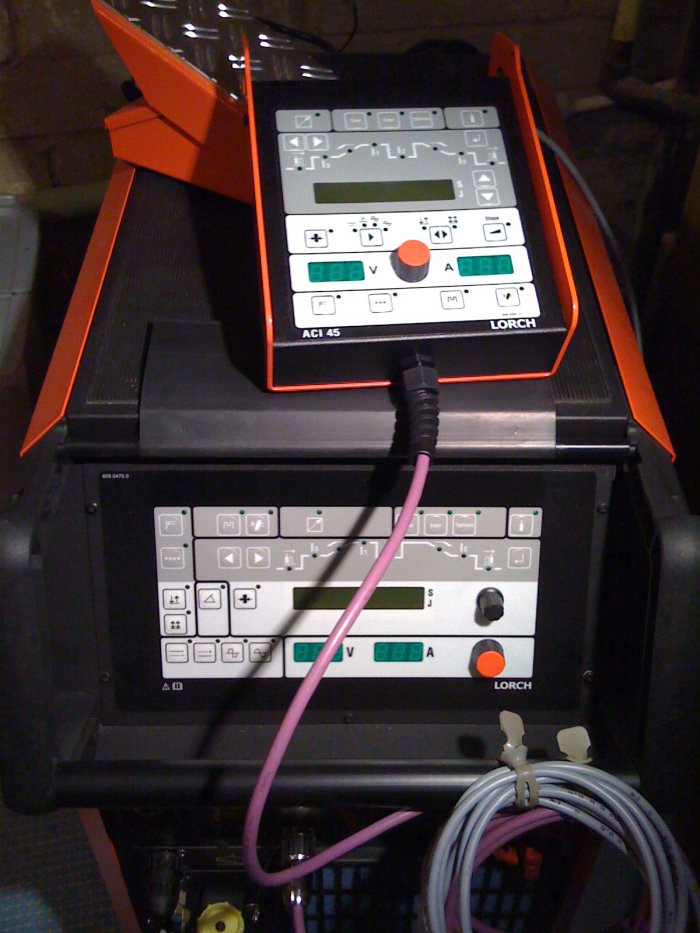

    Lorch V30 AC/DC,
    Solid & reliable, baring a small hole in the torch coolant feed and one blown fuse. In built pulser, massive amount of control, stable arc even when using a 5amp low pulse (will go to 3amps) excellent arc start, +ve arc start etc etc.
    Built in water cooler, all on quick connects for the (now all to common) torch changes.
    I use a Elga Optimator reg with twin flow meters for back purges job, has a built in anti-surge device, I'd equate this to a device that stops the reg over pressuring the line between reg and selanoid, and thus stopping a big surge of turbulent over pressurised gas on arc start, saves me a tone of ££ on gas.
    I just purchased a lovely, light Binzel WP20 water cooled torch, it takes the extra large gas lenses and is reserved solely for cycle frame building, its very comfortable to hold in the more tricky positions needed for complex tube to tube joints.
    Add to that the control offered by using a foot pedal, and a remote panel that gives full adjustments of all features right in front of me on the bench means I don't even have to get up from the bench to make adjustments when I'm focused on the job in hand.
    I know that most people would never need a set up like this, but just thought it'd be fun to add my 2 pence worth, out of all the rigs I've used, Lincon's, Miller's, Orlecons, a 45 year old BOC, etc its the nicest I've ever laid my hands on.
