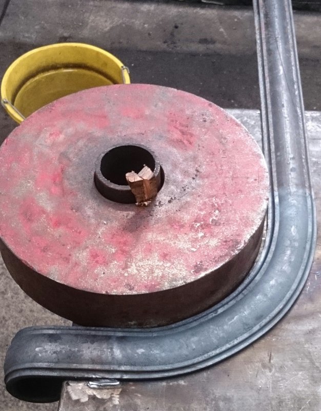

The only thing I can think of is tack it to the bench and heat with O/A and bend it round a big ring.
Any better ideas?
Yes but it's a special order and apparently it takes 4 weeks and comes from Italy. But need the railing done by next week.Do the people that make the section shown also make pre bent sections for corners etc?
I thought about that but decided against it because I think the profile at the edges would be hard to get right again.cut segments and weld back together? Would have to do a bit of maths to determine the angles needed but the more segments you cut the smoother the bend will be

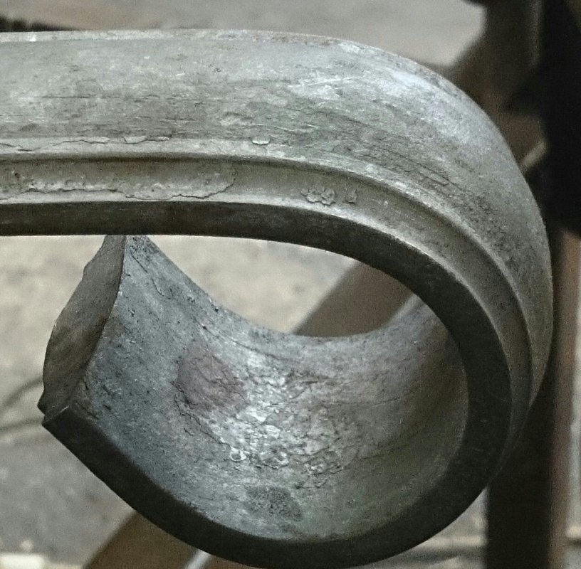

View attachment 42746 done this this afternoon. Think I might get away with it! Only another 19 to go.
Definitely not lead took a lot of heat to do that!Jesus, I thought you ment bend the other way. That's some going there - you aren't tricking us with a piece of lead are you?
You just gave me an idea where the weight discs for my barbells/dumbells might come in handy.
Nice job on the handrail.
