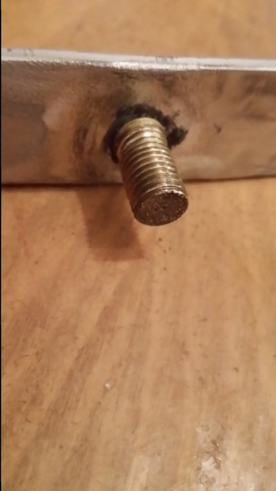

is 601 better than bearing fit. 641 I think I have..
641 is for parts that need to be disassembled, 601 is stronger but there are higher tensile strengths available for instance 638 & 648. With brass and alloy I would expect the thread to tear out before the 601 gave way particularly if your tolerances are good. Datasheets; 641 601
