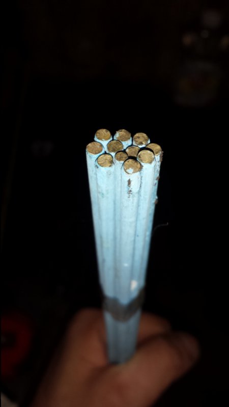

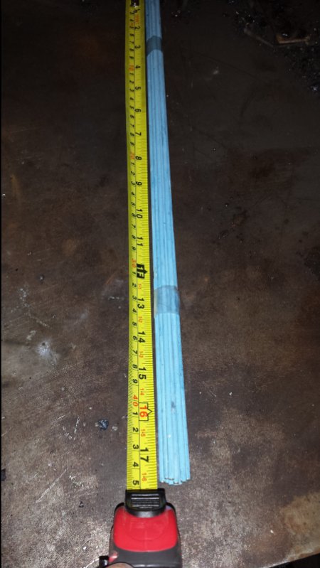

Not magnetic.
Yeah, that's why I said same at both ends.
There are no markings on them but I've never done brazing so wouldn't know a brazing rod if someone jabbed it in my eye.
The wife thought they were welding electrodes. I mentioned I had to grab a few dissimilar rods for a new job at work so "helped" by ordering some of eBay. She says they definitely said welding.
She doesn't really know, just nods now and again as I waffle.

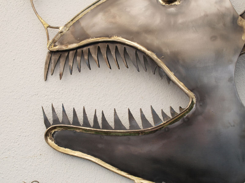

Brazing is simply fantastic for some jobs - small items, delicate work, thin metal, high carbon & dissimilar steel, parts which can't take the heat of a weld and so on.
Yep, it can be handy!
