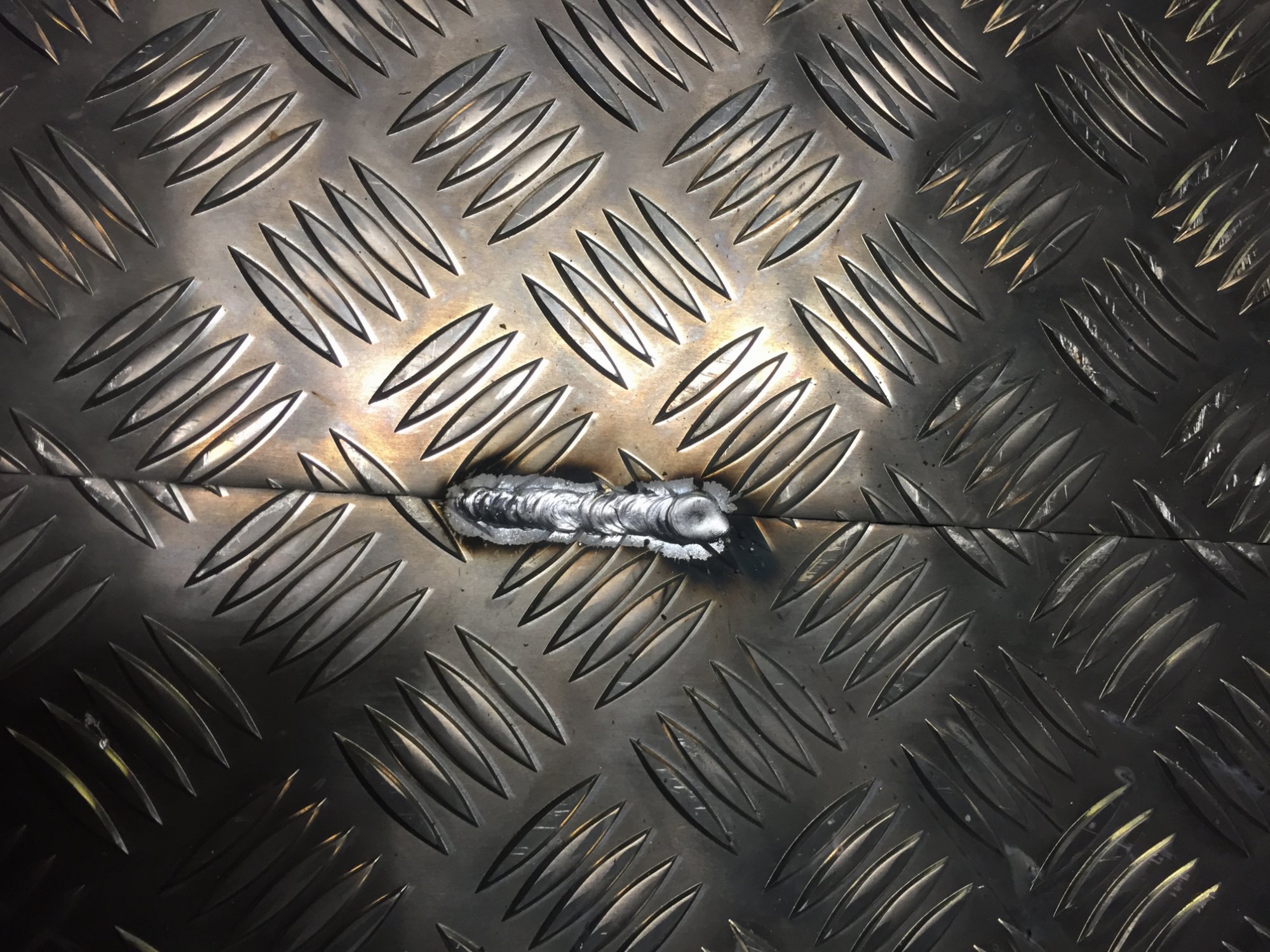

Have an S3 with twinpulse xt, I'm trying to butt weld sheets of aluminium tread / chequer plate together just stitch welds every 200mm. I'm struggling to get decent penetration without blowing through and still get a decent looking weld.
Using the settings Matt told me which work great for fillets but not doing so well on this.
2.5Hz
50% pulse relation
35% pulse on
Bout -20 on the arc length correction
0 on the dynamics
Wire is ESAB 4043 1.2mm
Was using 4T with a 120% hot start and crater fill. Around 85 amps was working okayish.
Any advice much appreciated. I'm sure a lot of it comes down to user control, so I'll have to get practicing.
