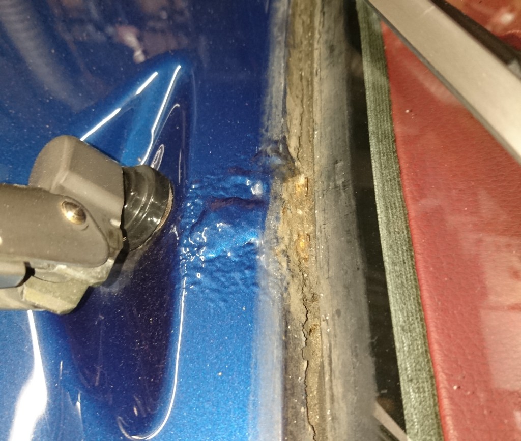

This is the most concerning area, the rust has spread up from a rivet holding the trim clip just visible by the glass.
This is the first time I have been able to get in and see what it is like on the inside, looks like its just perforated through but not as bad as I thought. You can just see the back side of the pop rivet on the right.
Maybe one of the cheep usb endoscope cameras attached to a grit blasting tube ? Will fog up quick but lower pressure and a bit at a time. maybe have a vac at other end drawing out the dust (fog).
