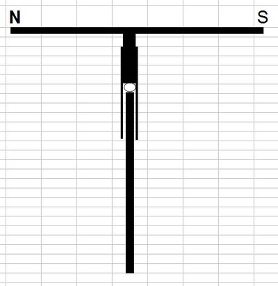

Summat like this:
I had 12mm bar for the base upright, the ball is about 12 to 14 mm and the tube that drops over it is just a loose slide fit with 12mm bar welded into the top 100mm as a stop to sit on the ball
