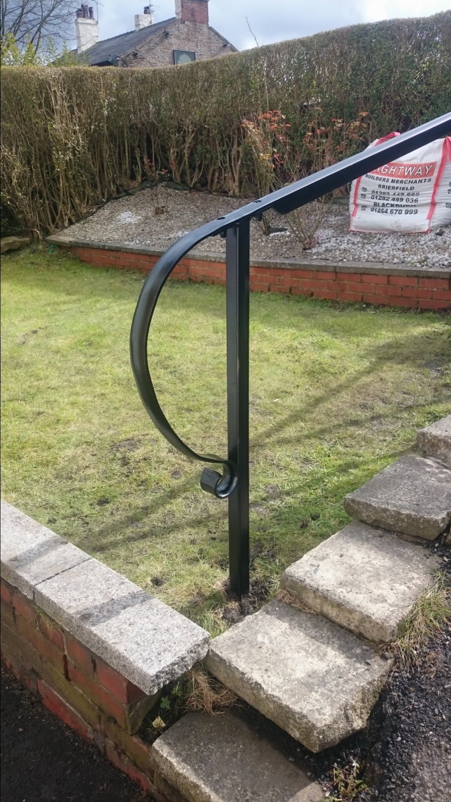

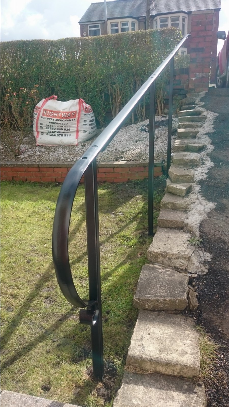

Kent Member Messages 9,992 Location Bowland, Lanacshire,UK Apr 5, 2016 #1 Today's fit. Another scrolled handrail this time (due to issues were I could and couldn't get posts in) I needed to get some support under the 50 mm convex. Used 40x 10 chain stitched to form a T
