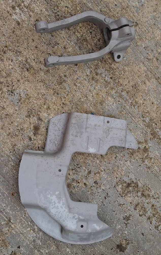

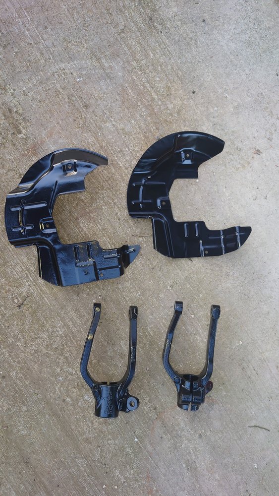

Thank you for the offer ,Agree with dcals suggestion. How quick to you need them coated? I can cerakote mc5100 these for you for £10+ postage. They'd be vapour blasted before coating.

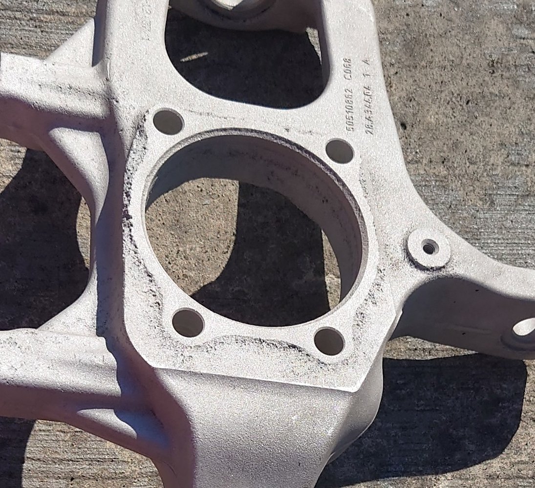

Exactly this.Leave it as it is. Shiny bright ali just furrs up again. Aluminium has excellent corrosion resistance because it spontaneously forms a thin but effective oxide layer that prevents further oxidation. And aluminium oxide is impermeable
Is the coating they did clear? It might be nyalicExactly this.
They already have a protective finish that has formed and it looks good. Under the car where you can't see them, leave them alone. Blast that finish off, expose nice new fresh reactive aluminium, and it will corrode.

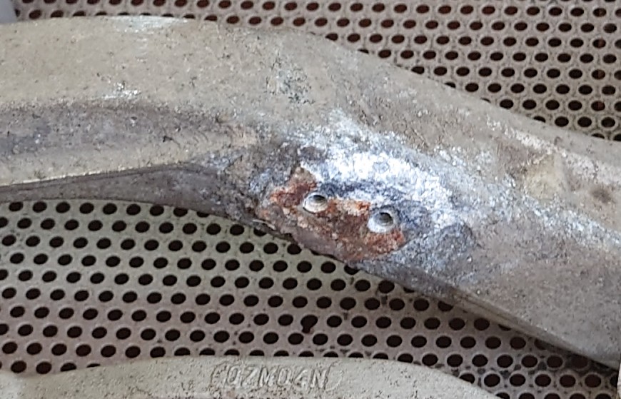

Yes, it is a nightmare for me on the boats, just eats the alu away when people don't think on how they fix stuff to it. I am about to repair a gantry on a boat that had steel pond boards bolted directly to them.This is the type of galvanic corrosion I'm talking about, where a badly painted steel bracket is bolted to alloy.

It is a bit mad to be painting suspension bits on a shed but if you don't experiment you don't learn.

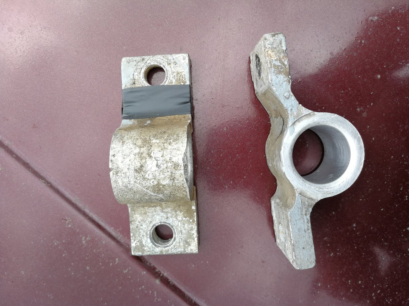

So depending on series, at the least it's 24 yr old - so whatever is on that bracket, its not looking bad - I still say you won't improve on it.Brackets/bush holders are bolted to underside of floor so lots of surrounding steel and lots of moisture and salt in this part of the world.

An old saab 900 for reference.
But that doesn't look bad - and the corroded bit where the metal bracket is bolted is more likely due to the failure of the coating on the steel part.
