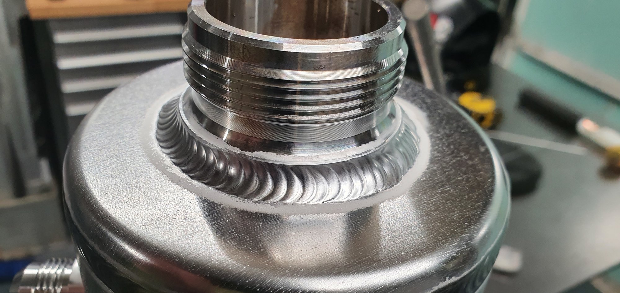

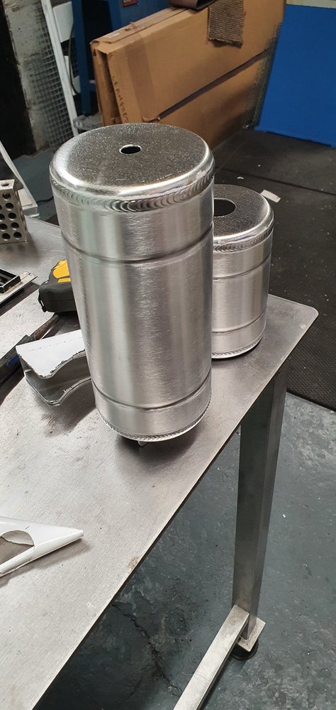

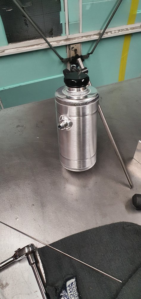

Some very nice work there . I was going with a 10L minimum, purely of guess work. Race is half hour long but definitely don’t want to be running out half way throughHow much fuel are you looking to hold I will be turning some new press tools soon the largest being 190mm theese are the smaller ones I make from 1.5 but it let's you get the picture, the inside of that one is to show the penetration I normally get

One thing I could see with your design being an issue is the sight glass. It’s a weak point which will allow a leak in an accident.

You’ll need a vent as well so it doesn’t draw a vacuum

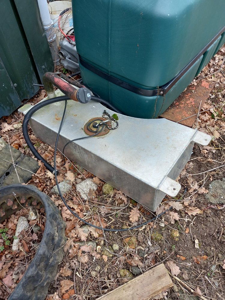

Shall send you a PMHere's a photo of the tank. Overall dimensions are 36" x 16" x 10" approx.View attachment 385435
