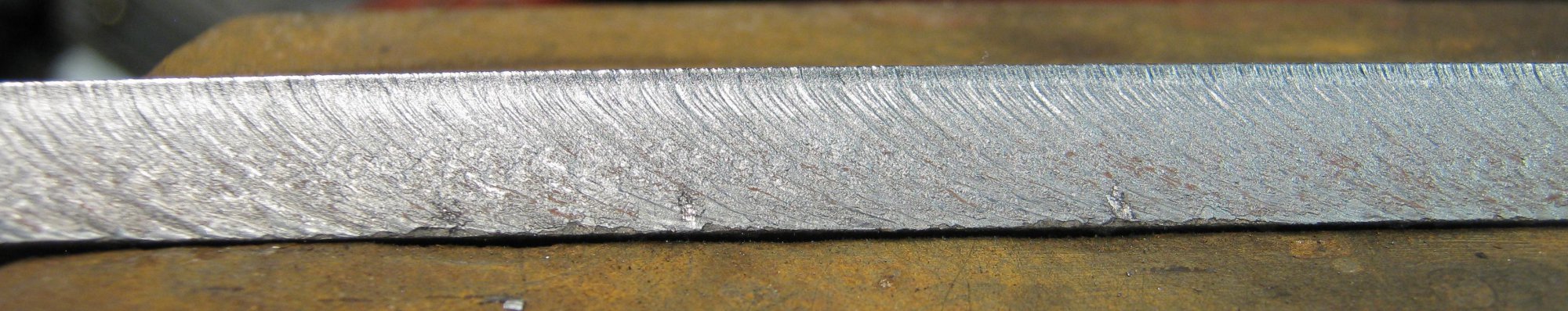

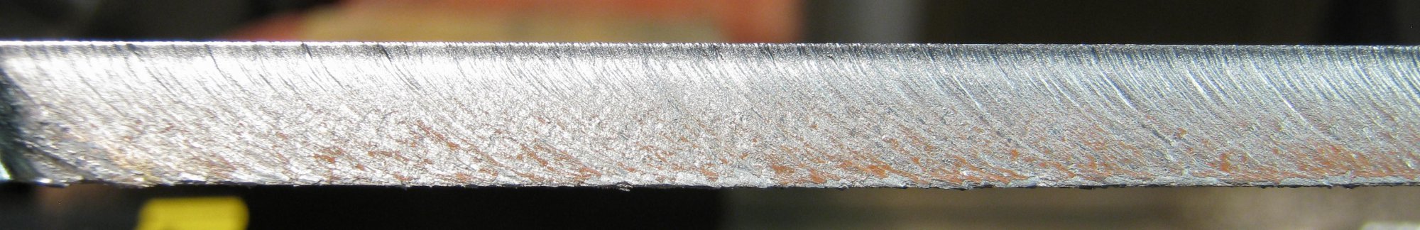

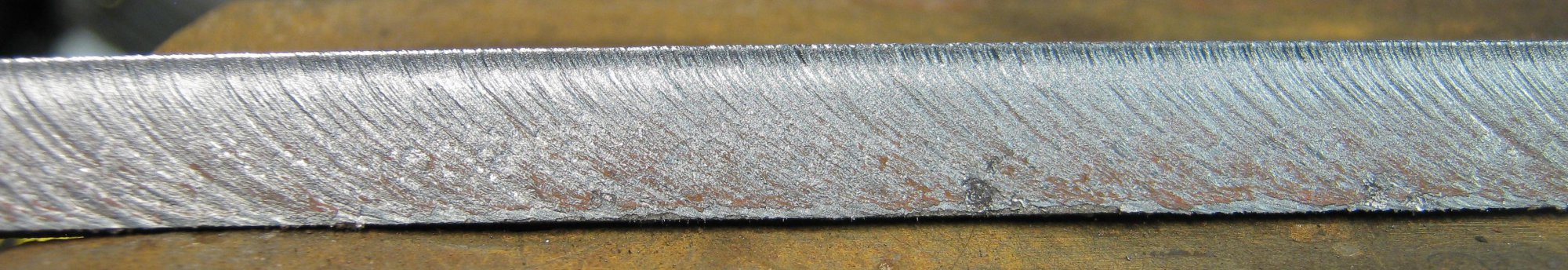

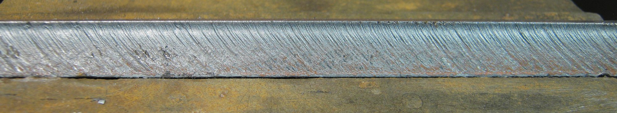

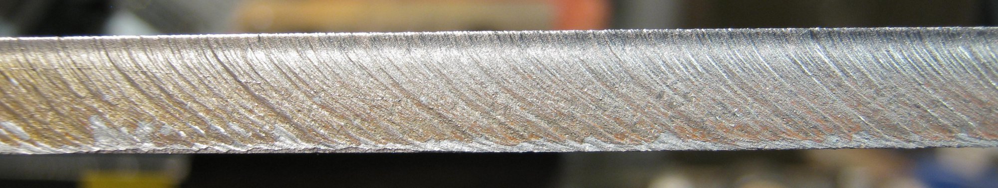

So I took two pictures of two cutting speeds at 35 Amps
This is 300mm per min with a cut angle approx 52 degrees
This is 250mm per min with a cut angle approx 39 degrees
So I would think around 180 to 200mm per min would end up at around the 20 degree cut angle, any dross build-up on the bottom was soon taken off with a hammer.
So questions is the 20degree angle correct as a sign of correct speed for the current?
