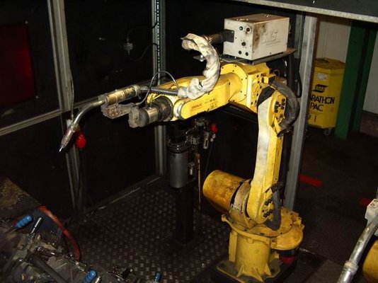

A welding robot, most robot manufacturers produce something similar. 6 axis powered by 6 servo controlled electric motors capable of carrying 5-10 Kg at about 2500mm per second with an accuracy of 0.1mm.

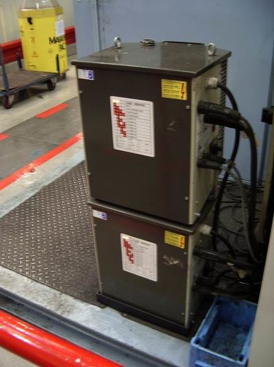

Welding power source can deliver 5 - 480 amps.

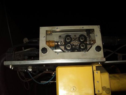

Wire feed unit mounted on top of robot supplied with wire from a 475Kg bulk pack and plumbed in gas.

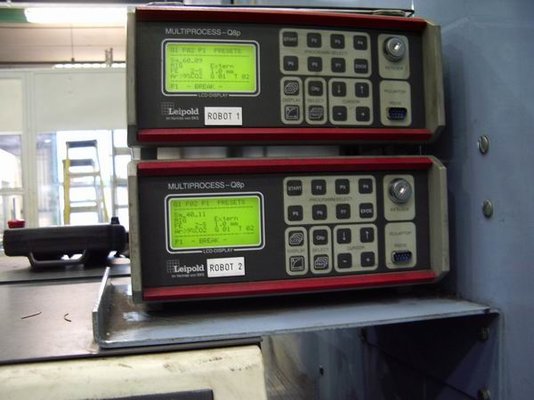

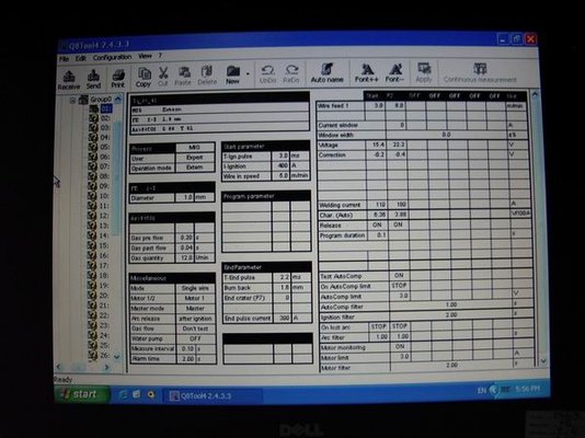

Weld controller, the "brain" stores the weld parameters for each individual weld. When the robot is ready to start a weld the controller switches on the power source and wire feed unit then monitors the weld characteristics.

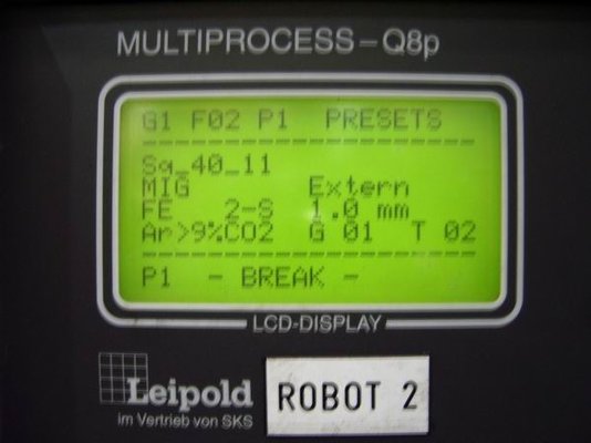

Close up of weld controller screen.
Weld controllers are networked to a central PC to allow process monitoring and changes to be made.

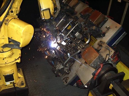

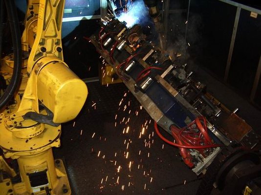

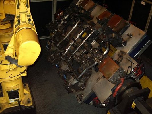

Components are loaded into a fixture then indexed 180° to face the robots.

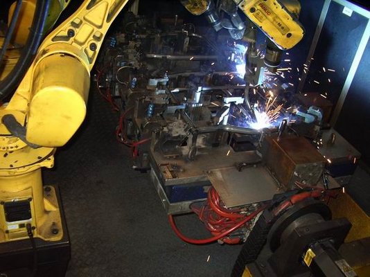

Component is welded by 2 robots to reduce cycle time.
Fixture position is controlled by master robot to give best access to welds.
Fixture can be rotated upto 360°.

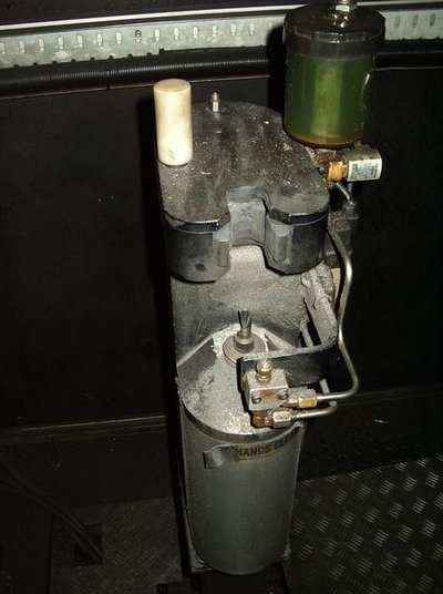

Every 3rd cycle the robots go to a torch cleaning station to have spatter removed by a reamer and a squirt of anti-spatter, there is also an air blast through the torch to remove any bits.
Each welding cell is controlled by a PLC (industrial computer) any weld failures are detected and flagged up to the operator.
Some of our cells have nearly 100 welds per cycle!
