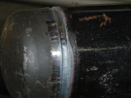

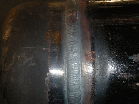

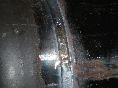

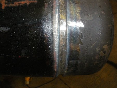

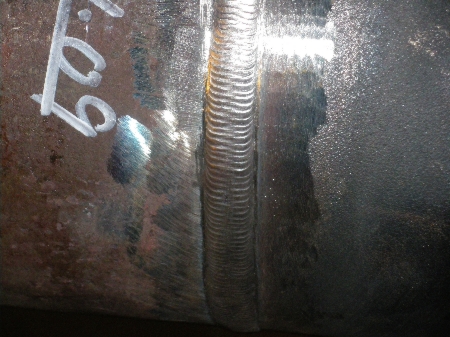

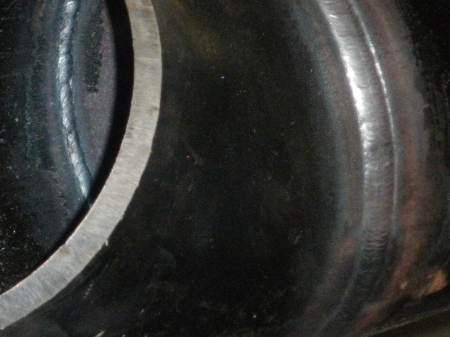

hi guys just a few pics of some tig 6" carbon sch 40 .the set uo is 4mm gap and fether edge prep,125-130 amp root...175amp fill....150amp cap.il try get a few more pics up.some of some lo-hydrogen caps ,root set up etc.
