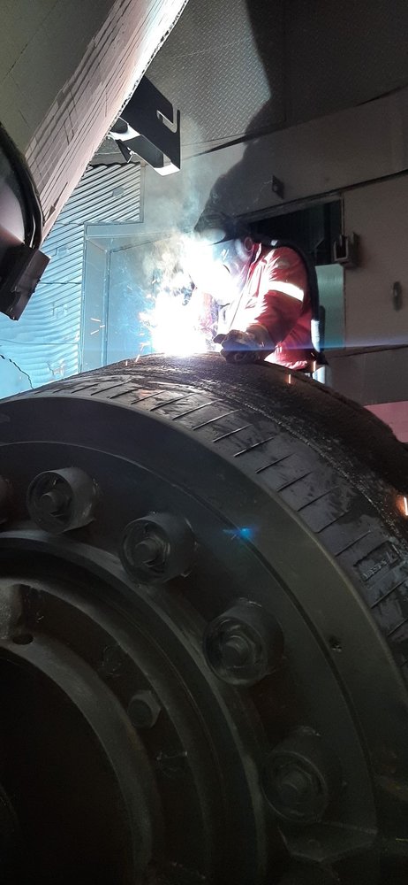

This is my
Then the fx kit started playing up so I bought the new G5-01 kit.
And it's exactly the same, I get odours really strongly, I can taste dust, sometimes I even have the old black face/moustache from dust and I've had the helmet on non stop.
Grinding is the worst. Im sure I get more grinding fume through the helmet than I would if I had nothing on.
