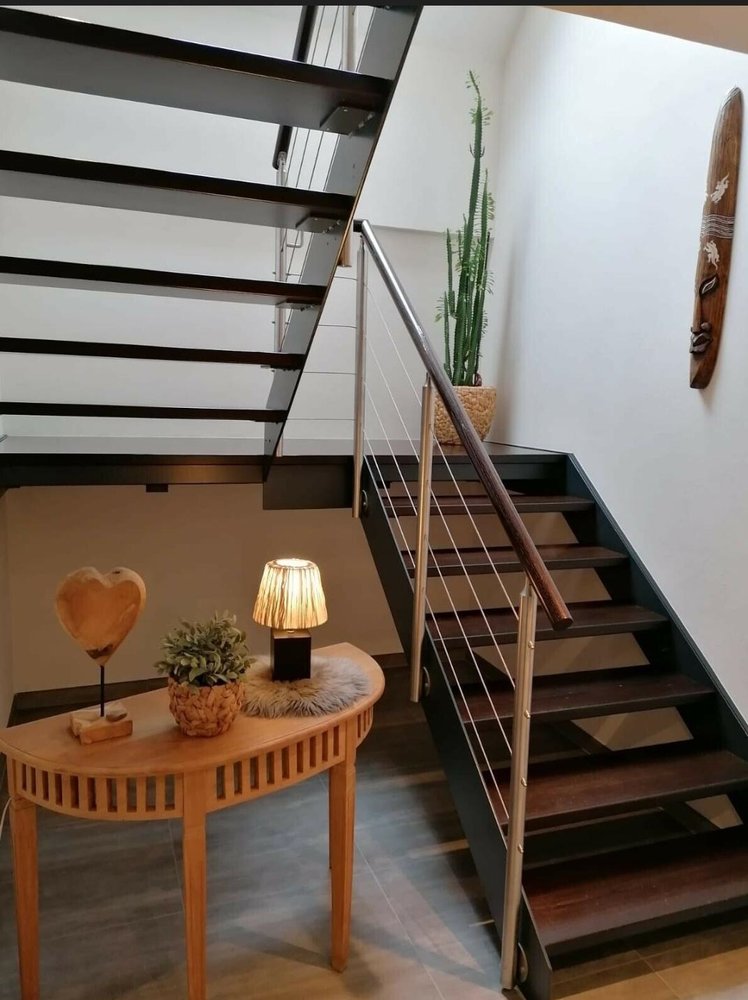

Hello, Just joined here, first post but certainly won't be the last and sorry for starting with a question. I have bought some previously used stairs (see photo) with 10mm metal sides and 8mm step supports and stainless railings. I'm renovating my house in the north of Germany, the steep old wood stairs are being replaced with these. There are many modifications to the stairs required, both 10mm thick sides need lengthening because of higher ceilings here, the steps supports need to be cut off and rewelded at a slightly different spacing, the base plates under the screed floor will need adjusting, I am also changing them to L shape with a smaller platform. I paid 1900 euro's for them incase anyone's interested.
The first metal project I will do is a 2 sqm trap door to the cellar which goes under the new stairs, probably from 3mm steel so not much power required and will give me some welding practice (I work with tools every day but I haven't touched a welder in 20 years). In Germany, houses have 3 phase mains electricity as standard, that astonished me when I moved here, so far just the induction hob and oven use more than 1 phase, but it means I can buy a second hand 380V industrial quality welder!
There is a total of about 1 meter of 10mm plate to 10mm plate welds required; the support plate under the end of each wooden step is 8mm plate, welded to the 10mm side piece.

Here are the stairs, this is the sellers photo:
