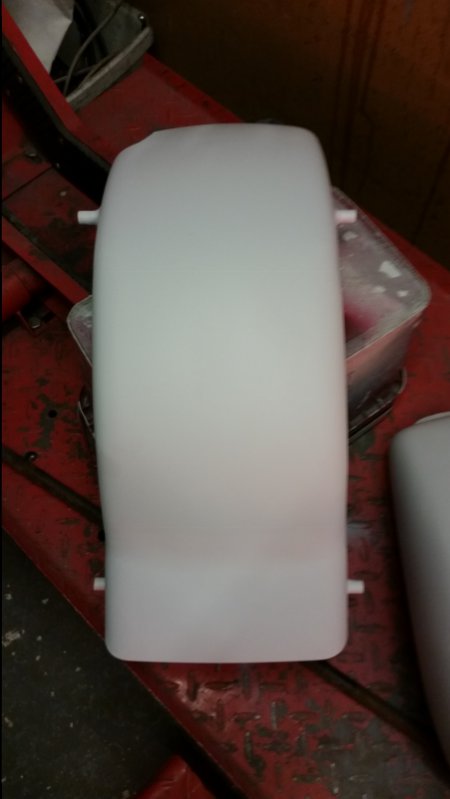

Hi all quick question if I need to laquer over my 2k top coat dose it have to be the same day or could it be in next couple of days
Thanks Paul
Well im now confused. If you need to put a clear coat over the top of 2k top coat as per your question, you need to cure it and key it up. If however you are talking about putting 2k clear over your basecoat, then soon after flash off
Nick
Nick
Yeah sorry about that .okay it's 2k blue and I was thinking of putting a glitter over it in clear coat.
