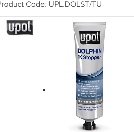

But surely 2k would be more suitable especially as said, its unstable? That's the question.
Are you sure it's 1k? I've seen reviews where people complained that it didn't go off and others said you need to use your own hardenerSee. I ordered my dolphin glaze, and when it turned up, it was a 1k version, so I'm assuming upol would not produce a 1k unless it had a specific application. I can't think where you would use it, hence the question.
Would have guessed the 1k stopper is a putty for swiping into pinholes prior to priming.
Don't like 1k products though.
2k topstop or dolphin.
Exactly, which is why I asked the question. Why 1k putty. What's its purpose.
Just for the less learned here, would you still recommend a 2 part filler for pin holes minor marks in primer before topcoat??
was about to go buy the 1k Dolphin Stopper.
