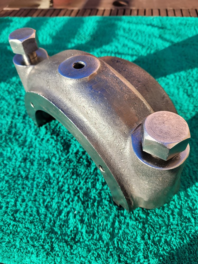

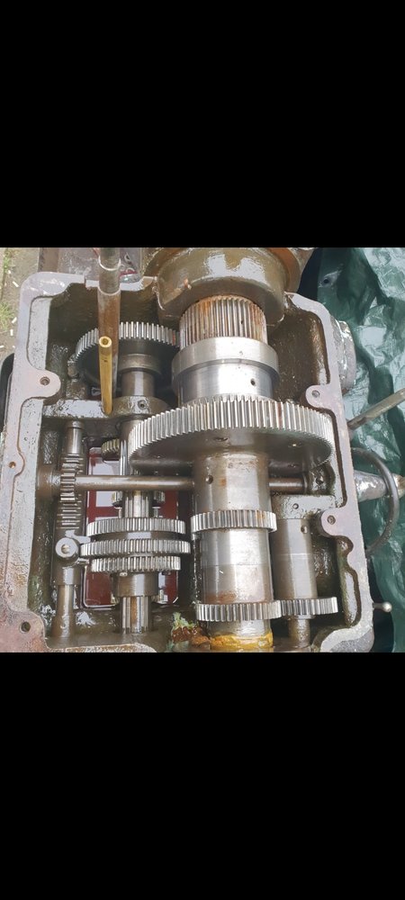

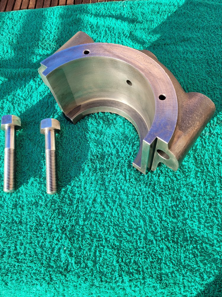

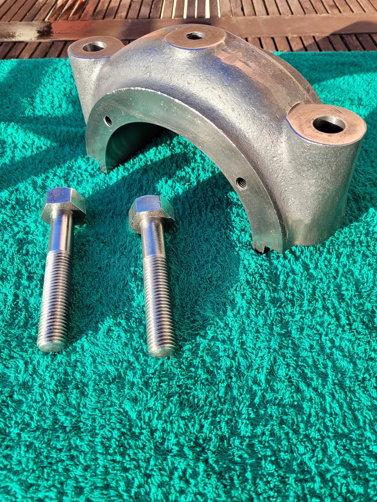

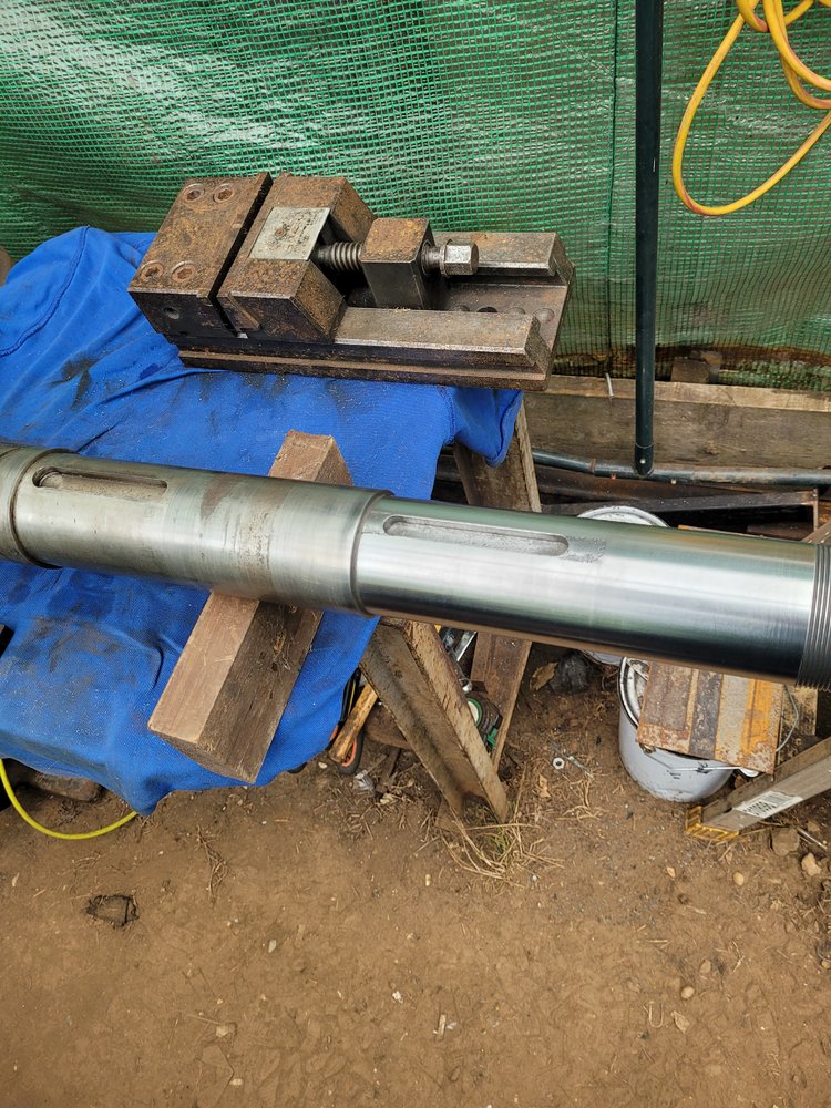

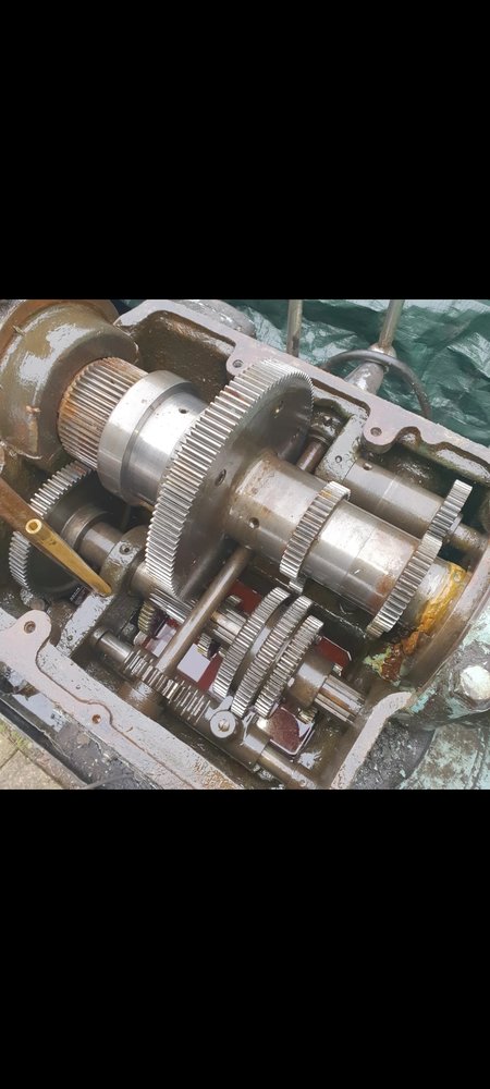

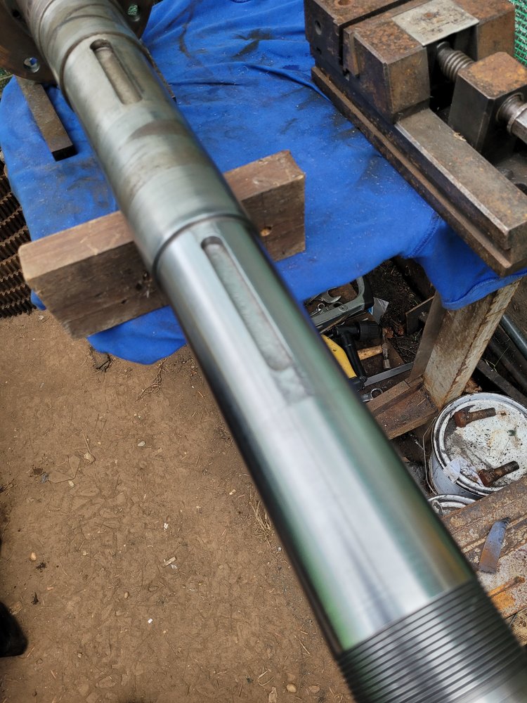

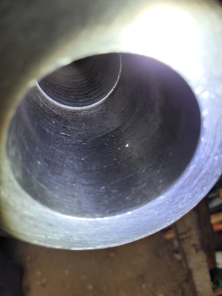

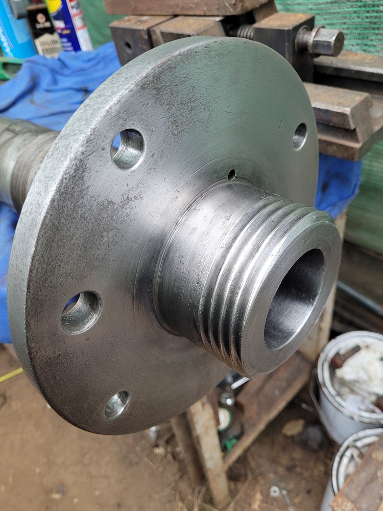

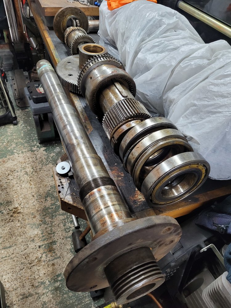

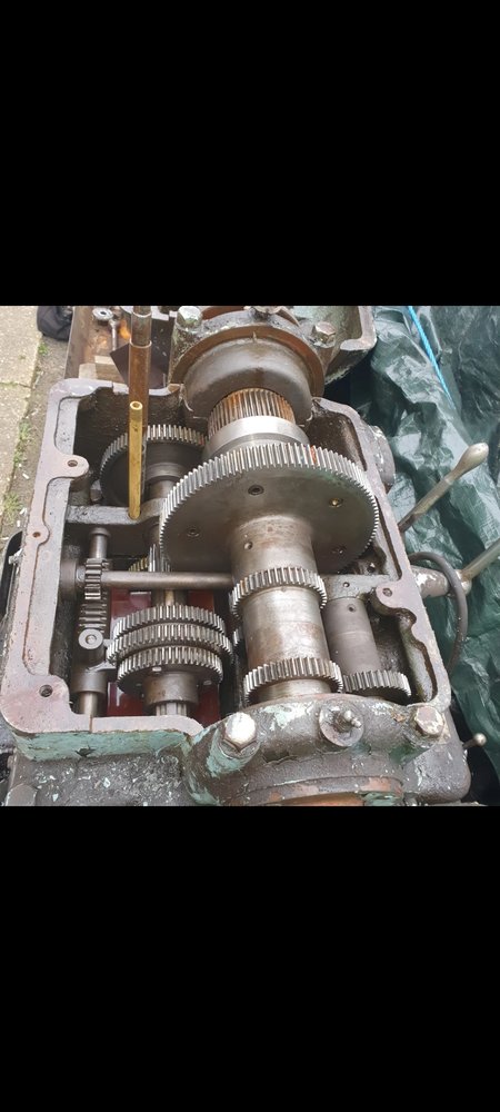

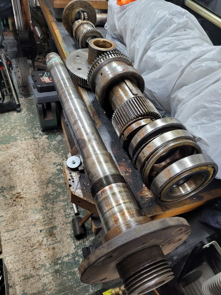

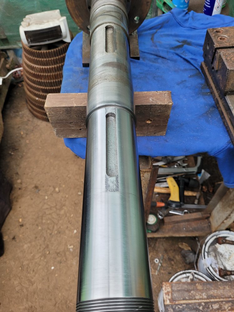

Hi everyone. I had this 1930 dsg 4AR lathe for ages. I stripped the machine down for restoration. Headstock wise it's awesome in its build quality and size. Hear is some pictures of the headstock and spindle. The spindle its self is a big lump with 6.5 triple front bearings. 5 1/4 single rear. The bearings are single row cylindrical.
