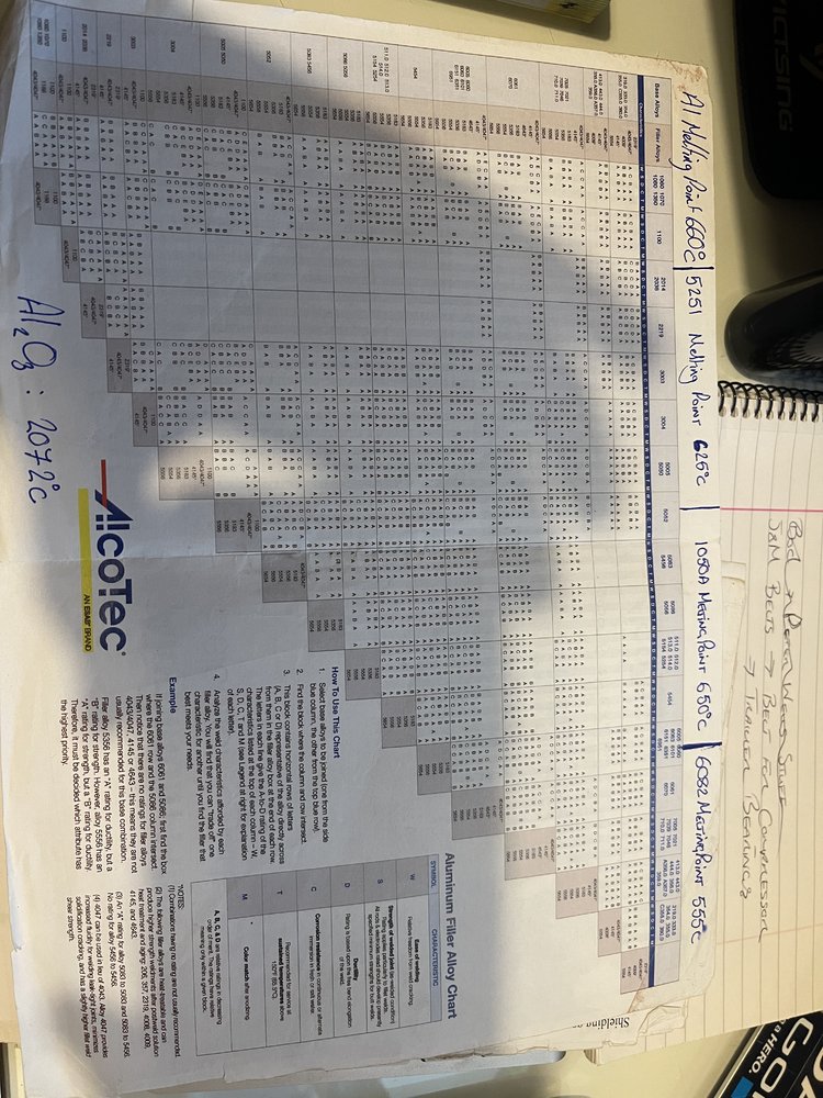

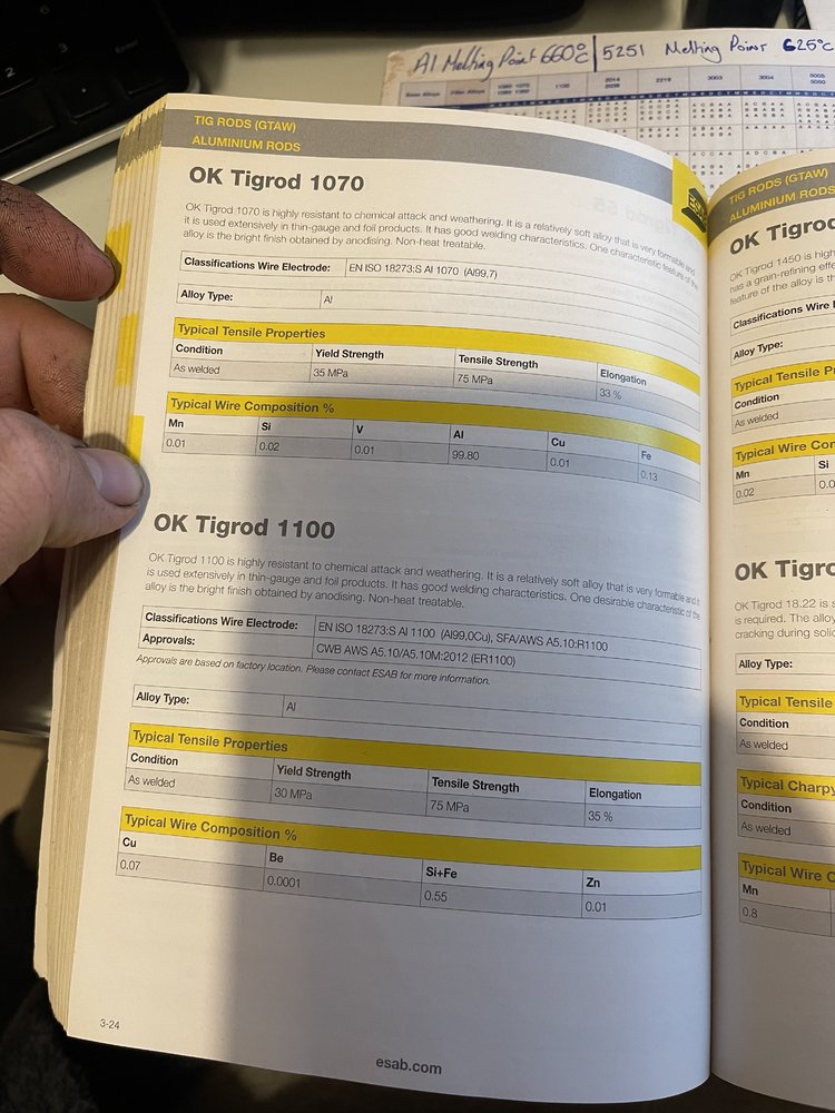

If you want a matching filler then any 1xxx series filler will be suitable really. Your 5356 filler will work fine but will be giving an overmatching weld metal, which is not always desirable.Got a job coming up I've been using 5356 filler on most things haven't had a problem yet,but looking a little further i should maybe be using 1050 filler,
local supplier recommends using 1100 filler
You'll just find the 5356 is stronger than the 1050 so you can end up with a harder zone, for tanks that vibrate/expand this can have a greater propensity for cracking.Thanks Brad I got a chart of hobart,
I've found old posts on here that says to use 1050 filler which made me a little nervous,
I use 5356 for most except cast but going by hobart and as you've posted 1100 filler is best suited for the 1xxx series, sheet, I've been using 5356 to weld my fittings which are normally 6 series to 1050 again never had a problem but reading through old posts here 4043 is best,
Thanks Brad I've done a bit more reading on it I've just been going with the flow, I've a marine tank to do and a radiator to fab, this is what's caused me to look into it moreYou'll just find the 5356 is stronger than the 1050 so you can end up with a harder zone, for tanks that vibrate/expand this can have a greater propensity for cracking.
