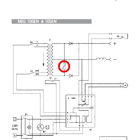

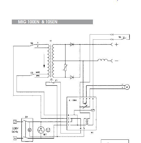

The 100EN is like the 130, the contactor is after the main transformer. So, power is on all the time on the rectifier. Does not look like a stuck contactor issue.
I just saw a different schematic an the MOV is across the transformer outputs where they connect to the rectifiers.
