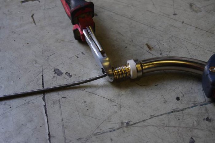

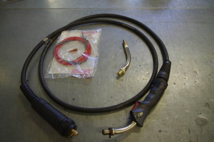

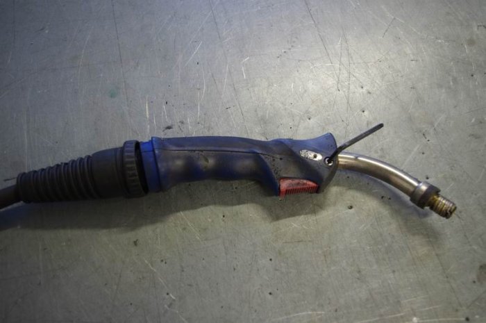

Had to change a swan neck the other day and as I had a camera with me thought I'd do a bit of a tutorial
Torch is a Binzel MB25AK with the new bits to be fitted

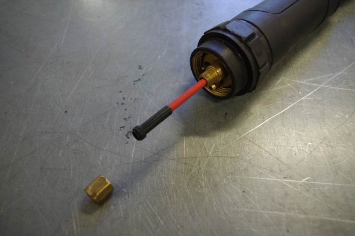

Undo the liner retaining nut and remove liner

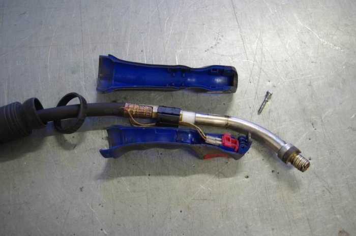

Open body by twisting locking ring at bottom amd removing bolt at top
Body opened up

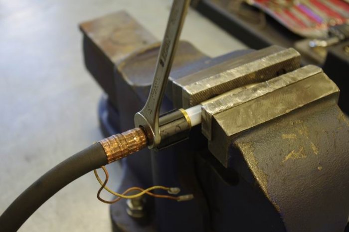

Disconnect trigger wires and slacken swan neck locking nut

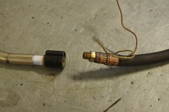

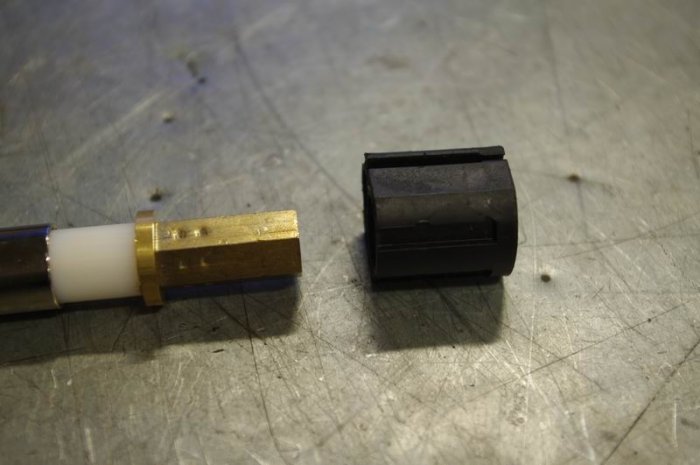

Swan neck seperated from cable, remove cable guide from old one...

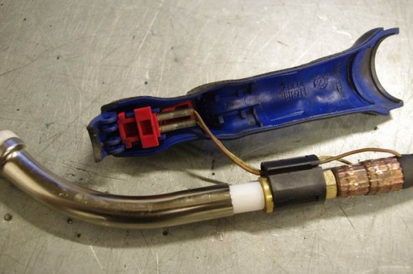

...and fit to new swan neck
New swan neck fitted and cables re-connected to trigger

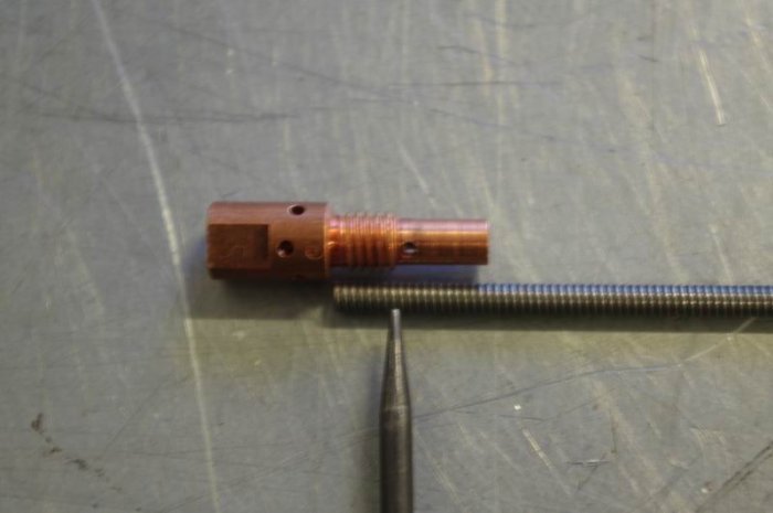

Remove liner and use tip adapter to gauge length to trim off liner
Dress end of liner on grinder to remove sharp edges to prevent snagging when fitting
Re-fit liner, secure with retaining nut, then fit tip adapter and put into spares rack...
