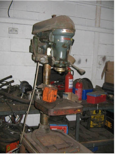

Bought this off Ebay about a month ago:
They put it in the back of my car with a forklift truck, I had to dismantle it in situ to get out again.

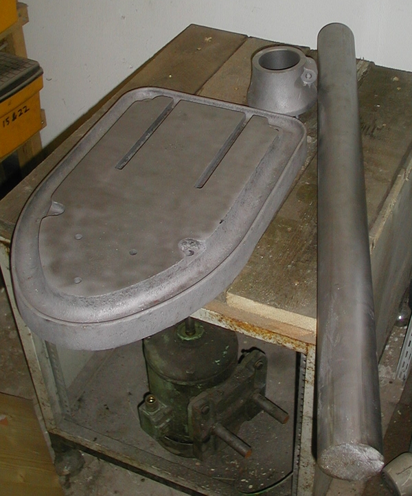

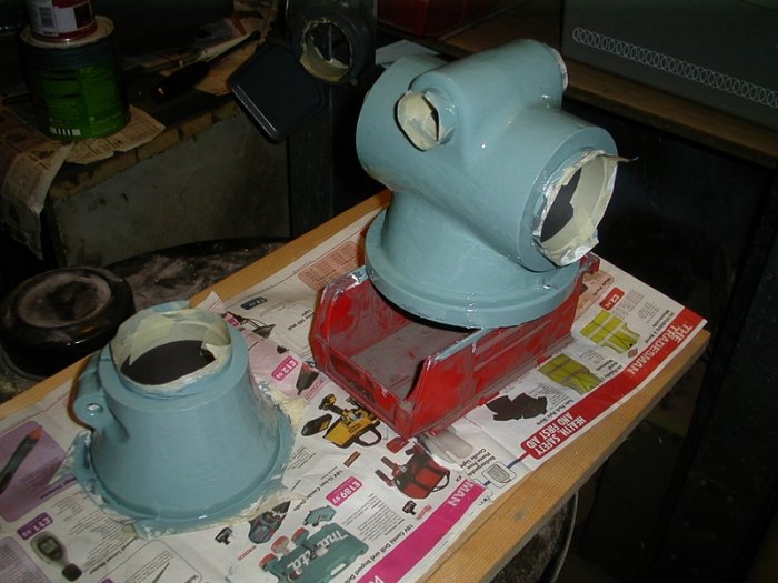

I grit blasted the rough cast surfaces and bead blasted the machined surfaces:

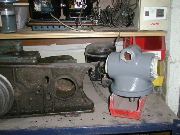

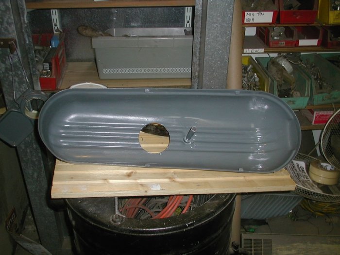

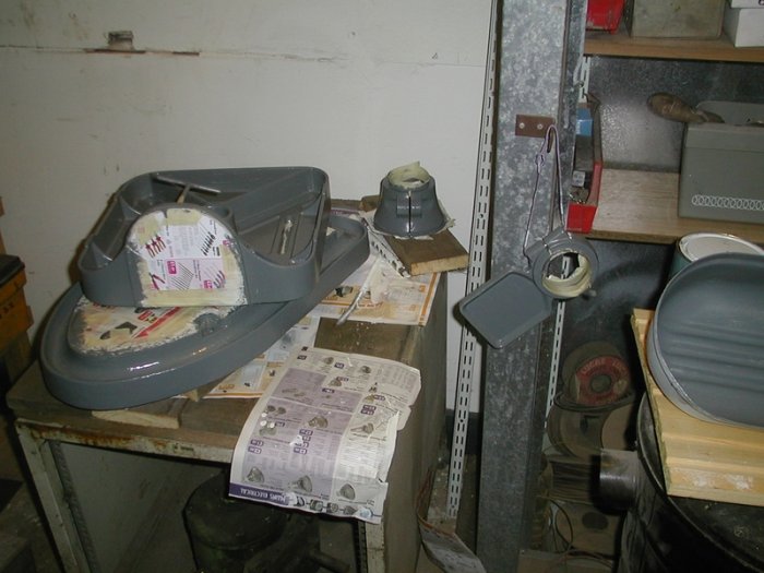

It's now been primed and undercoated:

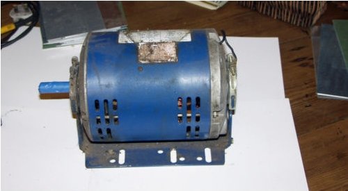

The original motor is three phase, but got this single phase one off Ebay, correct power, voltage, speed, shaft and keyway sizes, and reversible.
