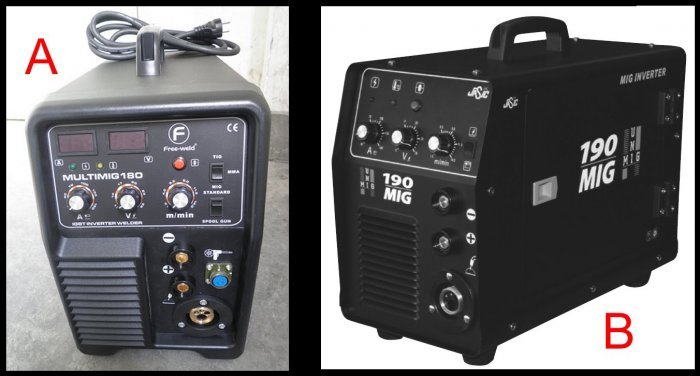

- 480 quids: Free-Weld MultiMig 180: found this on a Dutch site, 3 year warranty, spool gun socket, can be used as MMA and TIG (not essential, can help one day to fix something in the open air with MMA or start learning TIG). I could not find any real info on this welder (no Free-weld brand anywhere, Google is quite dry on this). Back up would be Ok for me as the seller seems to be serious (sells also REHM welders), he is in the Netherlands (2-3 hours drive from Paris, I can survive if I really have to go there), 180 Amps at 35%
