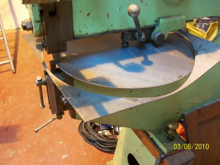

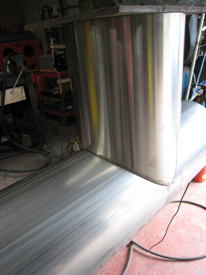

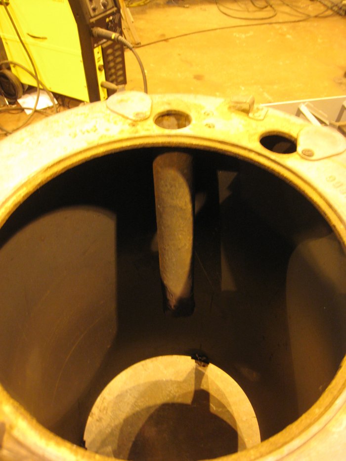

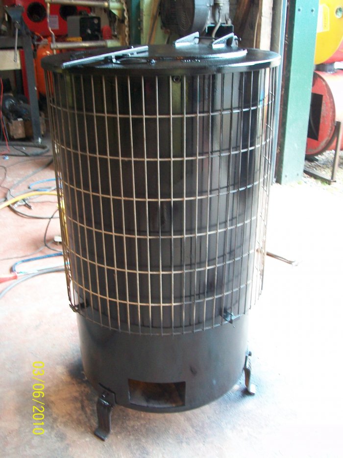

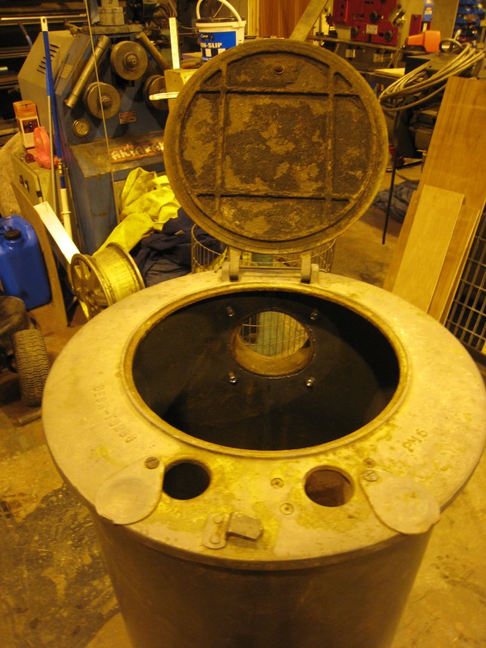

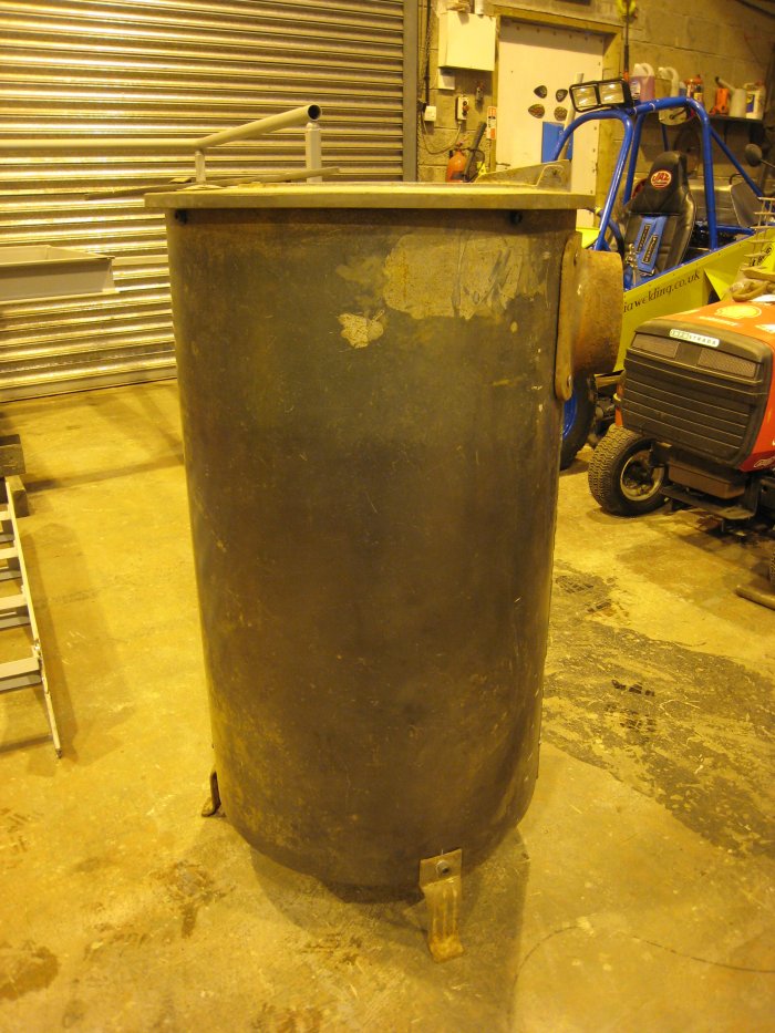

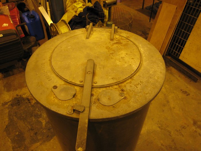

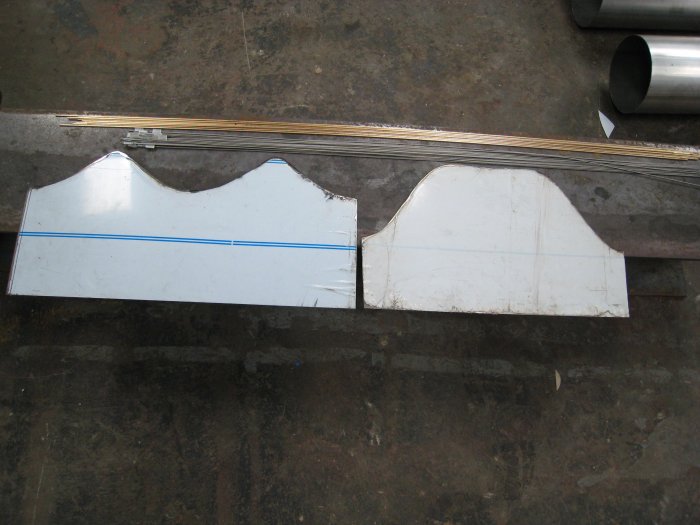

Picked up a burnt out woodburner from a joiners shop last summer and salvaged the top flue outlet and feet.

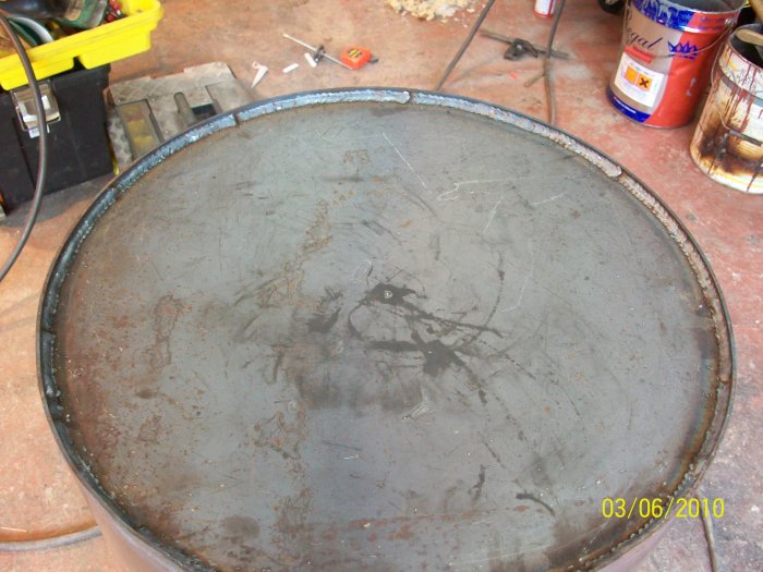

Had an offcut of 3mm sheet leftover from a job so rolled a cylinder and started forming my new heater for the workshop have made it tall enough to take an average sized pallet, will probably get away with splitting the pallet into three pieces so will save on time in cutting pieces small enought to fit.

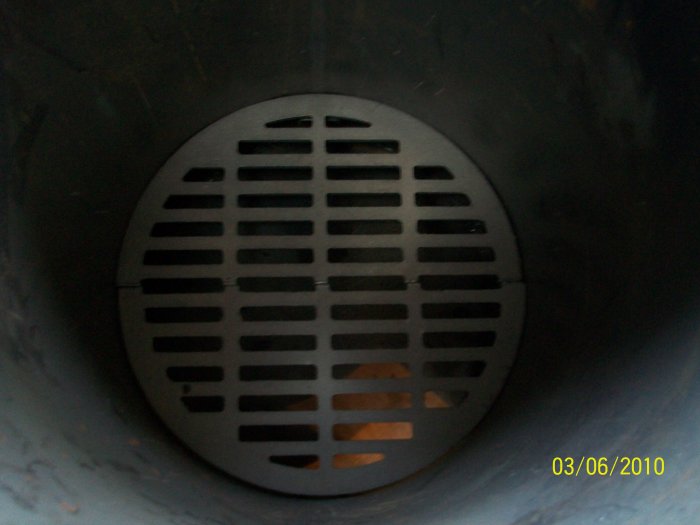

It's a top loader and has two air intakes situated on top as well, one air intake has a tube which will allow air into the centre of the wood pile. Still have to make a bottom for the stove and fit a grate. There will be an access door at the front between the grate and base to allow removal of the ash.

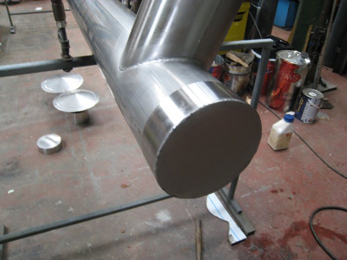

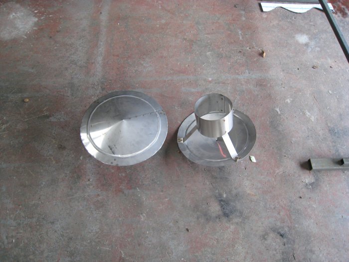

I thought china caps were dished oot, must be the vino, plus too much solar today
