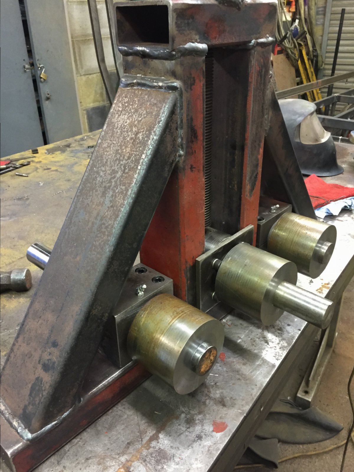

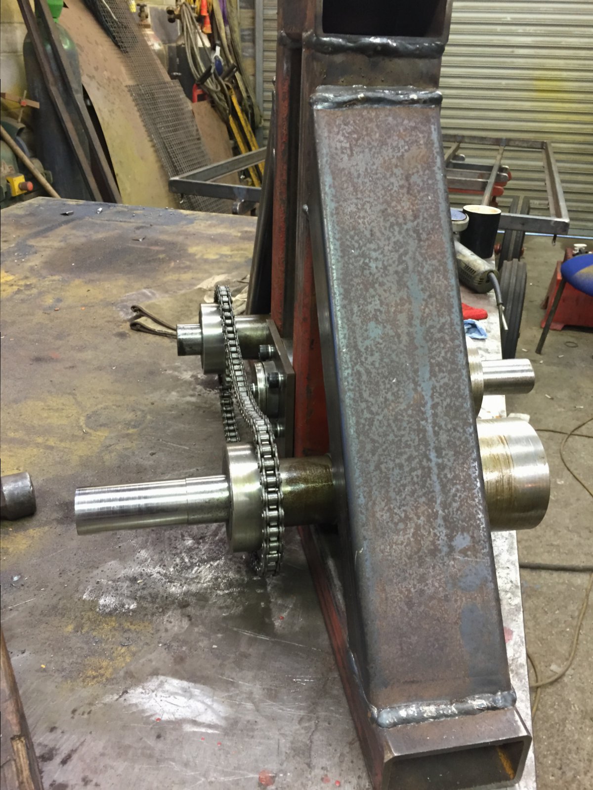

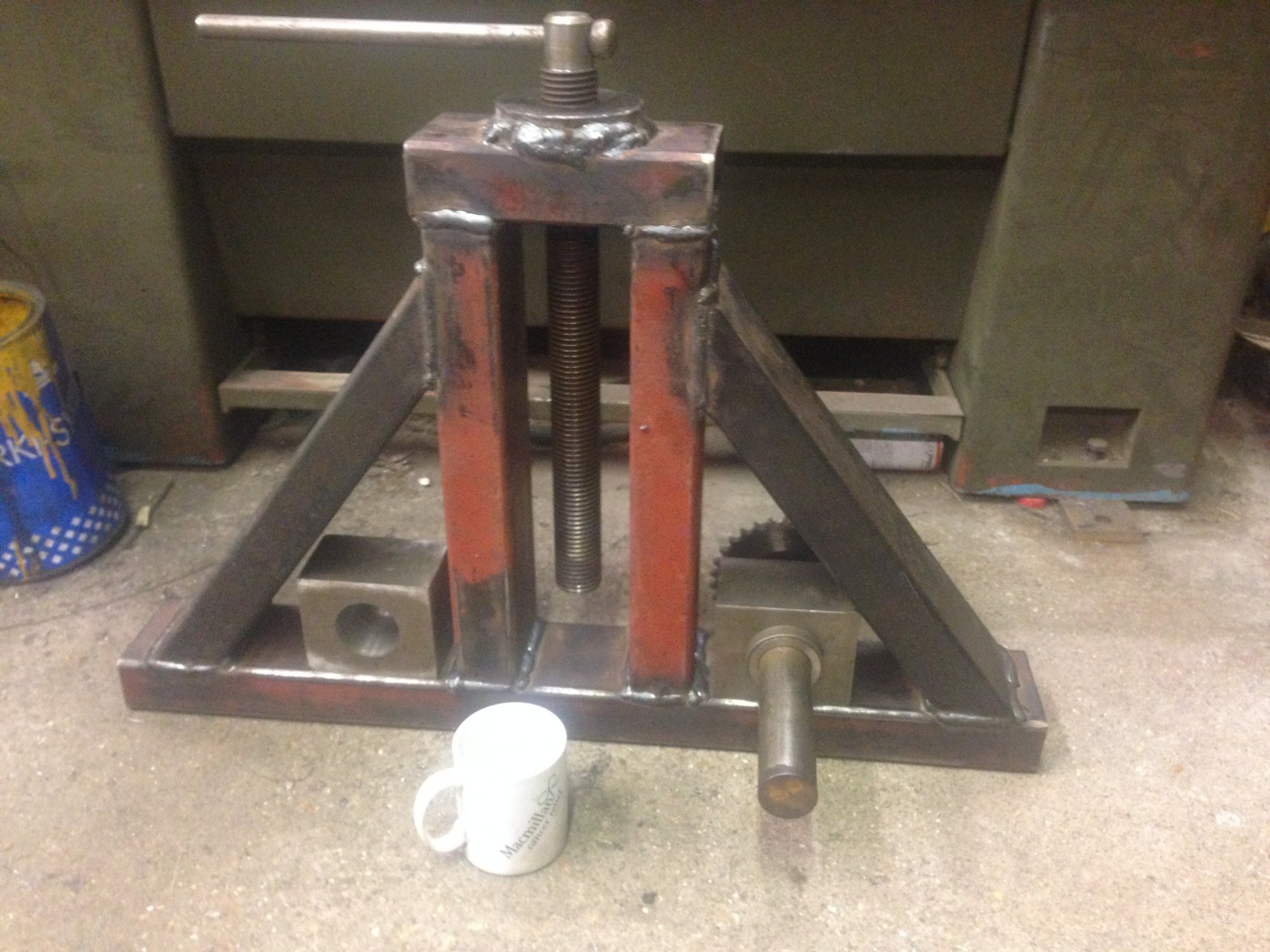

a little while ago, well many a year or two I built a ring roller one weekend out of whatever I had lying arround.
Any way from this I have learned a lot about ring rollers and how they work, I have also found out how not to build a ring roller.
the probloems I found with mk1 where:
I plan to follow a design similar to the commercially available rollers starting with a pice of thick plate for the main frame. I have a 3 phase gear motor in the shed that's been lying arround for a while and an VFD to match so this one looks like it will be powered.
There's going to be many probloems to solve along the way but one that's got my head spinning at the present is, if I decide to drive all 3 rollers (just to be awkward) how as the bend gets tighter do all 3 rollers run at the correct speed? As the roller on the inside of the bend will have to turn slower the the other two.

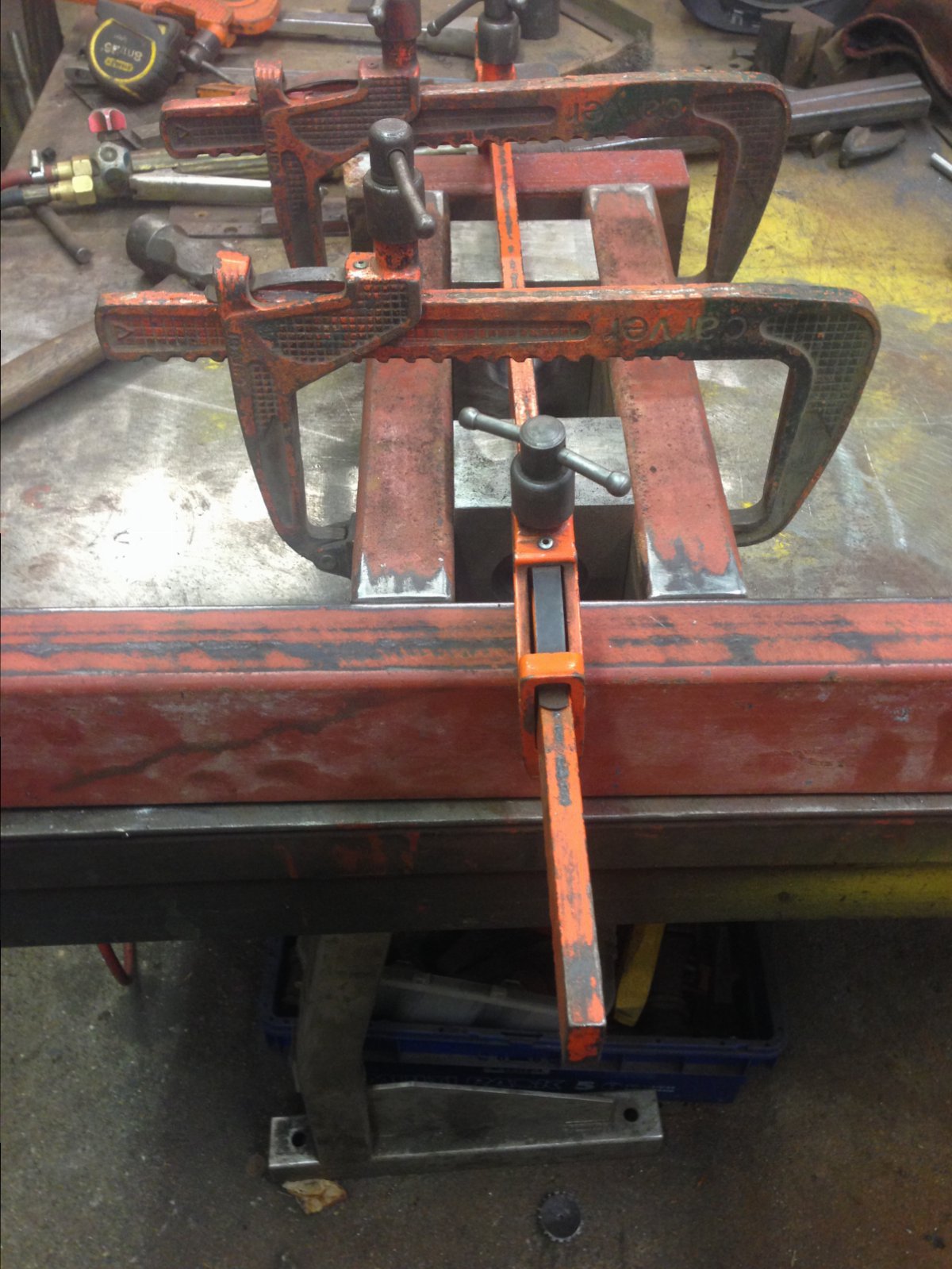

- The bottom rollers are too far apart, but due to the design this could not be improved
- Because I used a welded box section frame the moveable top roll isn't always square to the bottom rolls, this causes a twist in the material
