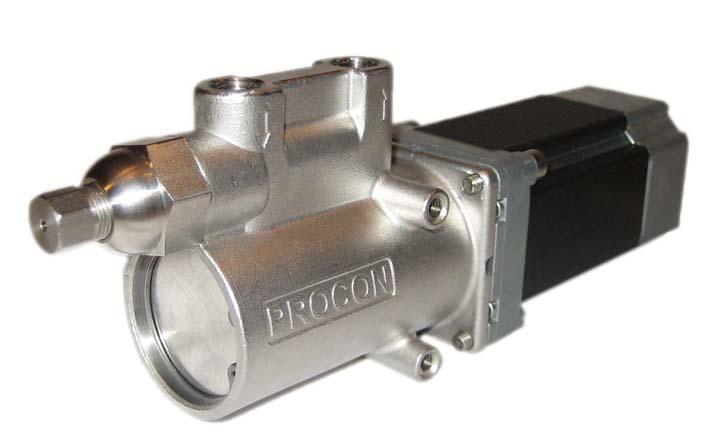

I’ve been looking around for a used procon micro-vane pump, the ones that are powered from a brushless permanent magnet motor, but they don’t seem to be on eBay anymore for £49... as such I’ve decided to try a 230v shower booster pump.
