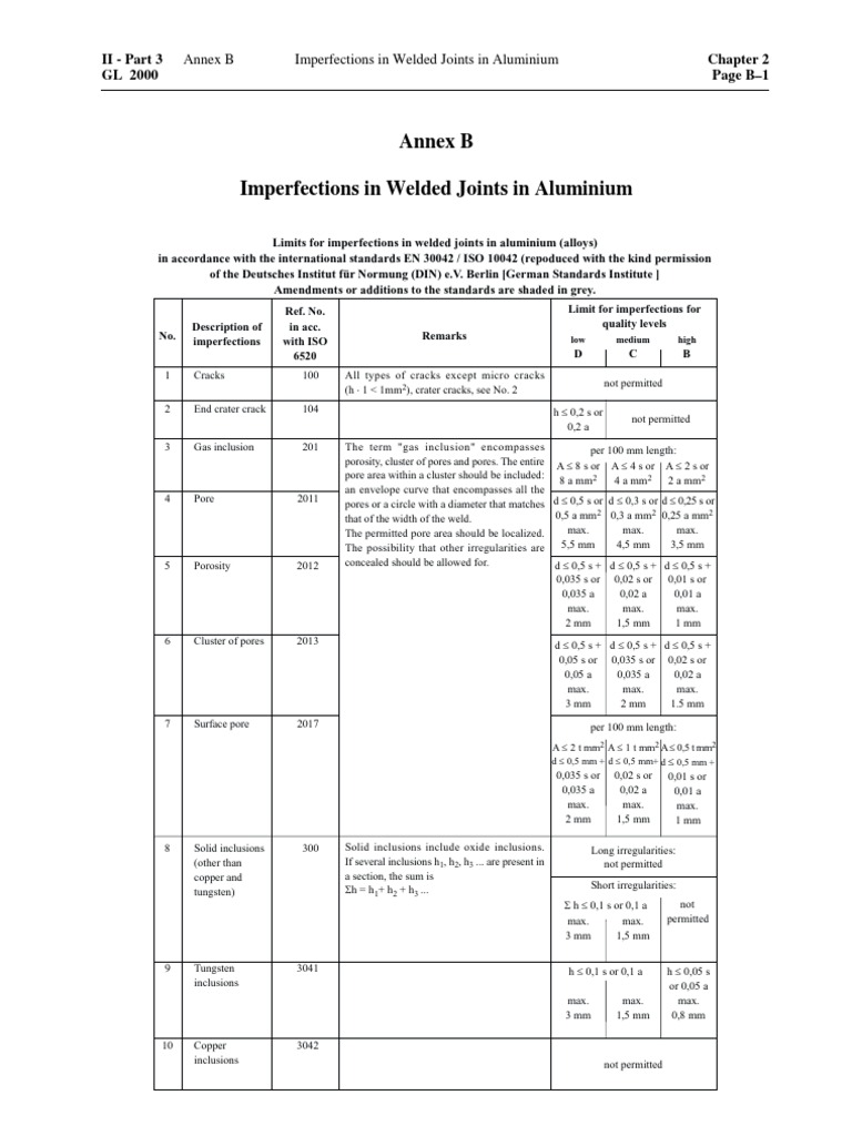

Anyone out there please tell me if they know any welders who can pass a dye-penned and then x-rayed weld on 28, 6mm thick 5083 aluminium.
It's a butt weld V'd out both sides.
I'm talking 100% pass rate on all welds in both tests.
I'm damned If I can, but that's what the boss is expecting ha.
I'm not sure what's deemed as a pass in any of these tests.
Are any pin holes allowed?
Just winging it at the mo.
Any help or thoughts on this would be very much appreciated thanks.
