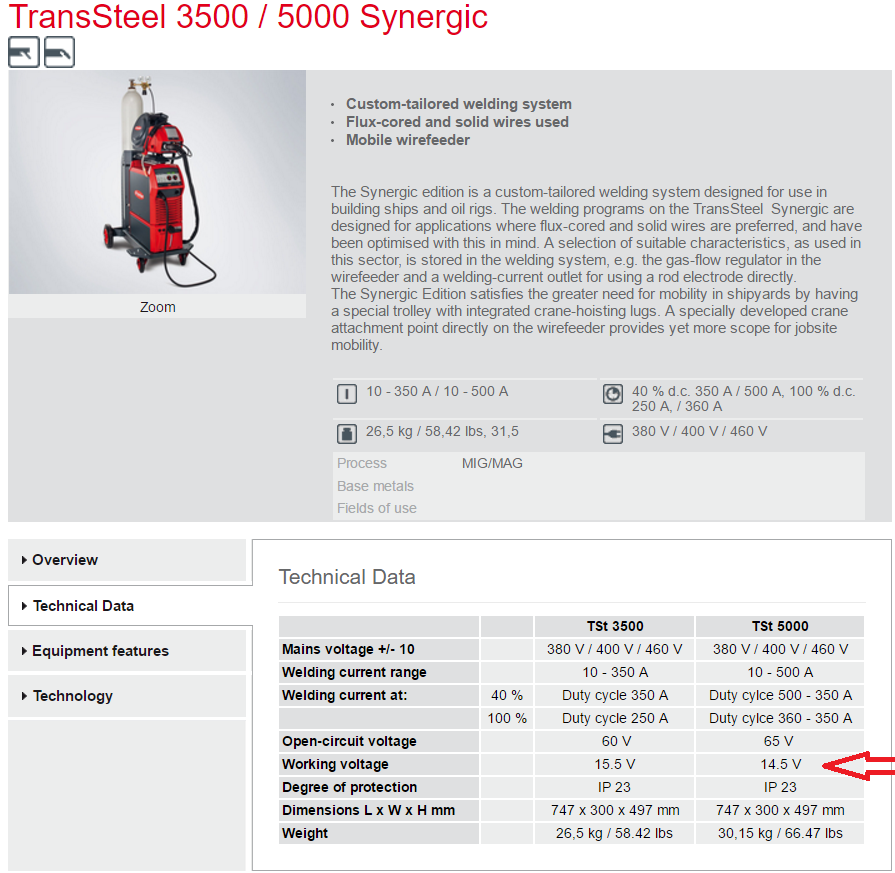

Hi. I am welding with the welding machine Fronius Transsteel 5000. The Working Voltage for the machine is 14,5 V. I am welding a lap joint, where both of the plates are 3 mm thick steel plates. I chose the parameters to be 3 for feeding and 19 Volt (The ampere adjusts automtically). I wonder if that is okay when the working voltage for the machine is 14,5 V?. The welding is continously ongoing for 50 minutes ( A robot does the welding). I am a beginner so feel free to give any other advise for my parameters. Is the voltage to high?
