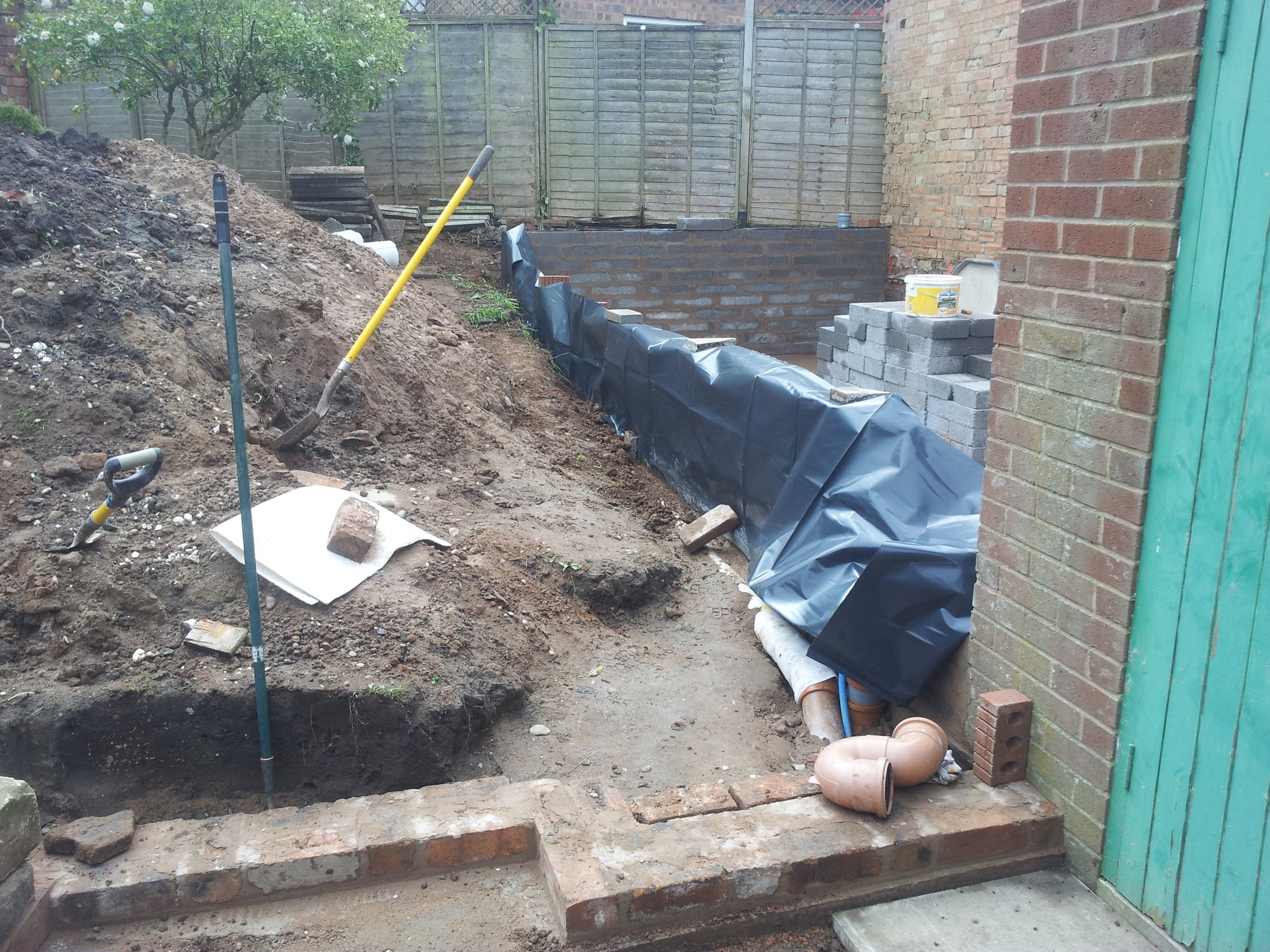

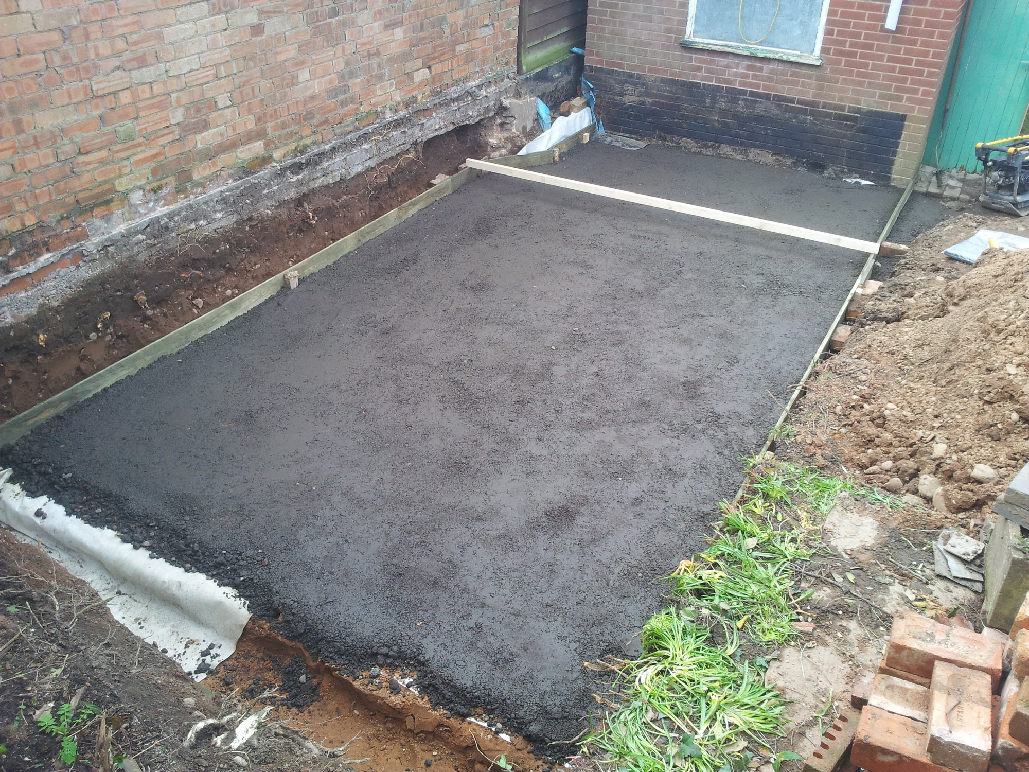

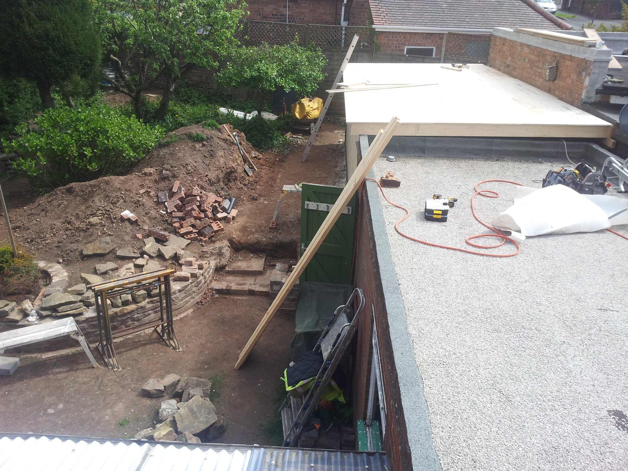

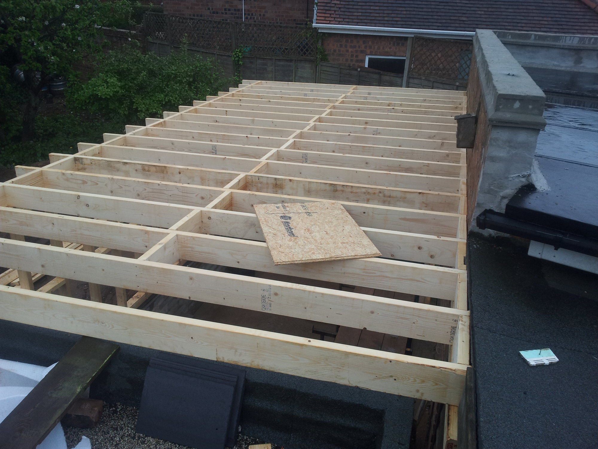

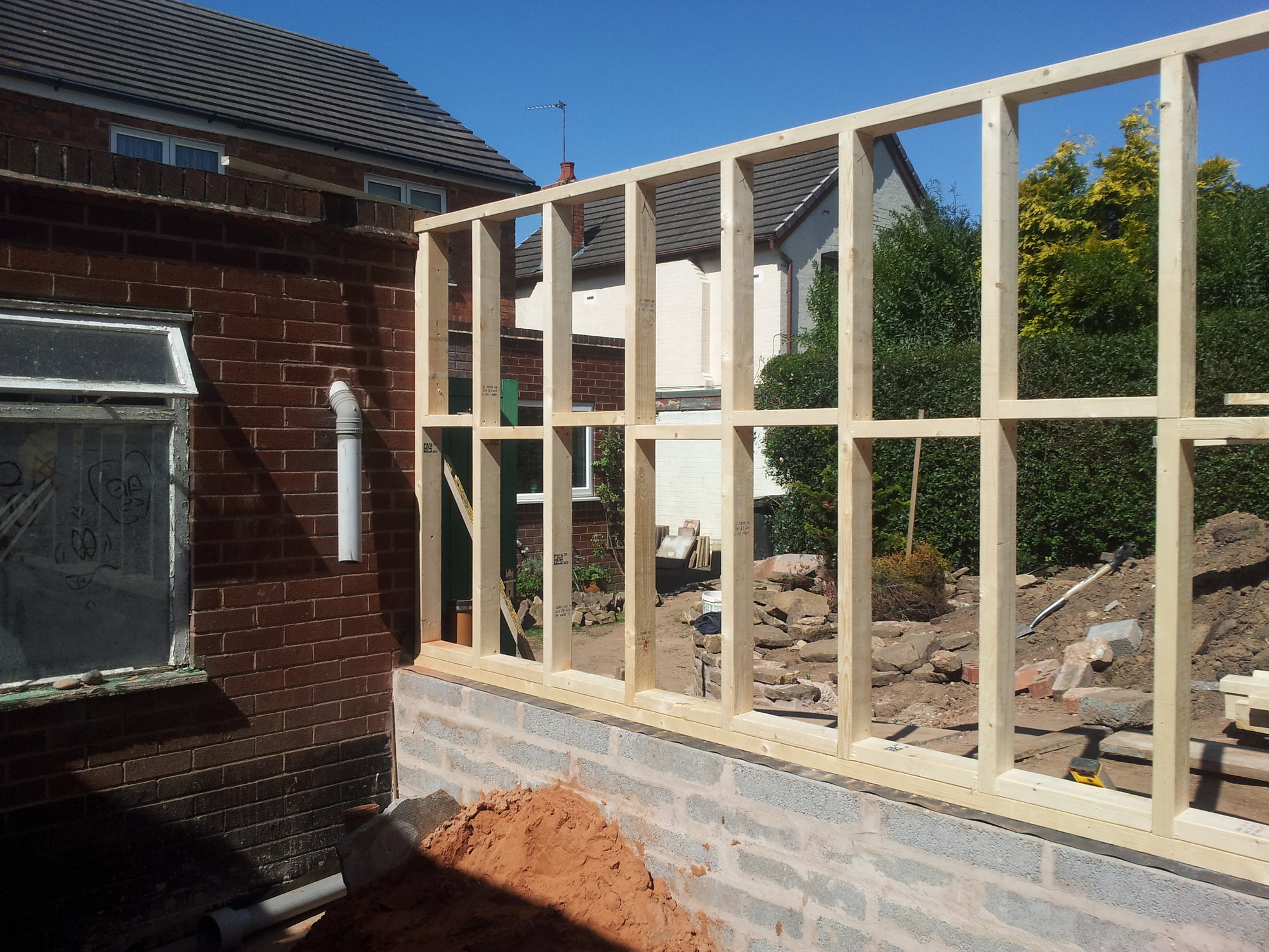

This is next door we did for my mates dad to get him more room when he moved into the house, It was a bit of dead space at the back of my garage and his garage and it was un even heights as we live at the bottom of a hill.

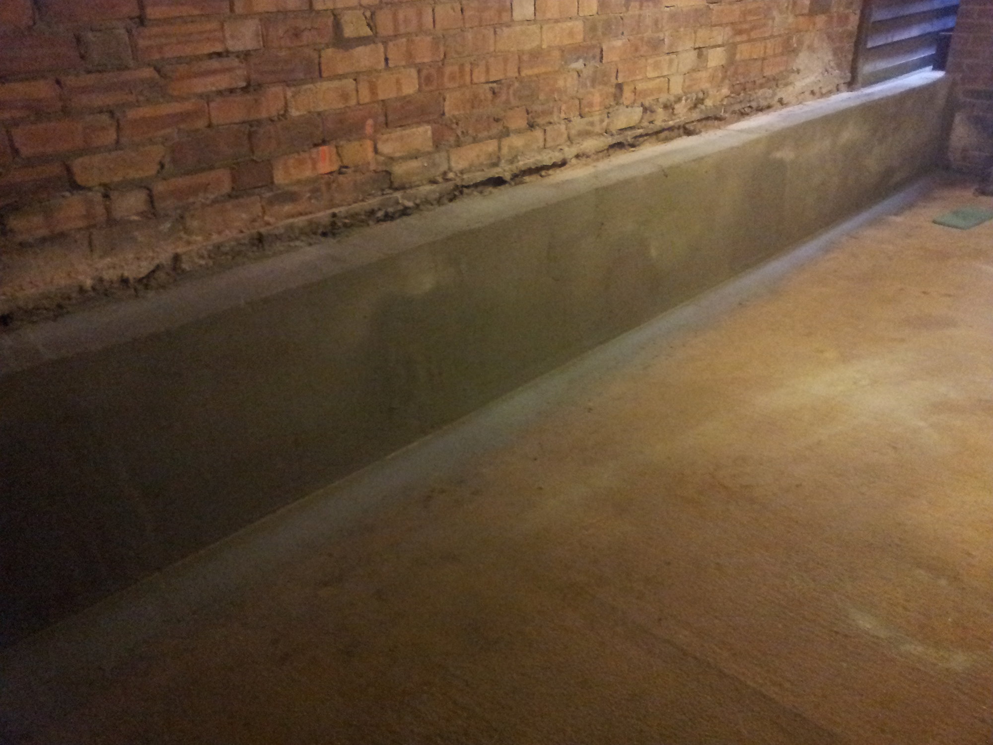

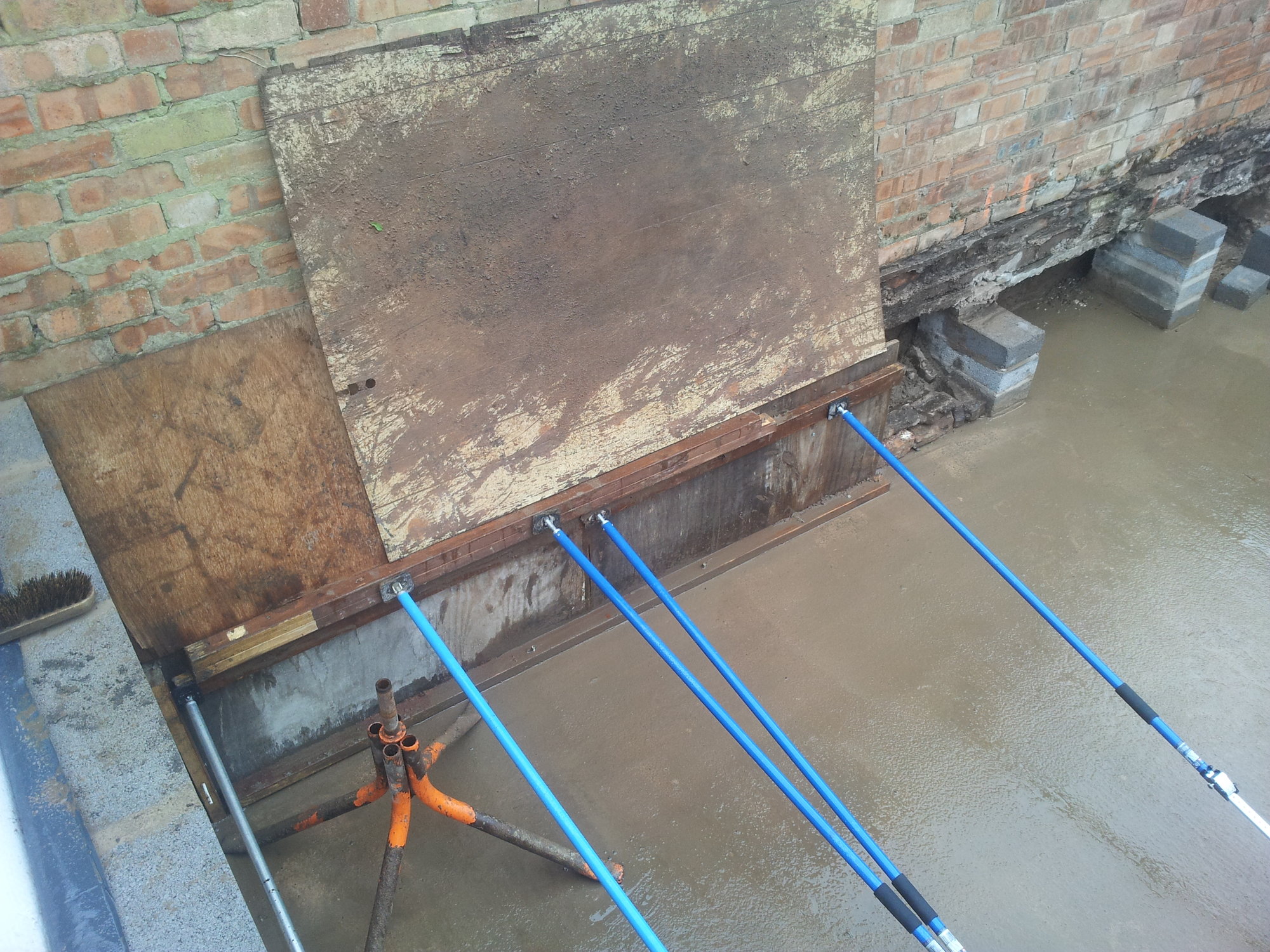

Concrete put down on a very wet day

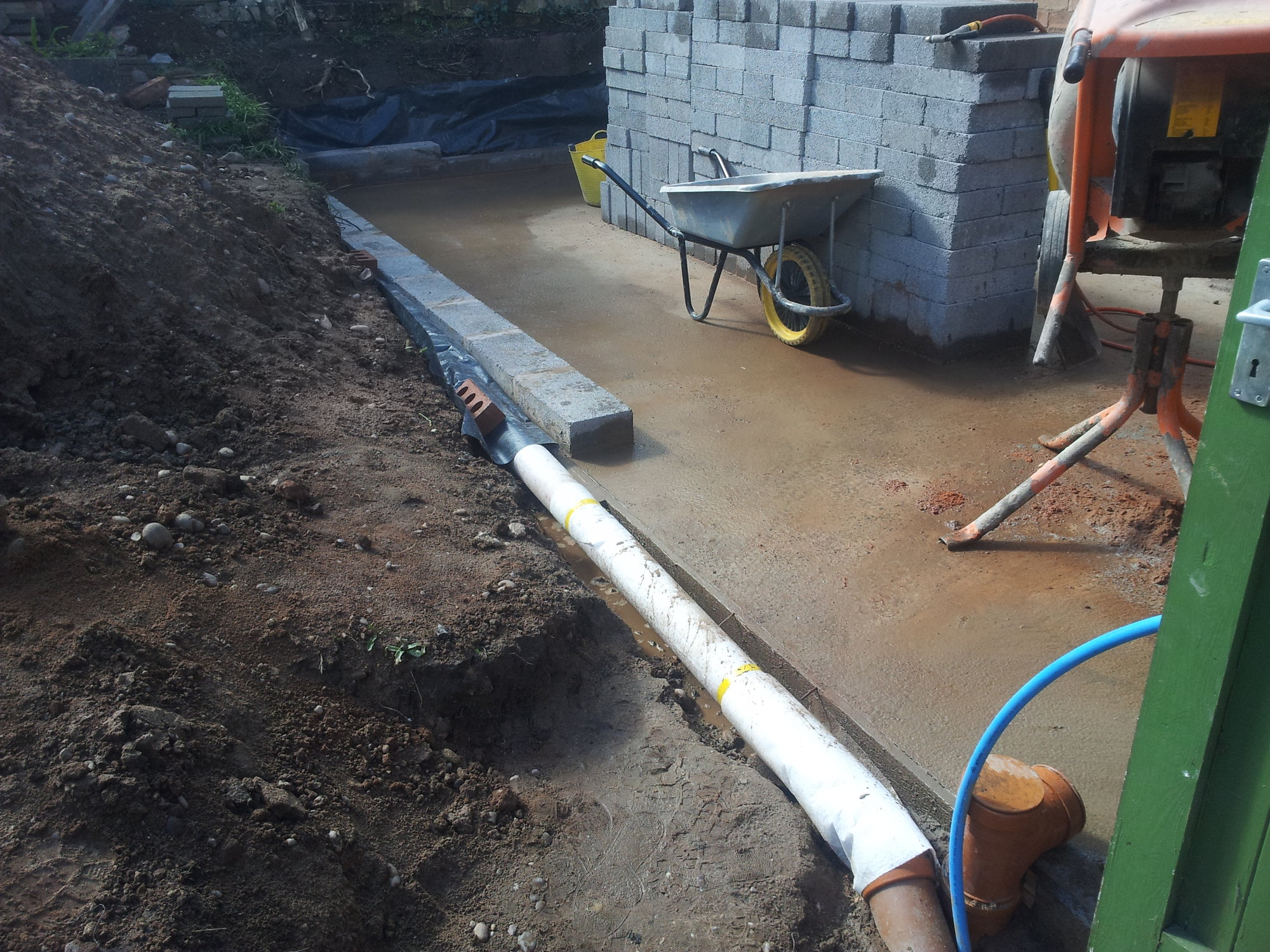

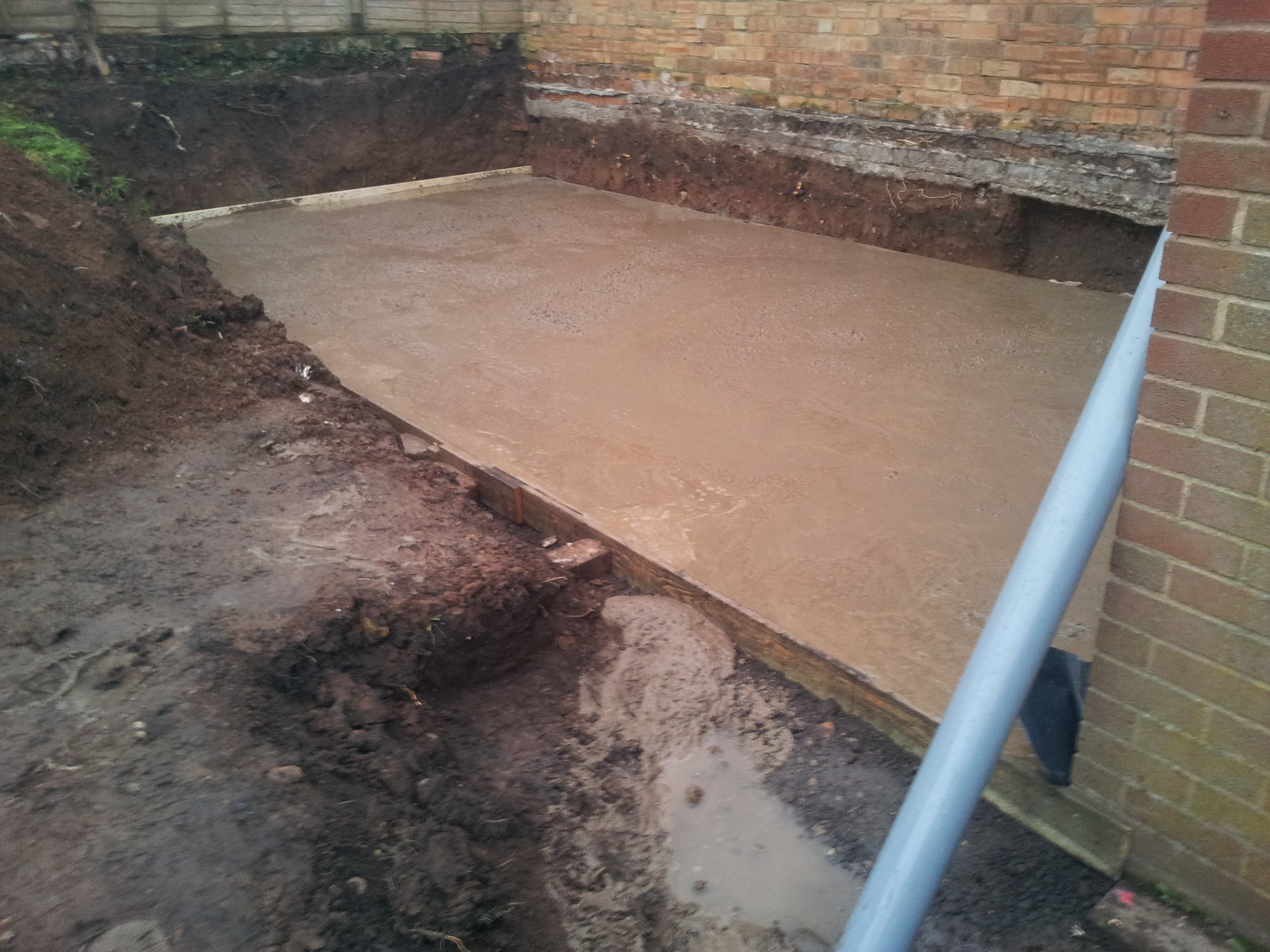

We ran a slotted 4" pipe all the way round from the back to try and keep the ground dry

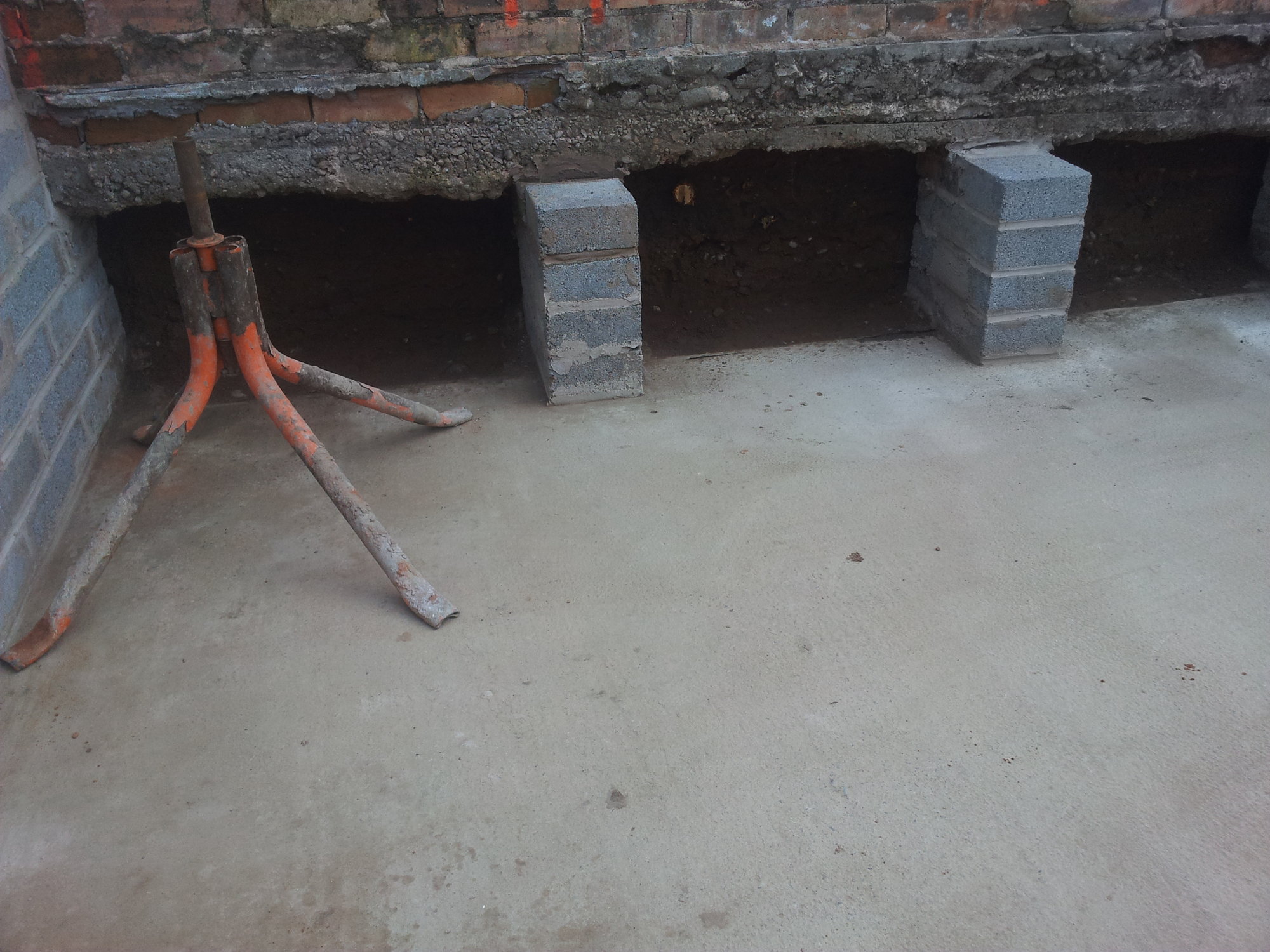

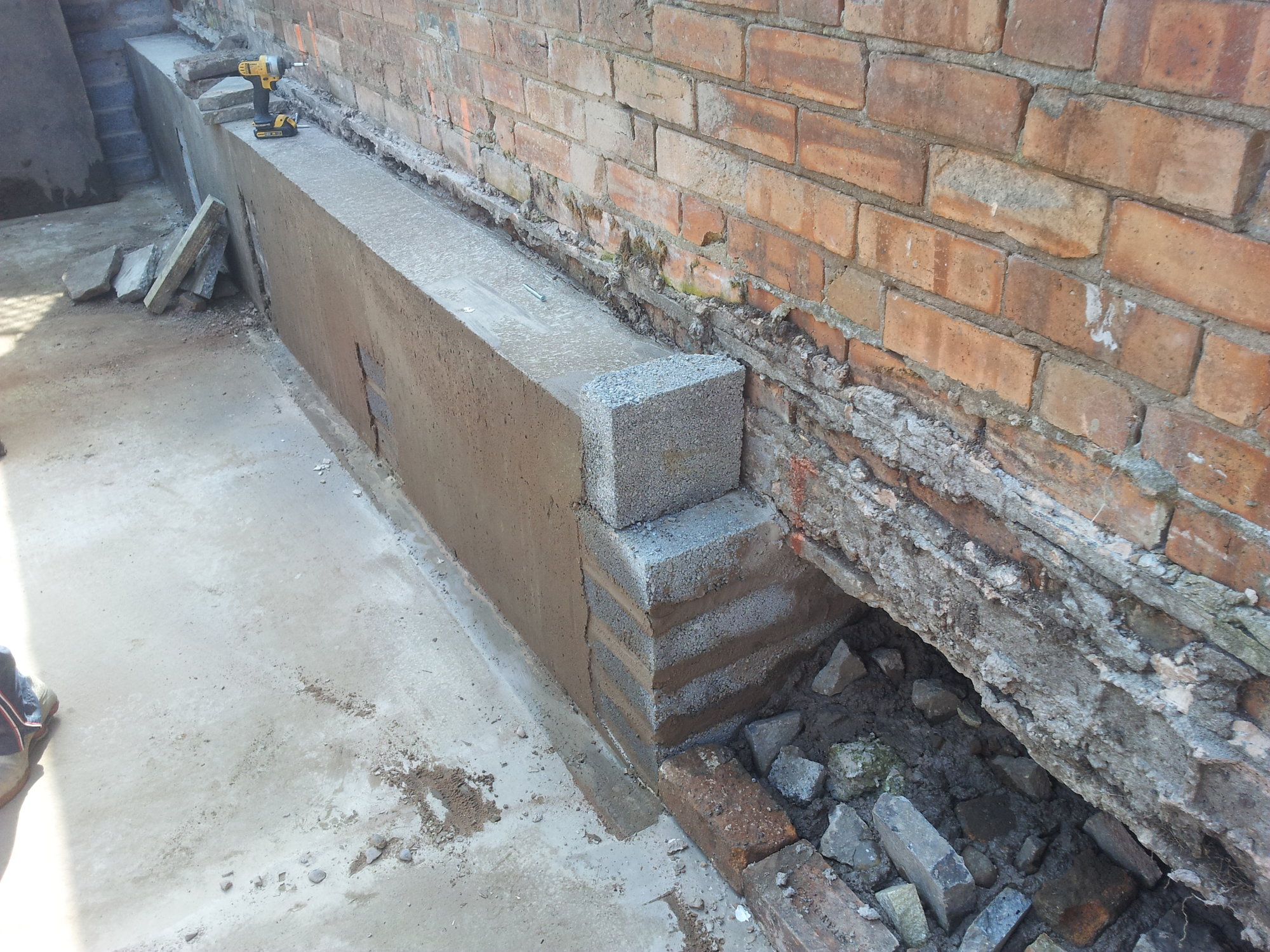

Although my garage has a 12" thick concrete floor we added some extra footing
