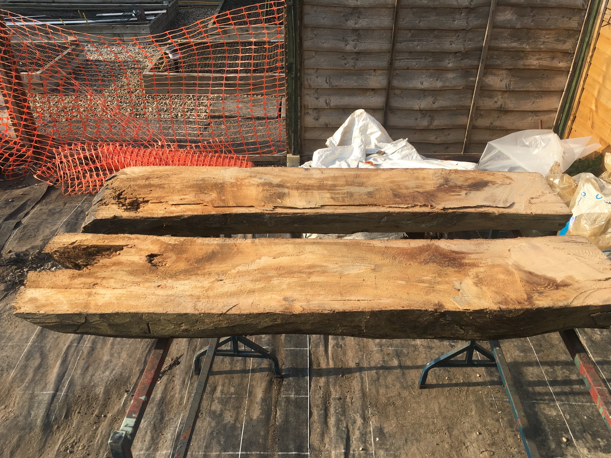

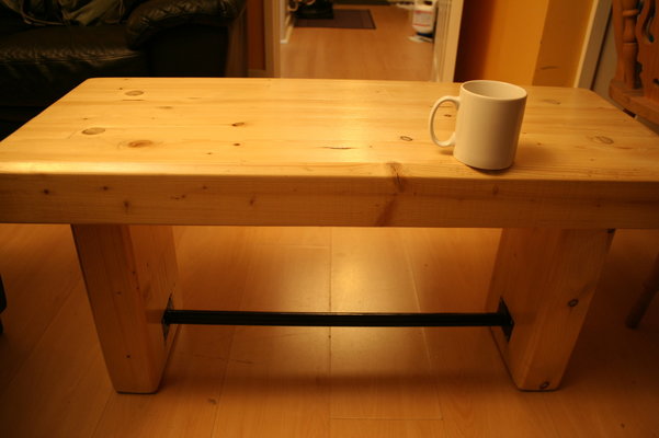

    Some time ago I was given two huge lumps of wood that came out of an old house during renovation, I’m told they were “king purlins” :dontknow:
    Anyway, one now has pride of place above our fireplace and the other has been sat waiting for me to decide what to do with it.

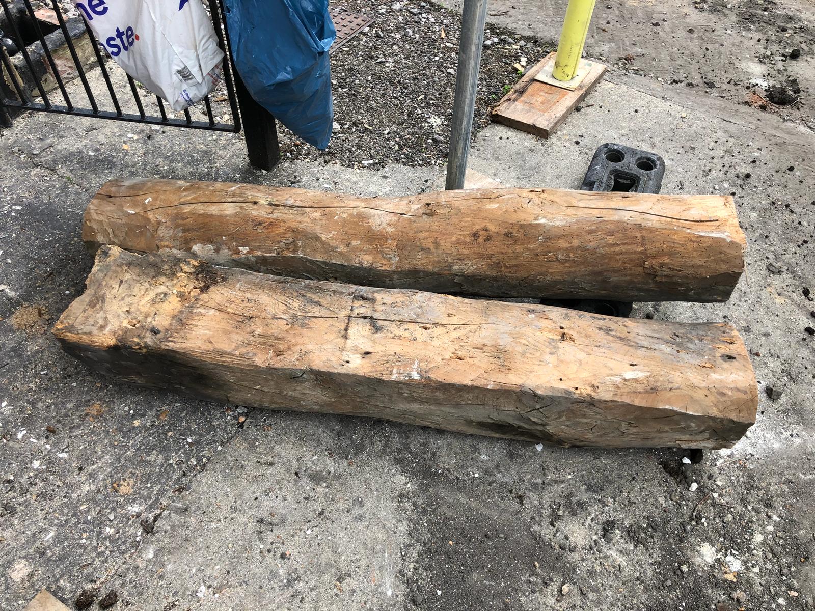

    Here’s the two before I got them, this is the photo I was sent when I was asked if I wanted them. It's the nearer of the two. D95A2CD1-FD86-4388-BF7B-EECF03123AE9.jpeg

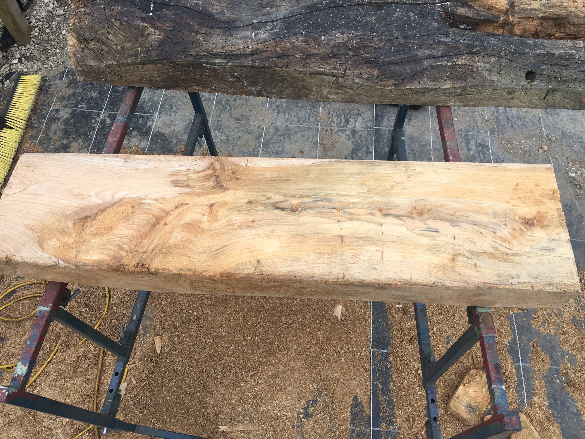

    Set to work yesterday cutting it down the middle lengthways with a hand saw.... only took about 90 mins.:laughing: F804FAF4-6080-4223-8D73-852FE4613665.jpeg
    Ran the planer over the surface and cut one of the lengths in two to make the legs. 3B6640E9-C4BC-4E7F-B4AE-46D556446D7E.jpeg

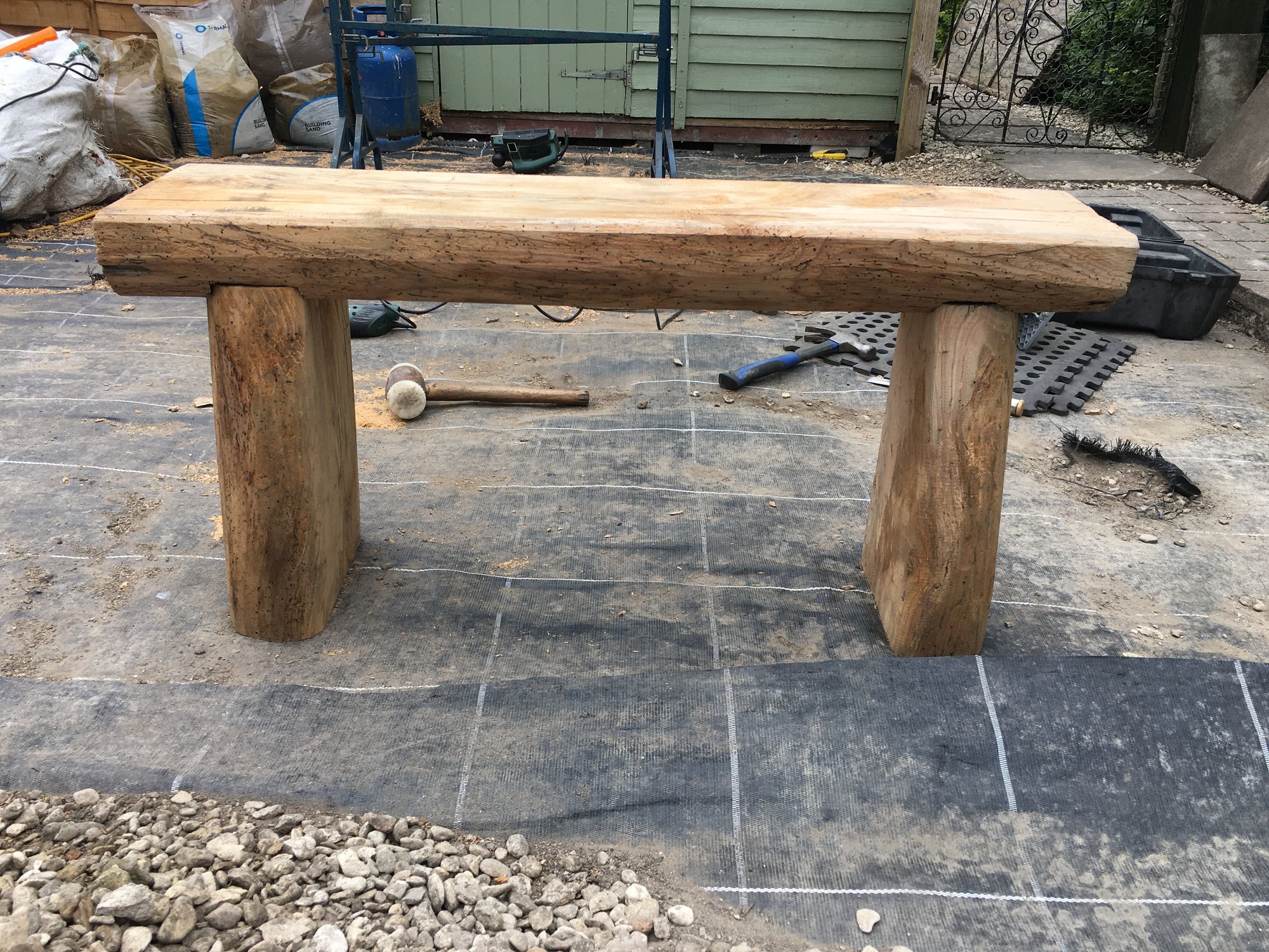

    Rebated the underside so the legs sit nicely in it.
    This is where I am with it so far, it needs sanding and finishing.
    It also needs the legs firmly attaching. 66A25079-1882-4748-8715-774E317AC5DA.jpeg
    I was thinking of using allthread, welding nuts on the top and shaping them into domes which I’d paint black then cut some cutouts in the inside face of the legs to access the nuts in order to pull everything tight but ideally I’d like to use some sort of invisible method.
    Any suggestions?

    Dowels ?

    Stick a cross bar between the legs Warren. Will make it stronger and less likely to stress the top fixings.

    Do you think dowels would be strong enough?
    My neighbour suggested that and cross-bracing the legs but I want to keep it as minimal as possible.

    Counter bore under the legs with a flat bit, then use a couple of gert big screws :laughing: Coach screws or the modern equivalent that have much more bite...easy to tighten if need be.
    Or, how about drill through the top, and well into the legs, get your best broom and cut 4 bits off the handle...knock in and saw flush with some glue.
    Add a brace if it's still wobbly...

    A bit of flat in an arch style adds a lot of stability, not quite as chunky as timber bracing

    Should be if you use a big enough dowel. But agree that a cross brace would be a good idea. Maybe do the brace in stainless as a contrast
    An arch would look good as @Hitch suggested.

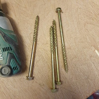

    These are decent. Much much better than the old fashioned coach screw.

    Those and a couple of broomstick dowels hidden inside would be my choice

    Those screws up from underneath, skewed? Got plenty of steel stock here so can make up a decent looking brace at it sounds like the way to go.

    As others have suggested; if you get creative with some style of
    stretcher, the dowels would be fine to locate and hold the top.
    Make the dowels an interfernce fit and you probably don't even
    need to glue them.
    Nice job

    I used pieces of broomstick as dowels on one that I made from some 90mm thick timbers that someone between here & Bristol uses as firewood.
    His old man gets them from his work - they're timbers for making big rooves.
    I also used a piece of round tube and cut a couple of square ends as a stretcher.
    I don't think I was originally going to but I didn't feel as if they'd keep a stable gap forever, with dowels alone.

    That’s exactly what I’ve now got in mind Joe, thanks.
