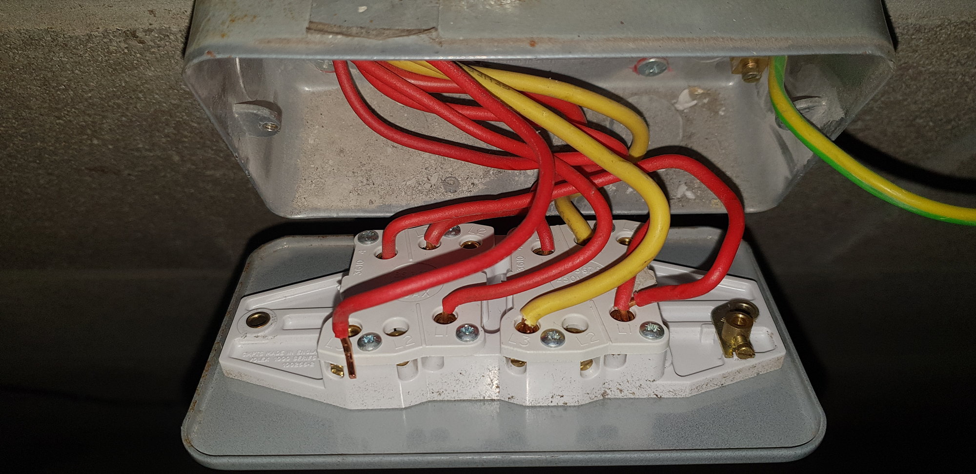

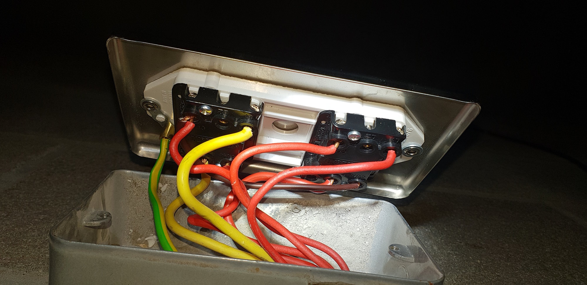

if its a 4 gang switch there will be 4 commons . each switch has a common a live one and a live 2 . each switch is a 2 way . depending on the make some are better than others with a larger hole for cables .10 amp
yep god that's an oldy cant remember when I last saw oneNew at top - old bottom
I hope the new one lasts as long, i have to change one i fitted last week, keeps making lots of arcing and crackling noises during switching the huge 0.5A led lighting load.That is why the switches have finally failed then! All stuck on - been switching them on and off using the breakers - not ideal.
