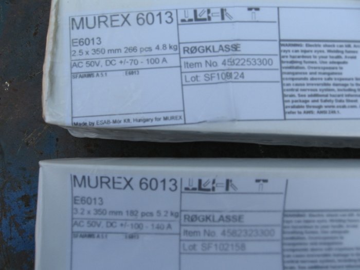

thats expensive i got 2 full boxes of 3.2 boss welding rods free the heating engineers left em in the boiler house at a school i work at sumtimes .2 month after job was finished they were still warm so i relieved them verry nice rods . and they were in a white boxLot of chat about rods from Lidl. Bought some Murex white box 3.2's & 2.4's - £15 + vat ea.
Works out at:
2.4's - £18.00 / 266 = 6.7p ea.
3.2's - £18.00 / 182 = 9.8p ea.

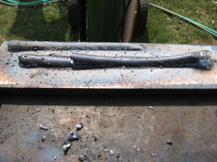

Today’s unholy effort...

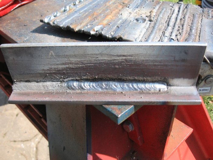

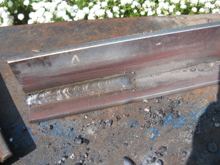

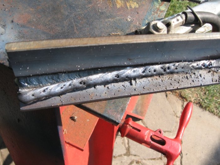

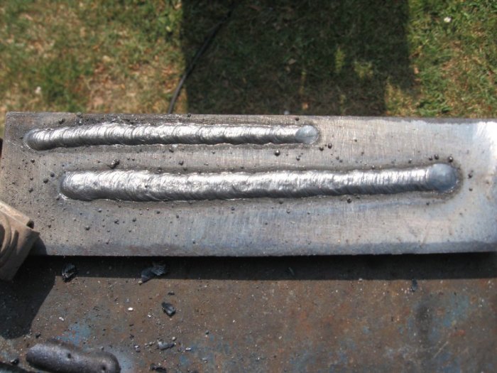

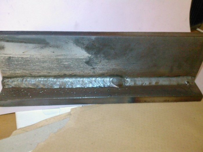

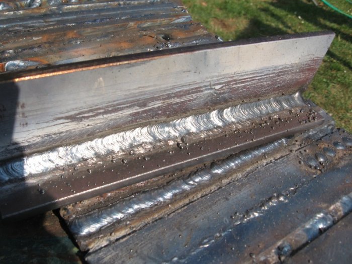

These electrodes came from Screwfix and strike me as a real bargain. There was only one review on their website and it said the rods were the worst he'd ever used, so that's why I decided to try them. The reviewer is probably a troll from a competitor..
I've tried the Screwfix 2.5mm electrodes and still have a lot to use up. I wasn't impressed, the coating is uneven and with gouges sometimes. The slag seems thick and hard. I don't like them.
Now, they are not 6013s, they are J422s which is titania-lime not titania-cellulose and I think they are a cross between a 6013 and a 7014. At least the ones I bought were J422s with a dark coating.

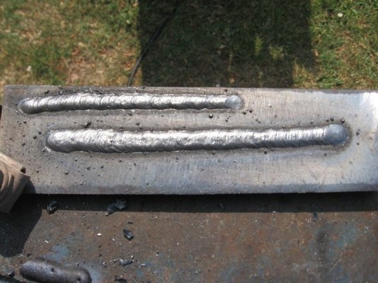

The nicest 6013 2.5mm rods I've used are Elga P45S and the difference between them and the Screwfix offering is huge. Admittedly, the price difference (3x) is also huge, but not a case of diminishing returns.
Looking at the Screwfix site, there seem to be positive reviews of the 2 and 2.5mm rods, but the 3.2mm rods get slagged off.
I didn't post a review but I thought they were poor and poor value for money. Having tried the 2.5 mms I shan't be chancing my arm with their 2s or 3.2s.

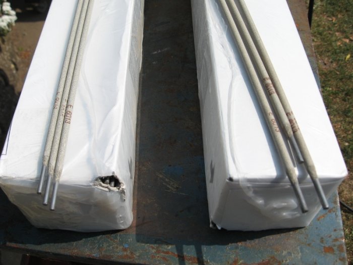

They came in a white box with nothing printed on, inside a brown cardboard sleeve, with the name of a company and product code. It also says "Welding rods 2.5mm 5Kg". No recommended applications, current, polarity, OCV, positions. No H&S warnings or storage instructions. In fact no details at all.
The rods only have J422 marked on them. They are rather dark for 6013s. They are 300mm.
The wire doesn't seem particularly round, could just be the cropping. The coating is quite thick in comparison with other 6013s and occasionally there's one with a chip out of the coating or a gouge in it. Sometimes the wire is exposed.
