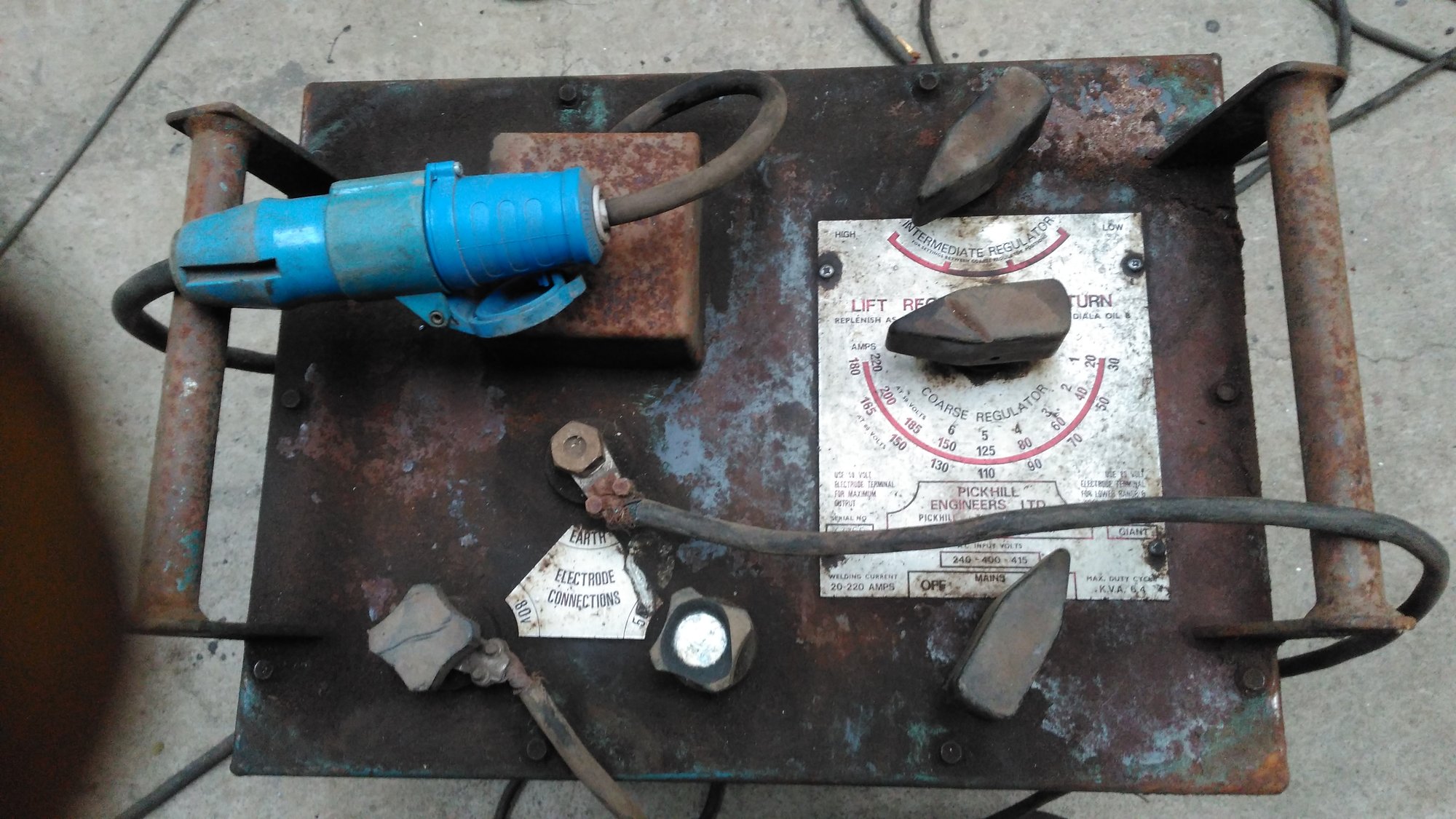

Not really. The advantages of 3.2 are really based around smaller rods having a tendency to throw a little arc wonder into the mix. This usually results in a slag trap. I dunno why but a bigger rod just seems more stable and I always try to use a 3.2 over a 2.5 if the material can cope with it.am I right in thinking 3.2 rods would make it easier to strike because you're using higher power setting?
Another advantage of a 3.2 over a 2.5 is it has a higher ratio of filler to flux so there is less flux around to cause slag traps!
Oh they will.Easy peasy mate use the 80volt output 56s wont light up on 50v ac
95 to 125 for amps
Aye but thats ac not dcOh they will.
I have an old first generation magic wave. These had a low ocv of 48 v.
It eats 56s no problem.
The trans tig version also 48 v was an excellent cel runner with 6010’s.
Ah yes. I see you put ac. My mistakeAye but thats ac not dc
