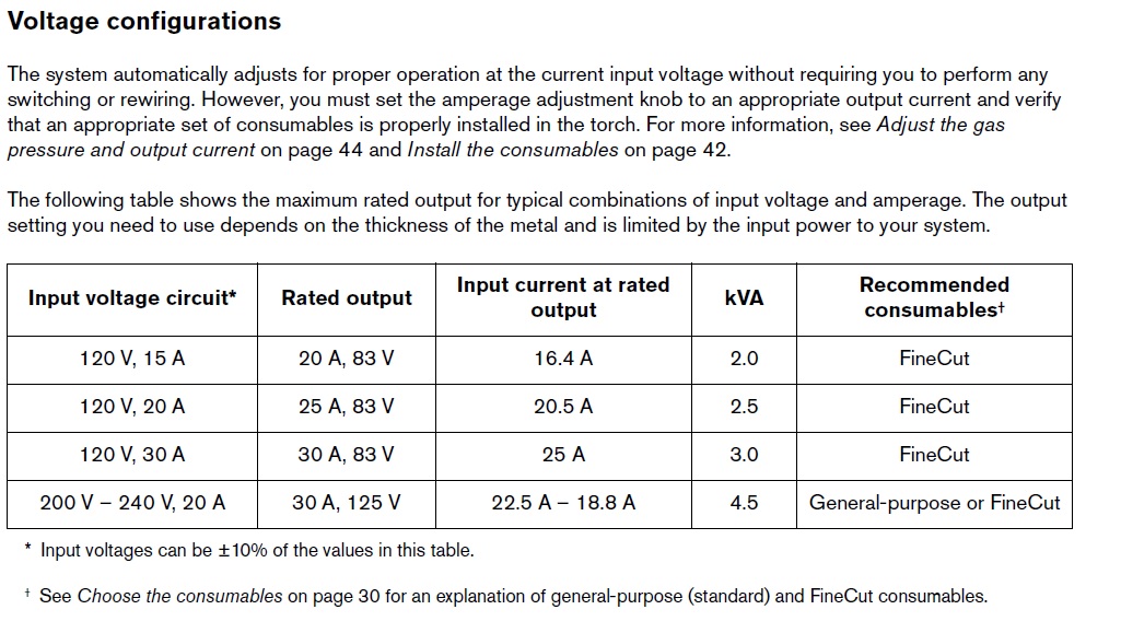

    After reading lots of forum posts watched hours of video's I think I am going to stretch the boat on a Hypertherm 30XP as it will suit my needs perfectly. Now a question for other 30XP users I see that the 30XP comes with this really weird 220Volt plug "NEMA 6-50P" what do you guys do for a a power feed. I am slightly worried that the power feed to my garage will not be able to cope with it's need. My garage is about 25 Metres away from my house it was fitted with a Armoured cable Twin cable the armour is used as earth I measured the thickness and it is about 1.5mm rated around 27Amps acording to sources online further considerations is distance and weather it is in a duct or buried mine is definitely just buried.
    Now it is not something I can just upgrade as I could probably buy 4 X Hypertherm 45XP's for the cost of upgrading the feed to the garage as it is under Tarmac and I cant see a duct as at both ends it just seem to materialise from the ground. and it sounds like these babies need some serious amperage.
    So I am keen to know what other 30XP users use for wall sockets etc. I was considering replacing the plug with a 32 amp socket but would like to hear what others have done
    Thanks in advance
    The specs from the manual is a bit ambiguous.
    From the manual
    Cutting a thicker workpiece with the general-purpose (standard) consumables requires a higher amperage setting. It
    is preferable to operate on a higher rated circuit (240 V / 30 A) when cutting thicker metal. See Voltage
    configurations on page 23.
    Referencing again the below
    skotl likes this.

    The input current is over 16A so I would say definitely fit a 30A plug (and cable)
    You'll likely be drawing much less than 16A most of the time but. for the price of the unit, you should put in the cabling that will support it across its range.

    You're pretty much answering your own question then.
    Do you have the run in the garage already, that will support a 16A socket? If so, go for it. It will likely be fine, And, if you've fitted a 16A MCB, then it should trip at the first sign of panic.

    You asked whether you could get away with a 16A socket on a machine rated at 18A and above, and we gave you some options.
    I presume that you're as capable as the rest of us in reading machine rating plates, so I'll duck out now. Best of luck.

    Yes the supply in the Garage is a 2 core SWA 1.5mm thickness which is about 25 amps buried I need to check the run from the distribution board to the SWA Termination in the house as the neon lights flicker when the Mega 350 runs so will keep a close eye on the voltage drop, once I have done some upgrades I will run most of these off a 20 amp breaker.
