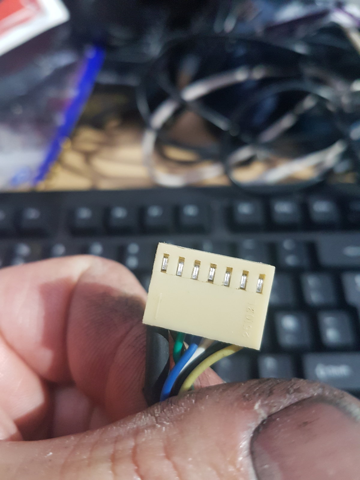

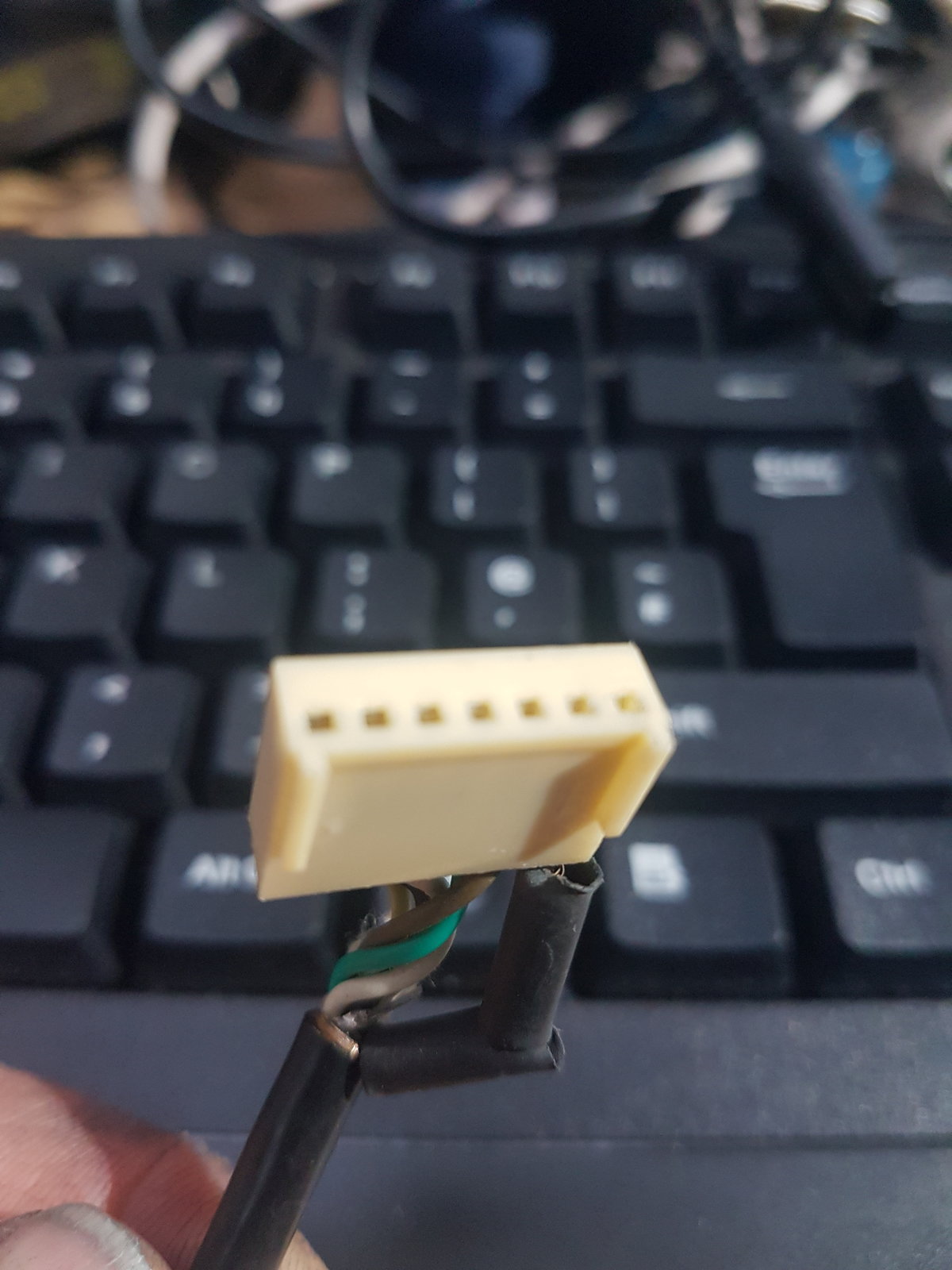

U ukracer Forum Supporter Messages 16,247 Jan 25, 2019 #1 Whats this type of connector called. I seem to have lost a cable. Same on both ends.
WorkshopChris Member Messages 5,049 Location South East Essex Jan 25, 2019 #2 Possibly https://en.wikipedia.org/wiki/JST_connector You would need to confirm with a data sheet, whats if off of?

Seadog Save the planet. It's the only one with rum! Messages 11,448 Location NE London - UK Jan 25, 2019 #3 It's a Molex.

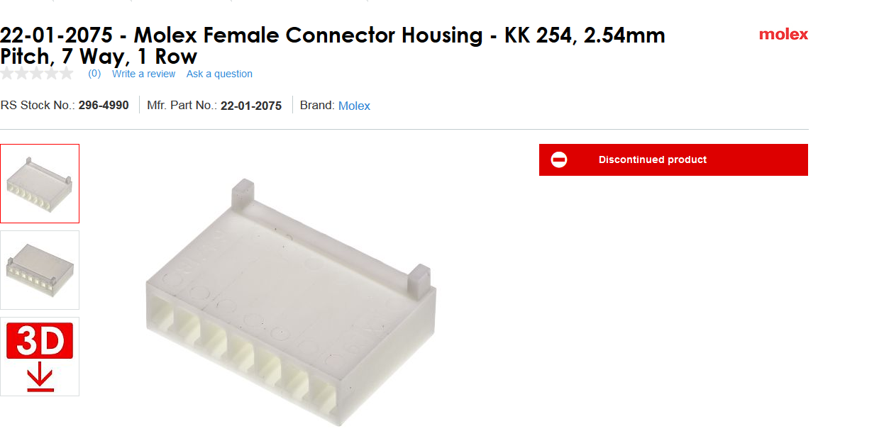

Seadog Save the planet. It's the only one with rum! Messages 11,448 Location NE London - UK Jan 25, 2019 #4 https://uk.rs-online.com/web/p/pcb-connector-housings/2964990/
U ukracer Forum Supporter Messages 16,247 Jan 25, 2019 #5 Seadog said: https://uk.rs-online.com/web/p/pcb-connector-housings/2964990/ Click to expand... LOL cheers lads I thought it was molex but searching molex was a minefield .

AndersK Member Messages 1,490 Location Sweden Jan 25, 2019 #6 Molex is a company making lots of different stuff.
U ukracer Forum Supporter Messages 16,247 Jan 25, 2019 #7 AndersK said: Molex is a company making lots of different stuff. Click to expand... Yeah that was confirmed when i put molex in ebay..lol
