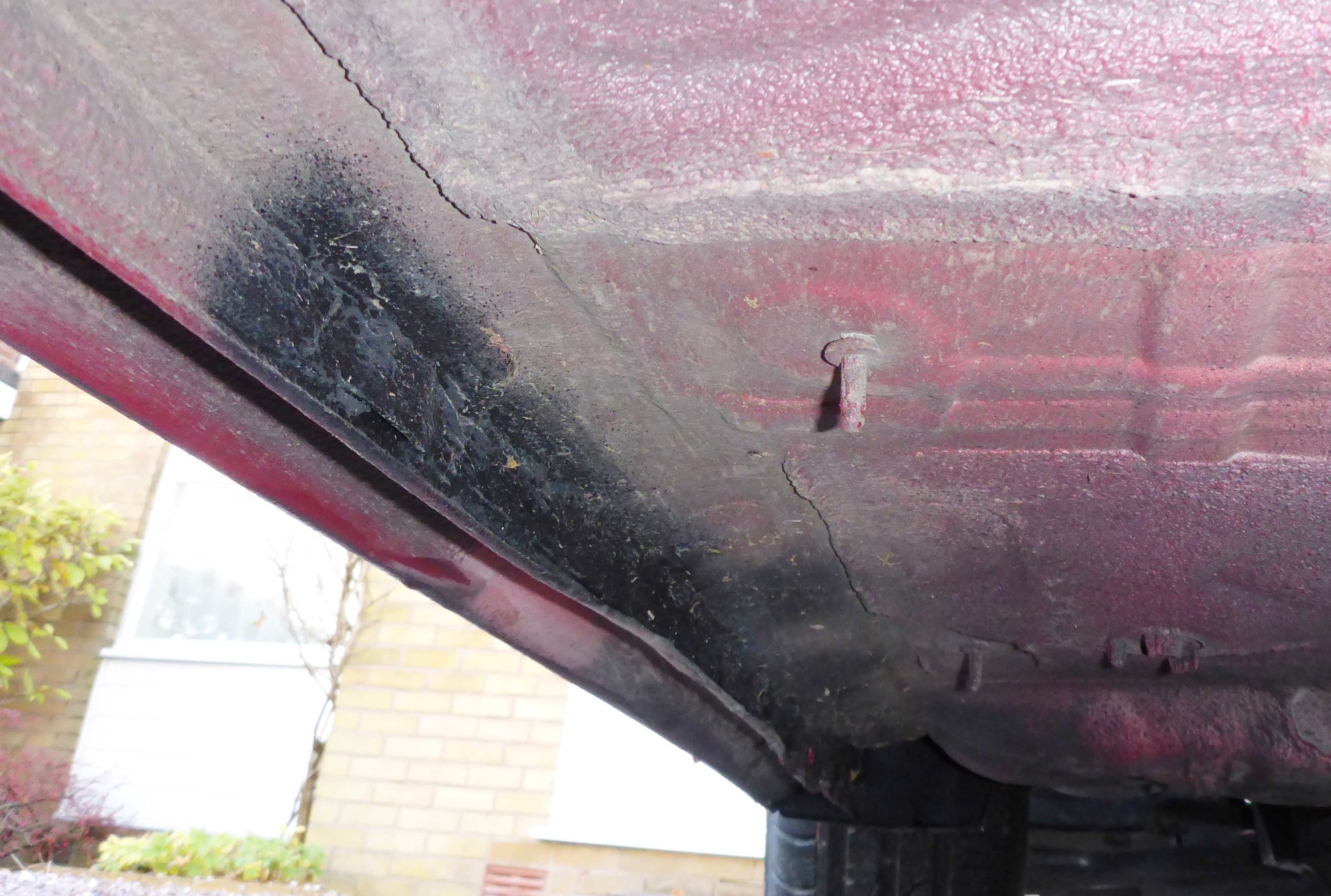

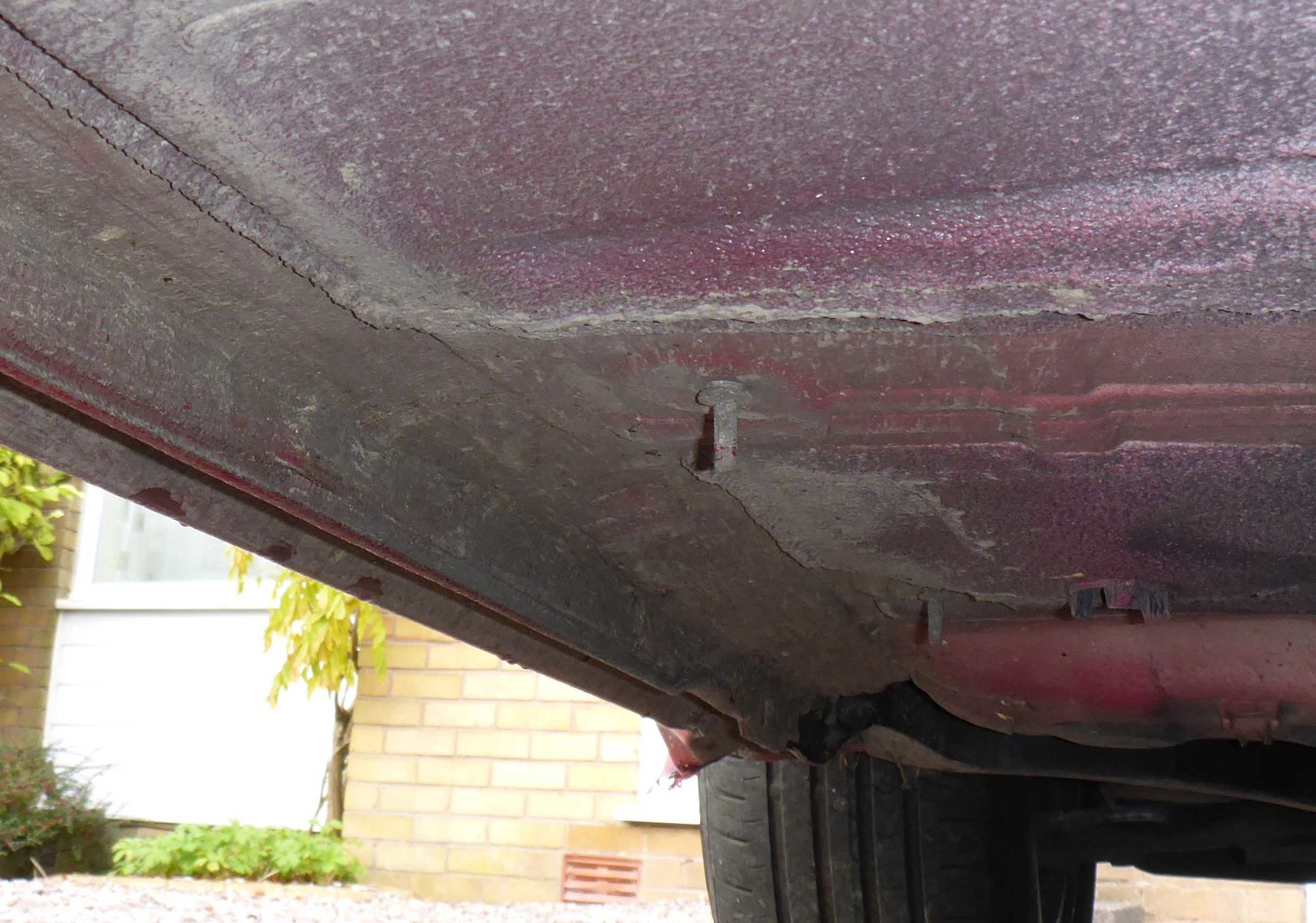

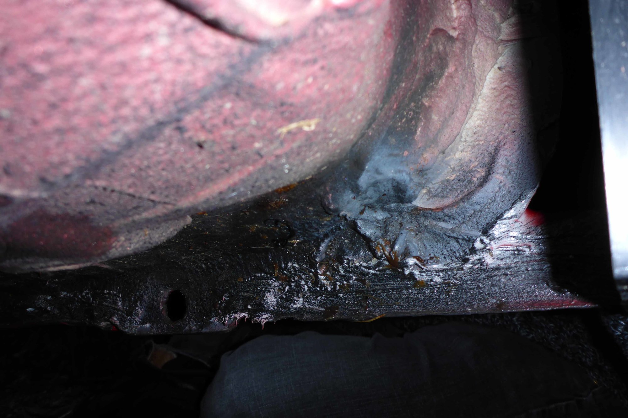

    Hi. I know absolutely nothing about welding but need some advice. I thought that this forum would be a good place to get some. Am I wrong?
    Basically I need to identify what sort of weld has been done to my car, and how I can know if the quality is any good?
    My car had a sill (rocker panel) crushed and rather than replace the entire sill the insurance repairer cut out the damaged section and welded a new section in.
    I have never seen a weld that looks like this, nor the blue colour of what looks like oxidation or soot.
    It also looks like lots of heat has been used as smoke deposits cover the underside.
    From the pictures does anyone have any ideas what type of weld it is and why it looks like blue oxidation? The car is a 3 year old C4, so high strenghth steel is involved, or supposed to be.

    more like spot welded and seam sealed up afterwards is what id think it would be

    Hi, I agree with the above, I would say the blue tinge is from an aerosol of blue paint flicked over the repair before the application of the seam sealer/underseal.

    Hi, If they have cut out and replaced the crushed bit of sill then the patch repair should be seam welded, although the bottom edge can be spot, puddle or seam welded because it's an original panel join. As it's had the application of filler, seam sealer or underseal and paint there's no real way of knowing without stripping it all off to find out. You will then have to pay to have it painted again because I would imagine the repairers won't do it again without being paid. In short you will have to take it on trust.

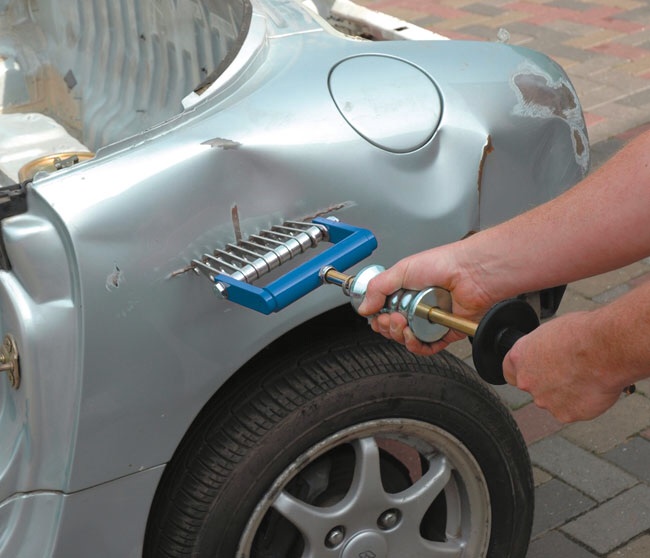

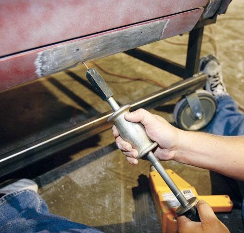

    image.jpg image.jpg As already said it looks like seam sealer and (Iam no expert far from it) looks like it's the original seam sealer, when I hit a rock that a nieghbour had put there to stop people parking on thier verge,( that'll learn me!) I put a severe dint in my sill of my old Astra van, my mate at the body shop welden on some little cleats to the cill and pulled it out with a puller (see photos similar) are you sure that they have welded anything? And or if they have it's probably on the front.
    does the seam sealer look the same on the opposite side of the car?

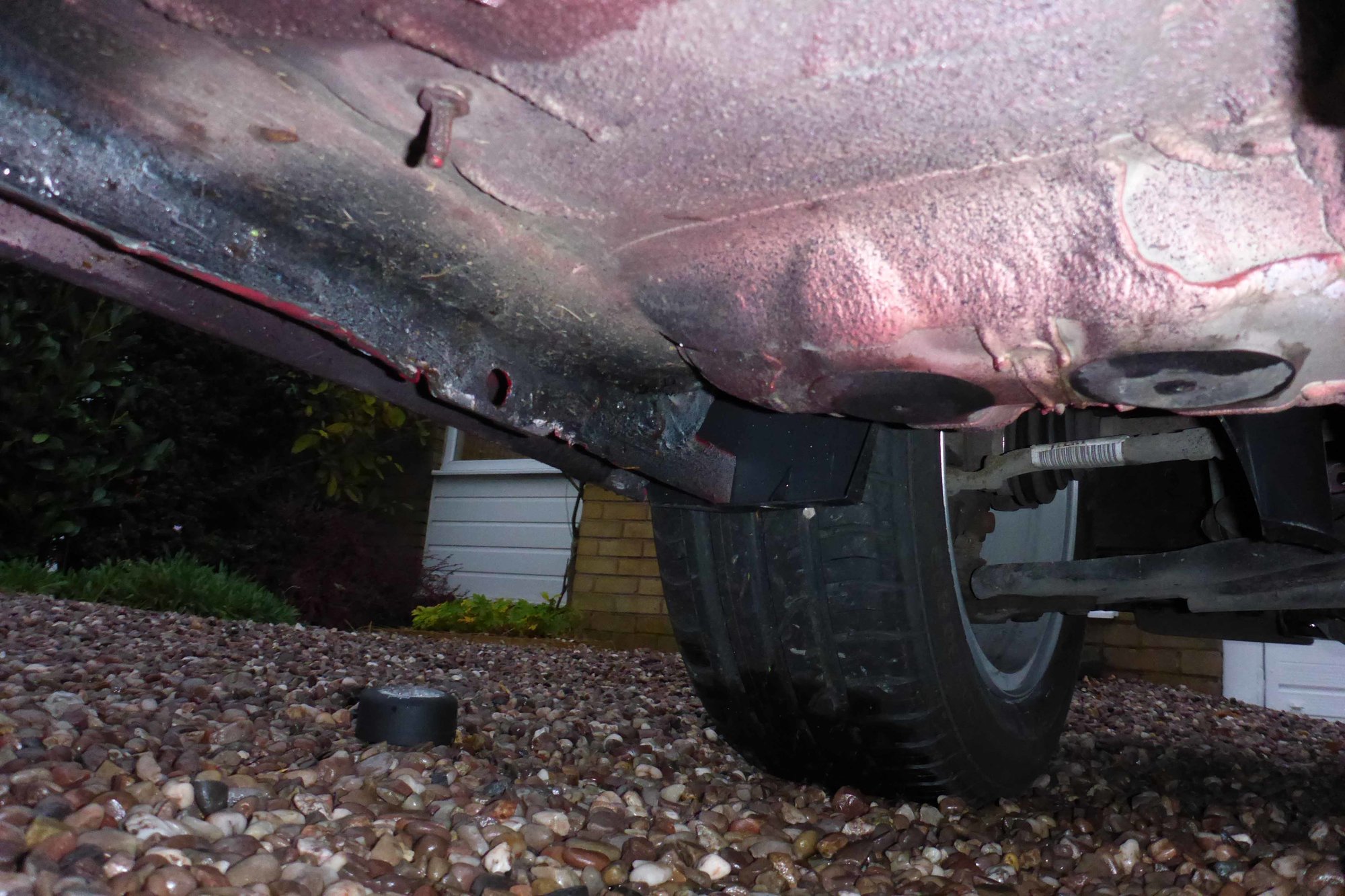

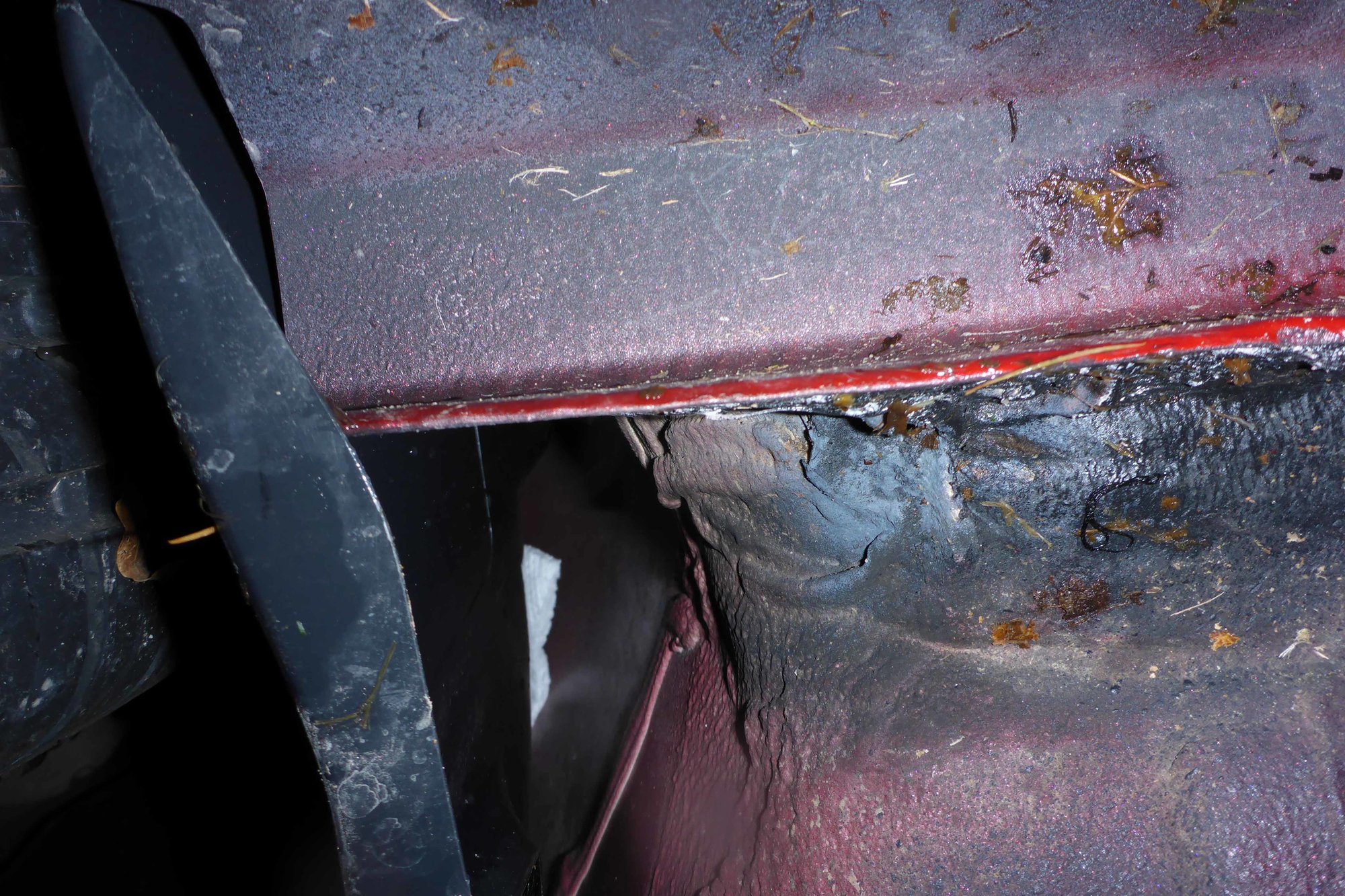

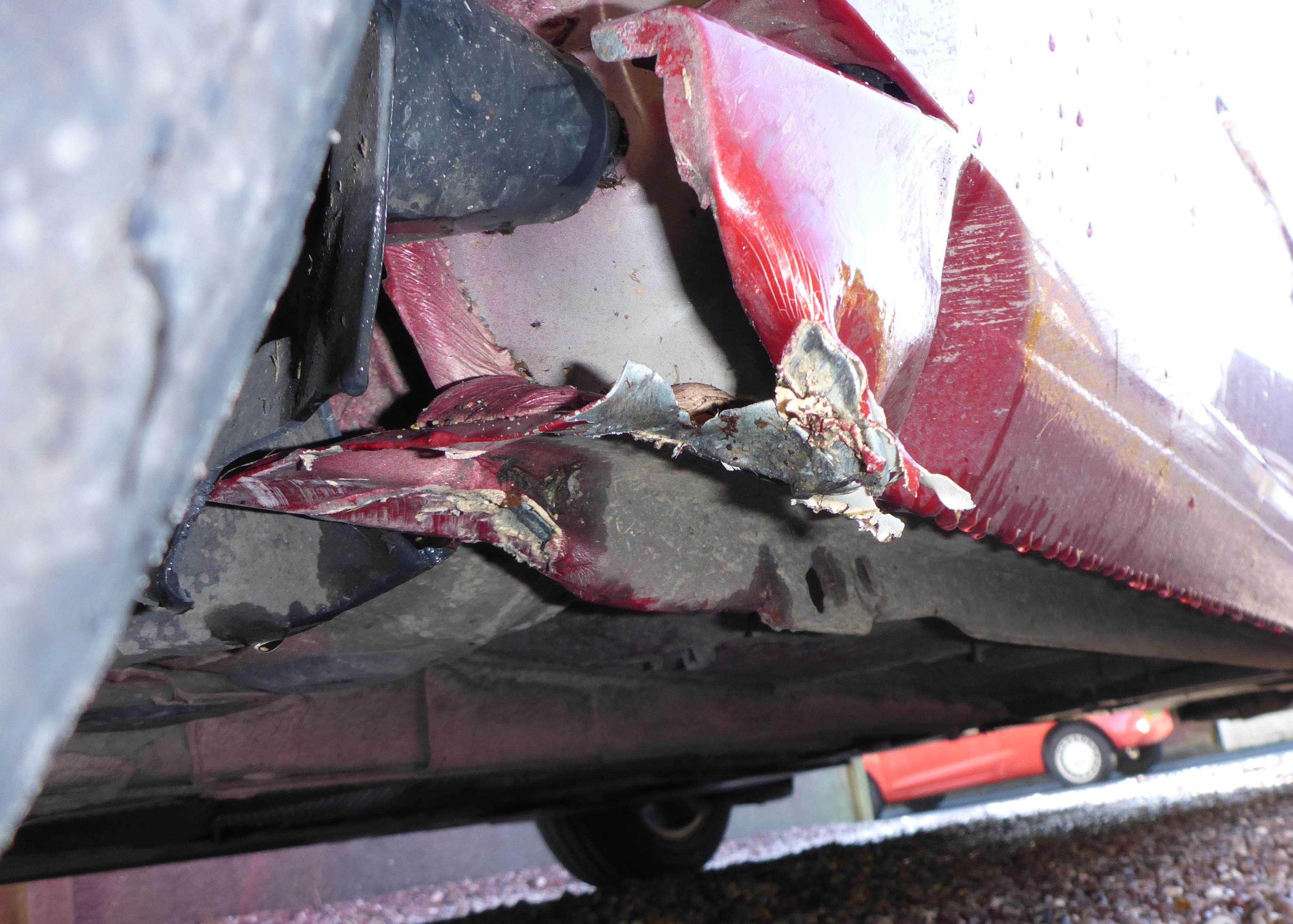

    They have definately done some welding. Front of sill was beyond repair. Its a complete single unit on these cars, but they have obviously put a new section in as no one could restore the tearing (not properly anyway) done. I've uploaded a photo of the damage after the curb jumped out in front of me :)
    The part that looks like a section on the frontal photo is actually a servere crease, not a gap. Its a one piece sill from front to rear.
    I've also uploaded a a before repair and after repair photo. Not easy to tell which one is before and after, especialy if you look at the distorted seams and the smoke / carbon on the after pic. smash comp.jpg before.jpg after.jpg

    Yeah I get you now, that "black carbon" looks like a spray on rubberised stone chip spray to be honest. 2k FFS!! The annoying thing is we are all paying for this in our insurance premium.

    By the way, the carbon / smoke I refer to can be seen as a greyish residue near the rubber tipped raised jacking point that look like a hump, to right of the photograph closest to the repair proper. Its also visible on the floor pan above the stone chip you mention between the 2 seat bolts. Its definately carbon / smoke as it rubs off.

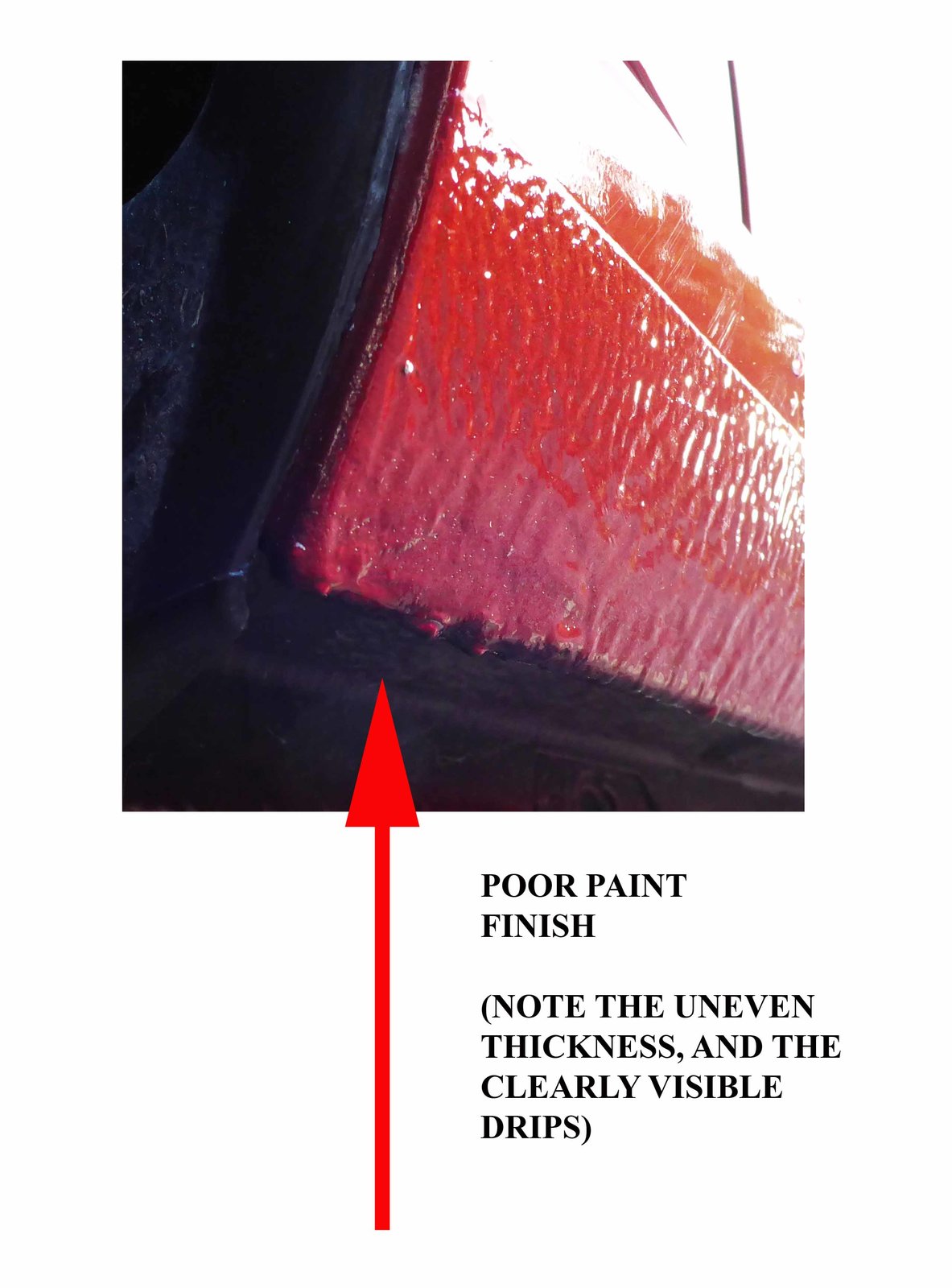

    Me? well, I'm too long in the tooth and been bitten too many times to accept anything on face value. You should have seen the face on the delivery driver when i pulled out a mat and a torch and crawled under the car before I even looked at his paperwork. Needless to say I didnt sign that job off. paint comp.jpg
    I will make this photo the last one as if I keep going this thread could become a monster, but this is what the paint job on the other side of the sill looked like (done to a 3 year old car remember, not a £50 scrapper).
