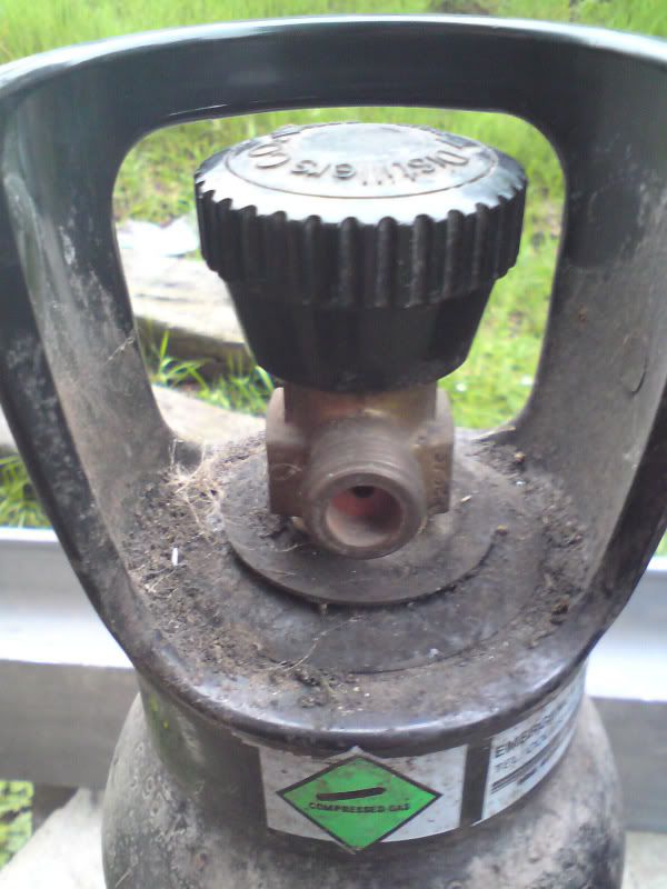

Well ive just got a clarke 160Tm and my brother has just dropped off two Co2 bottles. Its the ones the pubs use and are only about 1 foot in height.
This is the connection i have, Was just wondering what regulators will fit onto these?
No. The regulator supplied with the 160TM is for Argonmix, to give the very best performance...you won't get it with CO2. It's also unique to that model so to convert to CO2 you will need a totally different regulator + a conversion pipe kit.
