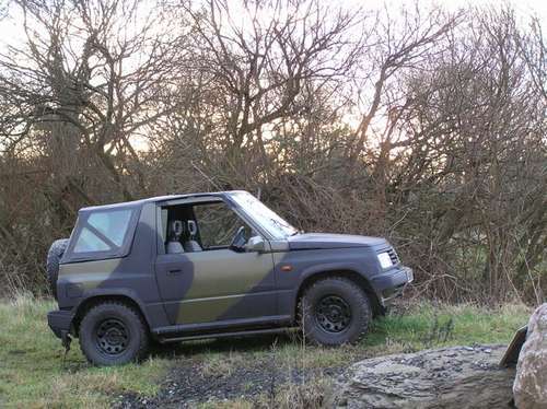

Buy a neoprene roller for texhaloid it eats foam rollers in short order. Prefer a brush with itIf you use Tekaloid its high gloss so wouldn't need polishing
https://www.smithandallan.com/produ...oid-318-single-pack-coach-enamel-all-colours/
Some info here
https://coachpainting.uk/index.html
Plenty of coach painting videos on youtube
Also needs a week or so to fully dry depending on tempsBuy a neoprene roller for texhaloid it eats foam rollers in short order. Prefer a brush with it
Hi , the car has been painted with a Tekaloid green , it needs cutting back , flattened repainting , try as I might I still end up with nibs and dust specs , I will check out the rustoleum paint,If you use Tekaloid its high gloss so wouldn't need polishing
Some info here
The only down side is it takes so long to go off, best done inside with a bit of water on the floor to keep the dust down, If you call Smith and Allen they should also sell a quicker drying gloss which may solve the issue.Hi , the car has been painted with a Tekaloid green , it needs cutting back , flattened repainting , try as I might I still end up with nibs and dust specs , I will check out the rustoleum paint,
