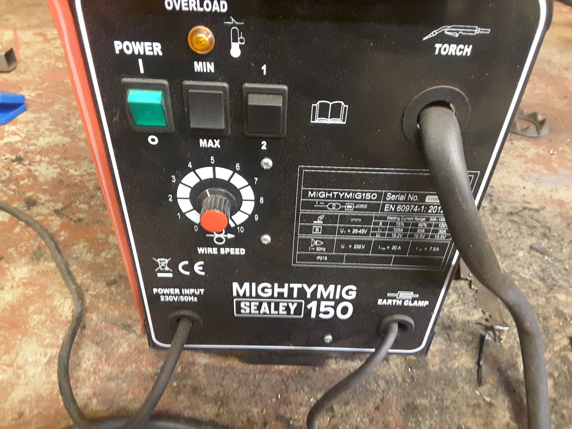

    Evening all.
    New to the forum.
    Need some help with my set up.
    For some background, I have done a level 1 welding course and have started level 2.
    I am doing this to weld up an old car.
    So, I am trying to weld two pieces of 1mm steel.
    I have ground each edge clean.
    I have ground clean a site for the earth.
    I am using the settings in the attached photo, with gas.
    Obviously I am doing something amiss, but just can't see what's up.
    I am trying to follow the puddle as I have with the equipment at college. Obviously much bigger sets than my home one.
    Once cooled, I can just pull the two pieces apart.
    Any suggestions would be gratefully received.
    Thanks

    Hi try switch to max 2 . Give it more power

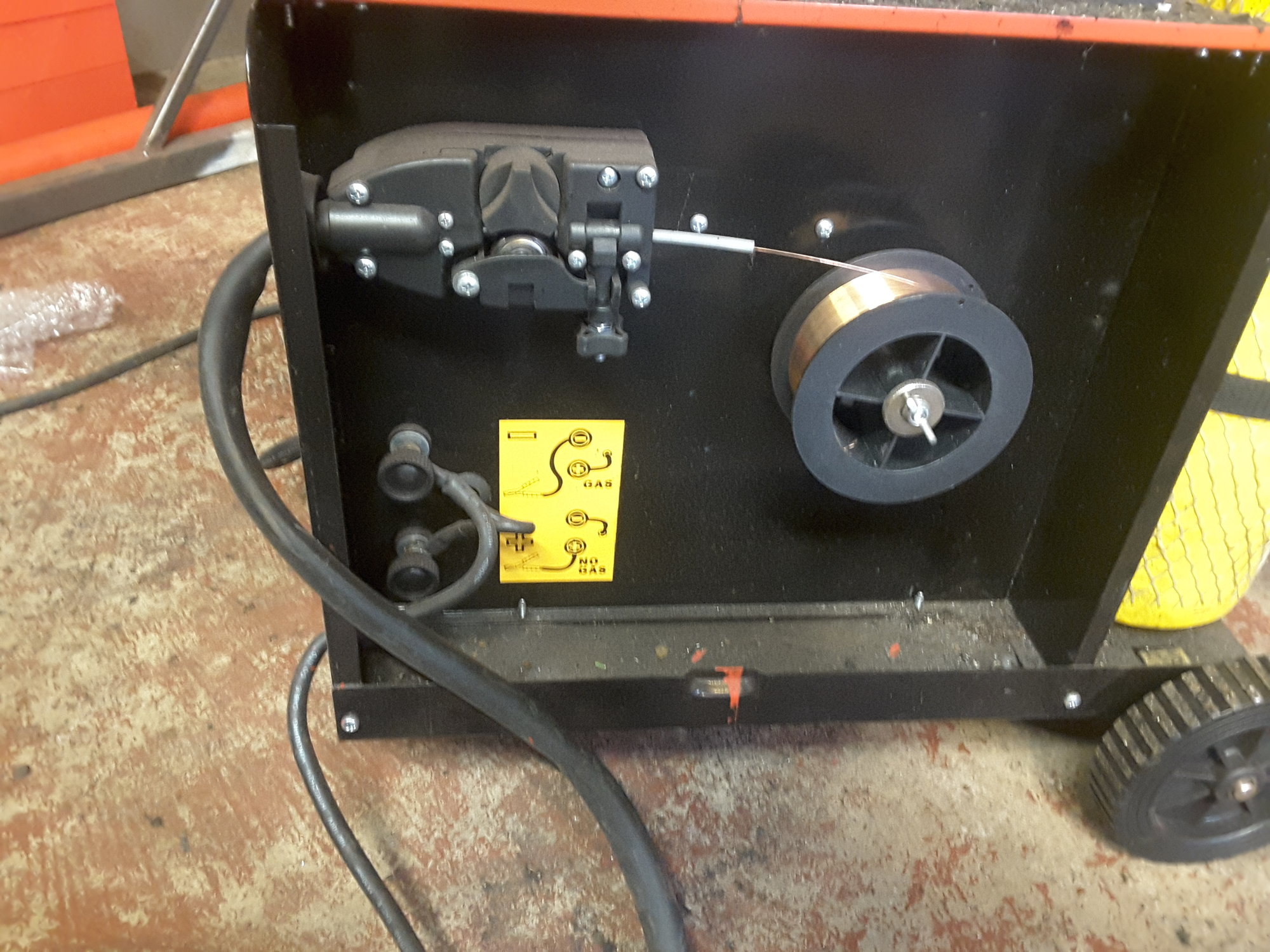

    No, it's gas set up at the moment with .6mm wire

    The jumper settings are correct for solid wire with gas ( torch positive ).
    On a 150 amp welder, the MIN,2 setting should be more than enough power for 1mm sheet. In fact, if the metal was rusty and thinned by grinding, MIN,1 may be too much.
    Have you fitted a 0.6mm tip to the torch, and moved the wirefeed roller to use the 0.6mm groove?
    I would suggest laying some straight beads on clean 1mm sheet, then doing a lap or butt joint, and posting pictures on here for comment and advice.

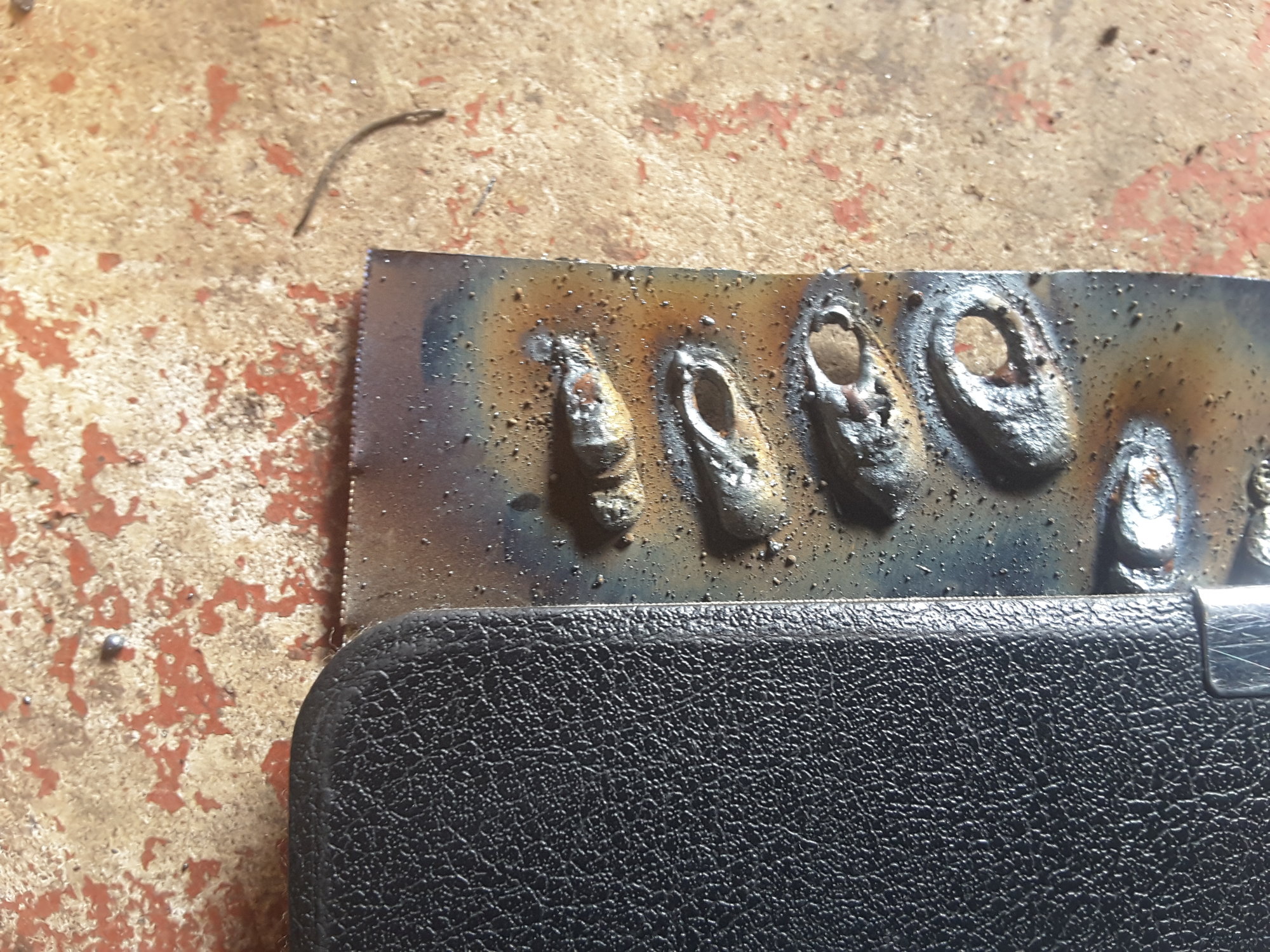

    I have run some short welds on a clean piece of 1mm steel.
    More power seems to blast it away!
    In picture left is min power, right is max.

    It looks like you don't have much gas coverage
