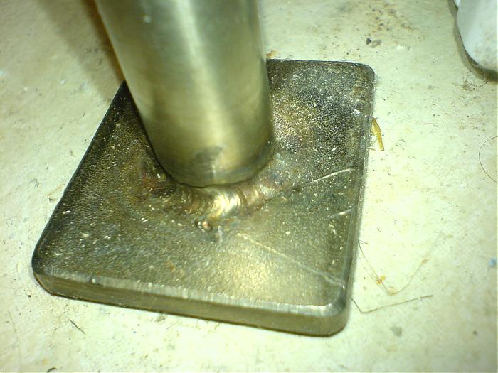

Something like this, but I did this with TIG, 13mm bar reduced to 10mm at the end, fitted into a 10mm hole in the plate, welded at the bottom and the top.
