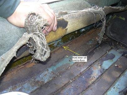

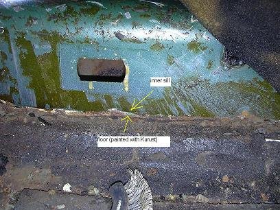

outer sills (have patches of welding + putty)
inner sills (detached from joining to the floorpan on the inside)
