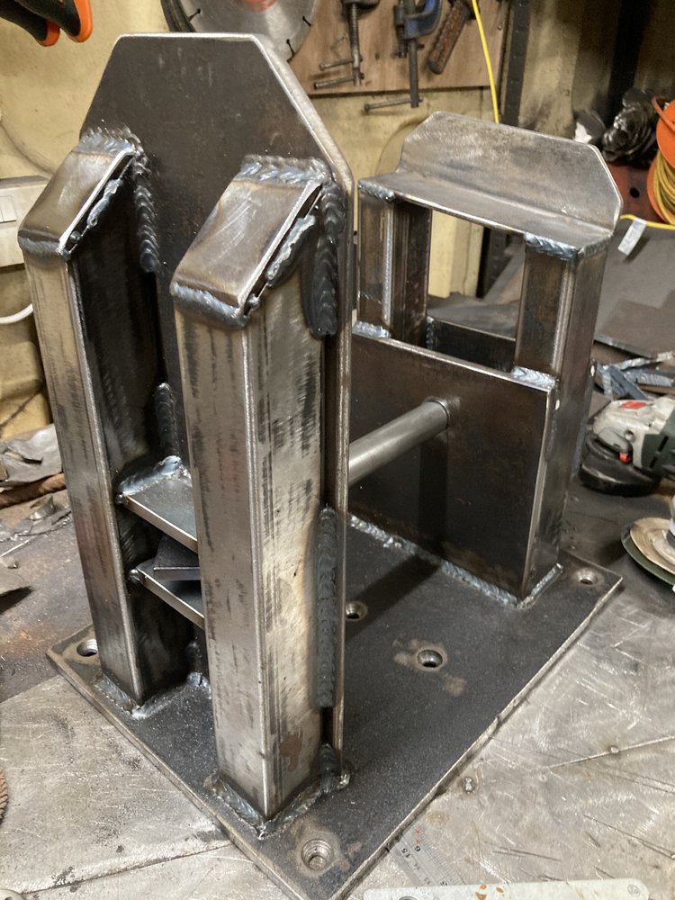

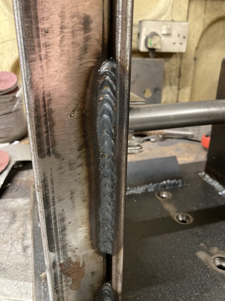

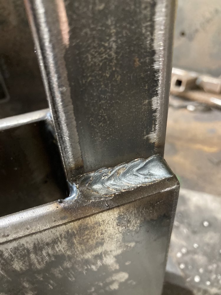

So i am self tort at welding.
i make bits an bobs but i can only weld nice(to me) downhill.
on the flat it looks crap.
Got a minarcmig kempi 200.
I just can’t sort it
I just stand stuff on its side so i can weld downhill. Not the best i know
View attachment 291888 View attachment 291889 View attachment 291890
Its 10mm.I've got a Kemppi 200 evo as well...it welds lovely....I use 0.8mm wire with argon mix.
One thing I notice in your pic...that steel looks pretty thick? My Kemppi is maxed out at 5mm steel I think.
Its a bike lock, back wheel of the ktm goes in so someone struggles to nick it.Doesn’t look too bad although I know what the others say. Btw what is that ‘thing’ you welded?
up the power and move fasterThanks for your answers.
My point is i cannot weld flat. Love my kemmpi but will keep trying and trying.
Thats pretty chunky for a 200A MIG welder I reckon...I've done 8mm with mine with a "V" prep to the joint....think I did a couple of quick passes (wasn't anything critical).Its 10mm.
try it flat next time 10mm you will be maxing that kempi out for sureLike i say i mess around making bits an bobs.
i aint no expert at all.
You beat me to that idea!! I had similar one for the front wheel and forks where it was two large sides. Well done!Its a bike lock, back wheel of the ktm goes in so someone struggles to nick it.
