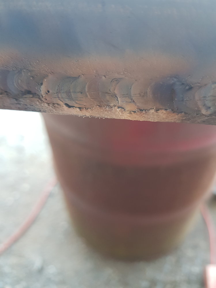

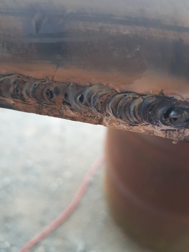

its really tricky to get all the galv off zinc is sort of blue ish and the steel slightly yellow if you use abrasive it still scores some of the zinc in to the surface of the steel, there may even be zink, millscale or rust on the back which will boil through the weld pool. Zinc wrecks your tungsten and difuser too.
