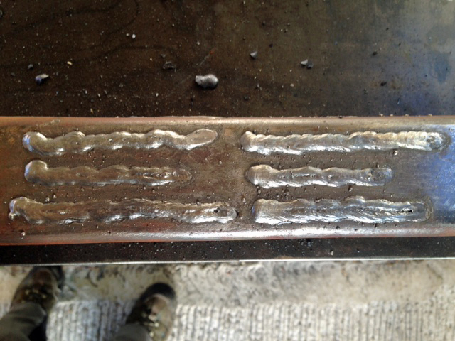

    Hi, I bought an R-Tech MIG 4 weeks ago & now that I have a space to work, + a bench, and a 16A socket, I thought i'd start with the MMA welding.
    Watched the tutorials on this forum, which were great. Then practiced for a few hours using 3mm to 10mm steel, using 2.5, 3.2 & 4 rods, all 6013 Siffrode. Made many notes of what amps worked best. Below is a 50mm x 4mm box using 2.5 rods. Just one decent run managed, pretty obvious which one ? Intend doing LOTS more practice !
    So, my question is, I am making a vice stand and need to weld 100mm dia x 4mm pipe to 10mm thick steel base plates. I think I should use 3.2 rods at around 130A, but when I tried some practice runs, I'm pretty sure I was close to burning through the 4mm pipe.
    Advise / Recommendations please ?

    130amp and a 3.2mm rod is not too far away from were you need to be, its difficult to say for sure with different plants and different supply and rods. Were I suspect the issue might be is were your putting the main part of the heat, when going thick to thin you "bias" towards the thick 4mm is not particularly thin and 10mm not all that thick so concentrate on angle and just a little manipulation, keeping a tight arc. Settings wise a 3.2 is going to burn 100-140 amps (low end and top end figures) 120-130 is most common for what your doing.
    Sorry a cant tell a lot about your settings from those wavy bead pictures, joints for real do tend to take more learning than a couple of hours on a bead pad though.
    Your on the correct rod for the job but you will find it easier to build straight stringer beads at present than try any great amount of weave at present

    Pretty much what Kent has said, 3.2mm rods, I'd think perhaps nearer 120 amps but rods really do vary - as do welders, so it's just a ballpark figure.
    It's mainly about angling it towards the thicker plate.
    It maybe wouldn't hurt to do some more practice first though, welding pipe takes more than straight runs as the angles change.
    I suggest a little practice with similar joints first but with flat plate, then progress to the 'round' stuff.

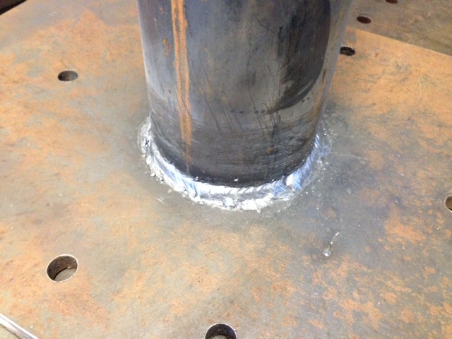

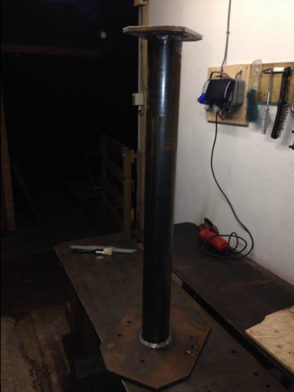

    Thanks for all the excellent advice ……. I have now started a weld bead pad, but I am also too impatient to get on and make stuff ! i.e. A bench grinder stand. (I have already made a vice stand)
    I think that I have made a better job of welding the pipe to the 10mm plate today than my previous attempts, by;
    1.) 1st running a 3.2mm rod around the pipe, with the penetration mainly into the plate, (setting 130A) …. then
    2.) laid the pipe horizontal and run a 2.5mm rod around the pipe with the penetration mainly into the pipe (setting 90A).
    I dare say, that, for a structurally sound job, the experts will say there should be a 3rd weld run round, sort of 'filleting' the other 2 welds.
    I think I got amperage settings and the speed OK, but I know that I did sometimes get the angle wrong clearly evidenced by splatter !

    Looks like a decent job Steve, strong enough for purpose. If you have a lot of these types of welds a revolving table is a dream tool, some would even say using one is cheating! Keep up the good work :welder:
