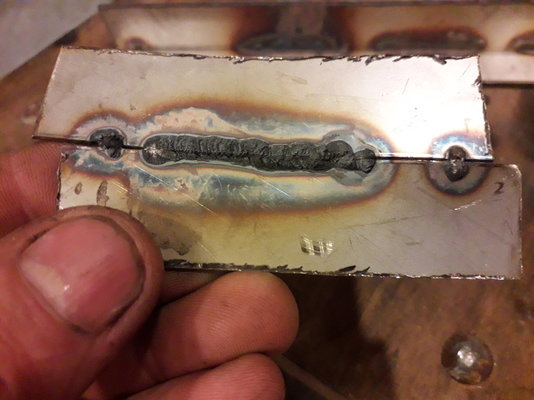

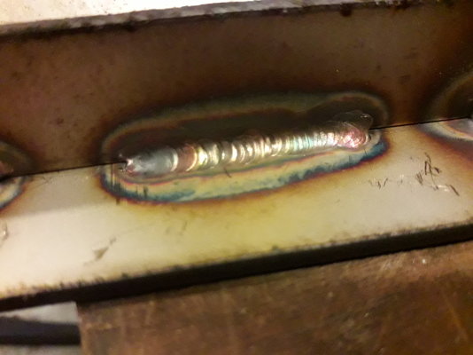

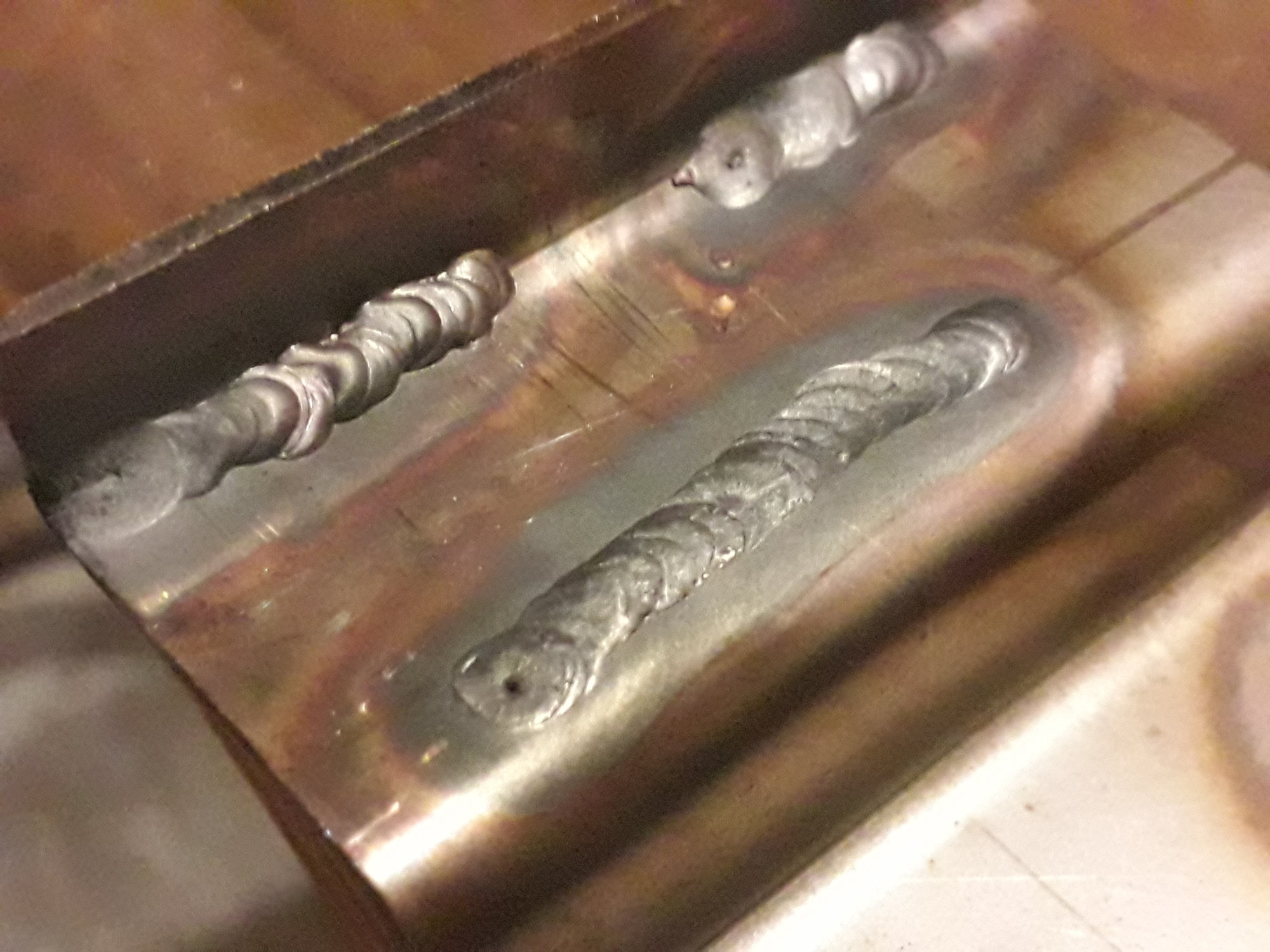

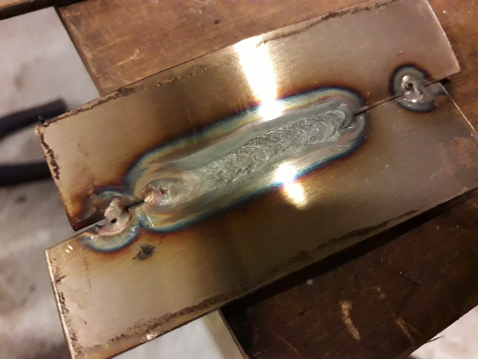

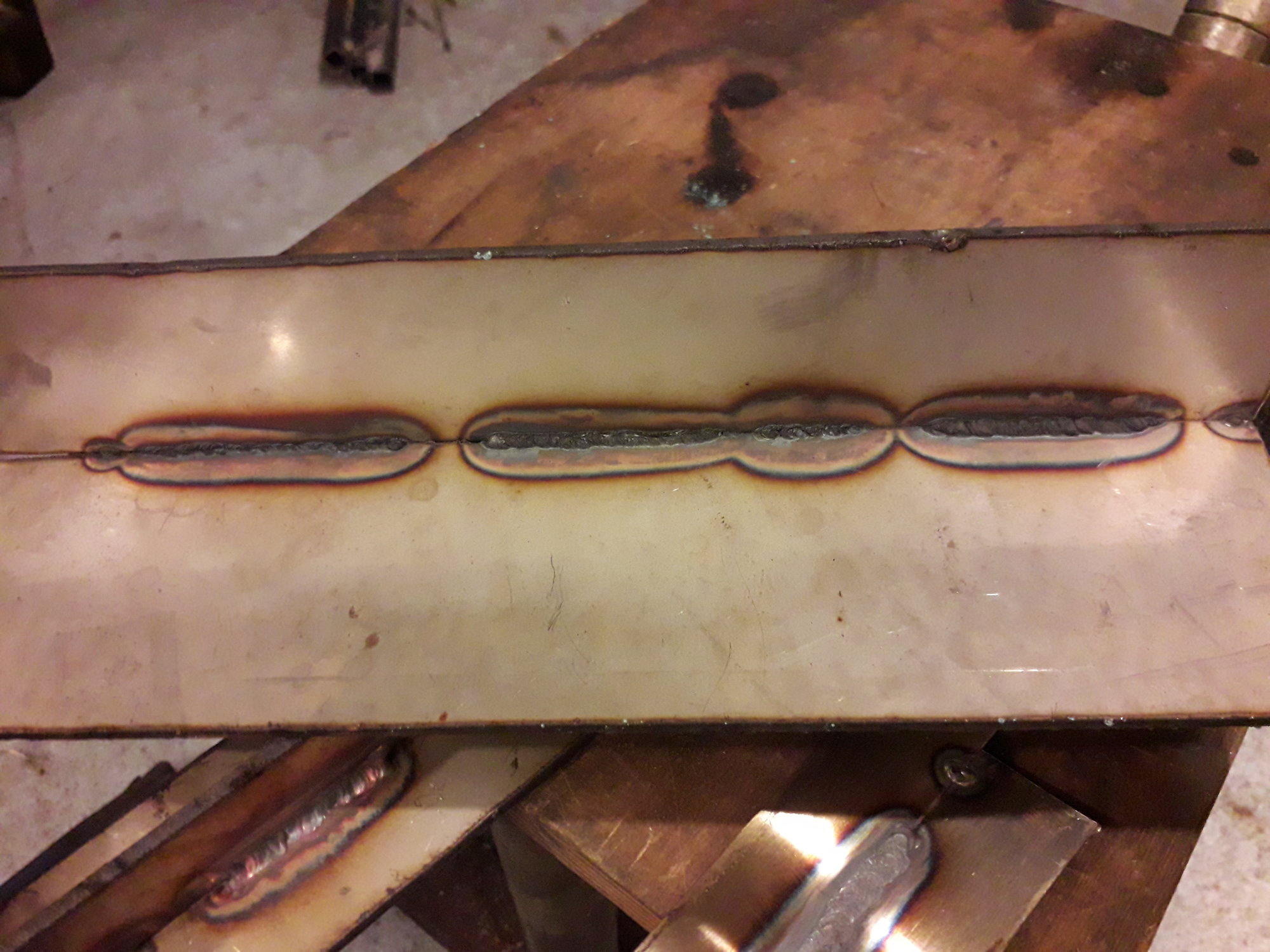

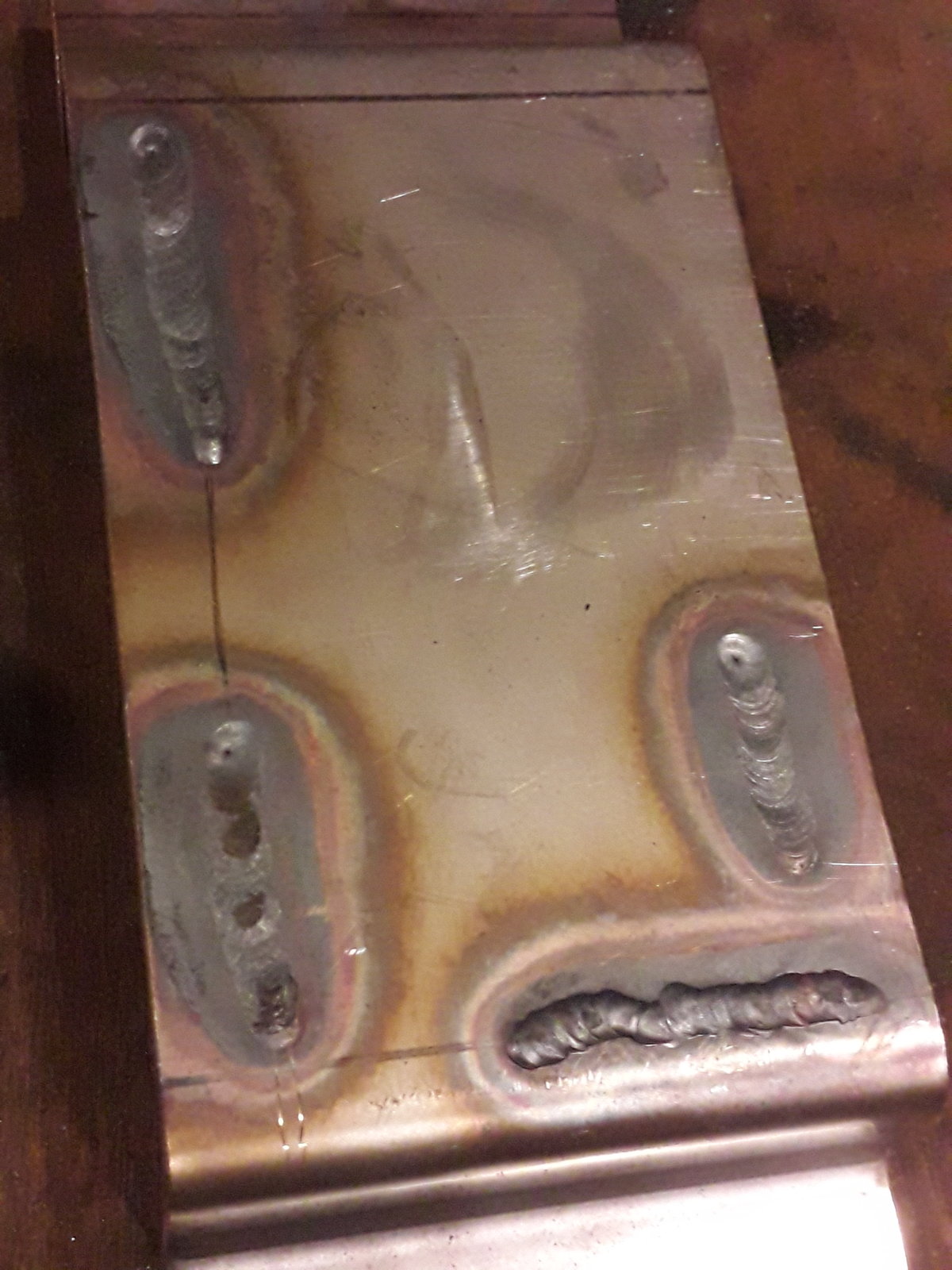

So had a bit more time in the garage this evening. Trying some outside and fillet joints on some (2mm ish) stainless.

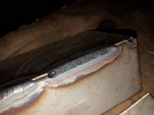

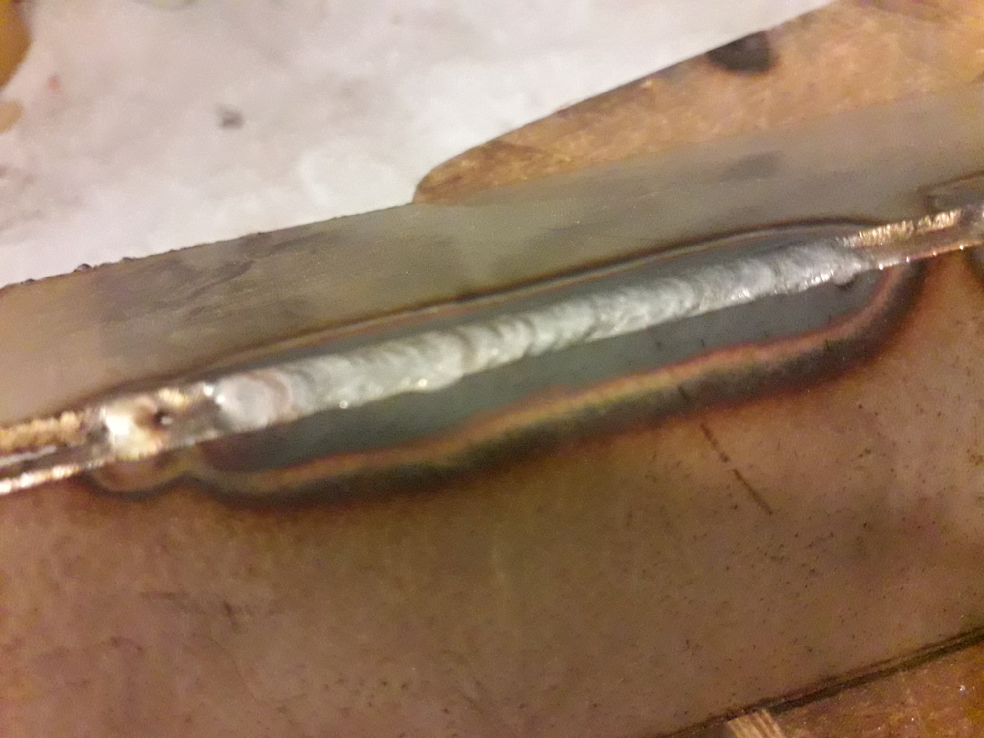

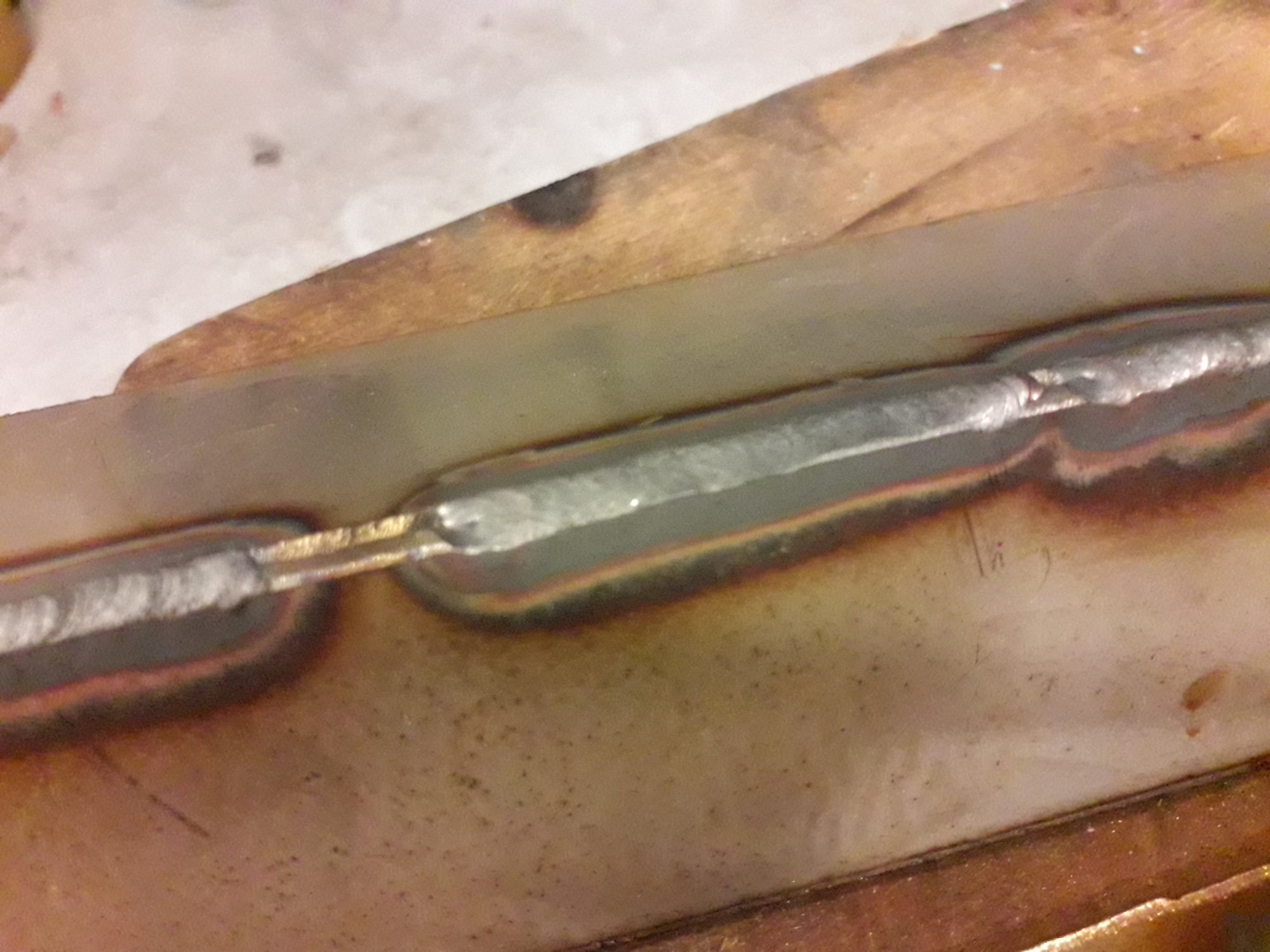

I think I'm welding too hot, hence the undercut on the outside joints. (Started at 55amps dropped to 50 then to 40 on the outside. Fillets were both at 60amps)

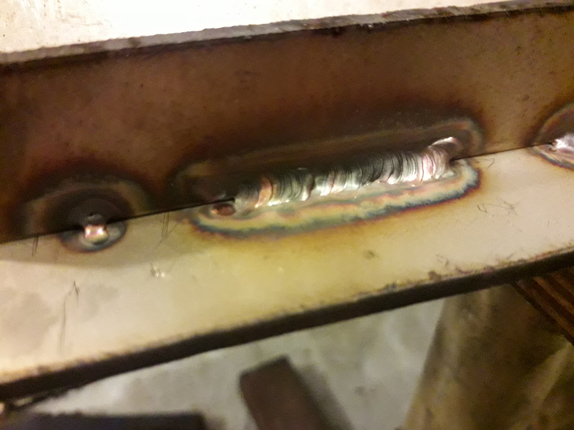

Butt joint is thinner gauge and welded at 42amps.
